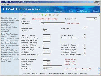

From Inventory Management (G41), choose Inventory Master/Transactions
From Inventory Master/Transactions (G4111), choose Item Branch/Plant Information
You can define the method that the system uses when creating a commitment. These methods are by location, lot number, or lot expiration date.
On Item Branch/Plant Information
Figure 7-1 Item Branch/Plant Information screen
Complete the Commitment Method field.

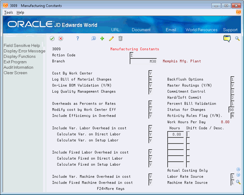

To define the commitment control and type of commitment
From Shop Floor Management (G31), choose Shop Floor Control Setup

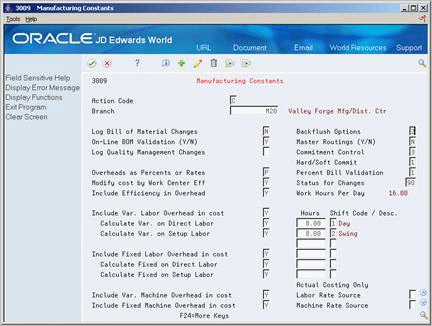

From Shop Floor Control Setup (G3141), choose Manufacturing Constants
You can define the commitment control method and type of commitment for the work order. The control determines how the system commits inventory to a work order, and limits the inventory location to which commitments are made. The type specifies whether the commitment is soft, hard, or starts out soft and later becomes hard.
On Manufacturing Constants
Figure 7-2 Manufacturing Constants screen
Complete the following fields:
| Field | Explanation |
| Commitment Control | Determines how the system commits inventory to a work order, and limits the inventory location to which commitments are made. The system activates this field only when you create hard commitments. Valid codes are:
When you set the Commitment Method field in the Item Branch/Plant table to 2 or 3 (lot number or expiration date control), you must set this field to 3. |
| Hard/Soft Commit | Determines how the Shop Floor Control system commits inventory. Valid codes are:
For World: When the hard/soft commit option is set to 2 or 3, any line item in the parts list may be hard committed prior to printing or relieving the inventory. Note: When you set the Commitment Method field in the Branch/Plant Constants form to 2 or 3, you must use 1 or 2 for this field because a hard commitment must be performed. |

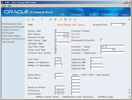

To define the location at the work center
From Product Data Management (G30), choose Daily PDM Discrete
From Daily PDM Discrete (G3011), choose Enter/Change Work Center
Figure 7-3 Enter/Change Work Center screen
Work Center
Location - Issue

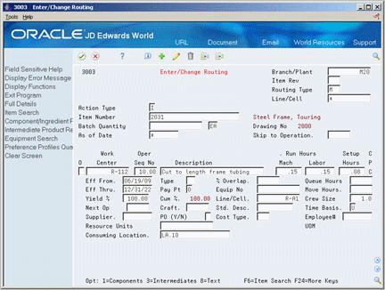

To define the work center and location in the items routing
As an alternative to defining routing information manually, you can use the Routing Master Revisions - Z File program (P3003Z) to import an extensive amount of process data into your system. See Appendix D, "Import Mass Data into Manufacturing Systems" for more information.
From Daily PDM Discrete (G3011), choose Enter/Change Routing
On Enter/Change Routing
Review the following field:
Work Center
Press F4 to view the Full Details
Figure 7-5 Enter/Change Routing screen (Details area)
Note: Consuming location should match the Location Issue on the Work Center. |

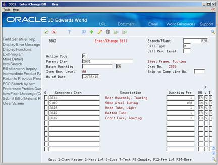

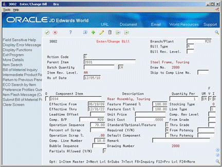

To define the branch and parent item for the bill of material
From Daily PDM Discrete (G3011), choose Enter/Change Bill
Branch/Plant
Parent Item
Access the detail area.
Complete the following field:
Operation Sequence
Choose BOM Component Master Text.
Create a separate generic text entry for a component item of the parent item.
This window enables you to provide more information and specific instructions per component. You can also use the User Information and Text Model Selection windows to view user and date updates, as well as model selections.
To define how the system commits inventory during backflush
Figure 7-8 Manufacturing Constants screen
Backflush Options
| Backflush Options | Determines how the system performs commitment and release of inventory during the backflush process. Valid codes are:

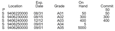

Grade and potency controlled items must be lot controlled. When the system creates commitments for grade and potency controlled items, it moves the grade and potency range to the parts list. Only those lots within the range are eligible for commitments. The system makes the commitments in date sequence.
For example:
Figure 7-9 Parts List with Grade and Potency Controlled Items
In the above example, the work order quantity required is 800, and the grade range is A01-A03.
The system commits the quantities using the primary unit of measure. If all of the commitments cannot be made against specified lots in the range, the system commits the remainder to the primary location at standard grade or potency.

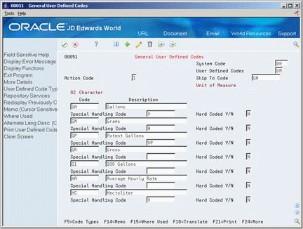

Creating commitments for potent units consists of:
Defining potent units
Setting up a unit of measure conversion

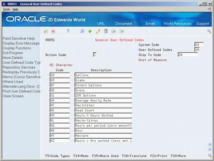

From General Systems (G00), choose General User Defined Codes
Figure 7-11 General User Defined Codes screen
Figure 7-12 General User Defined Codes screen (Detail area)
Special Handling Code
| Special Handling Code | A code that indicates special processing requirements for certain user defined code values. The particular value you enter in this field is unique for each user defined code record type.
The system uses the special handling code in many ways. For example, special handling codes defined for Language Preference specify if the language is double-byte or if the language does not have uppercase characters. Programming is required to activate this field. Form-specific information If a "P" is in the second position, the system identifies that unit of measure as a potent unit of measure. |

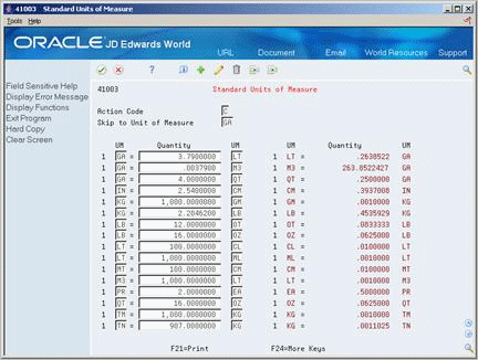

To set up a unit of measure conversion
From Inventory System Setup (G4141), choose Standard Units of Measure
You set up a unit of measure conversion for potent units so that the system can:
Convert potent units of measure to physical units of measure
Convert physical units of measure to potent units of measure
On Standard Units of Measure
Figure 7-13 Standard Units of Measure screen
Unit of Measure
Quantity
Unit of Measure
