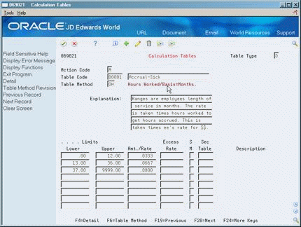

You set up calculation tables to define the parameters for calculating DBAs that are based on variable values. You define valid ranges and amounts that are a function of certain method codes.
Calculation tables contain user defined information to more completely define the standard DBA methods of calculation. Calculation tables provide the following features:
User defined tables
Calculations based on values that vary from employee to employee
When you define a calculation table, you must first determine what the calculation is based on, for example:
Age
Annual salary
Months of service
Hours worked in a pay period
After you have defined the calculation table, you must determine the appropriate method of calculation. The calculation tables only work with certain method of calculation codes. The method of calculation indicates what the ranges in the table represent, such as age ranges or salary ranges. The method of calculation codes include the following:

Complete the following fields:
Table Type
Table Code
Table Method
Explanation
To define the parameters of the table, complete the following fields:
Lower Limit
Upper Limit
Amount or Rate
Complete the following optional fields:
Excess Rate
Secondary Calculation Method (SM)
Secondary Calculation Table
Repeat steps 2 and 3 as often as necessary to define all the parameters needed for the table.

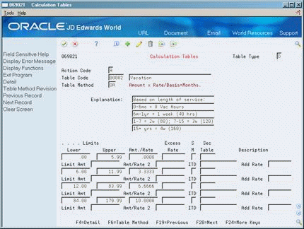

To set multiple Inception-To-Date limits
You can associate multiple inception-to-date limits with a single accrual. These limits override the ITD limit in the F19 window of the accrual.
On Calculation Tables
Select Detail from the Navigation bar to open the fold.
Enter ITD limit(s) for each range in the calculation table.
Press Enter.

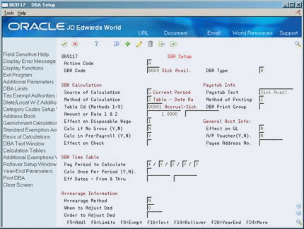

After you set up your calculation tables, attach the table to the DBA by entering the table code on DBA Setup.
To attach calculation tables to DBAs
On DBA Setup
Method of Calculation
Table Code
Complete the remaining steps for setting up a DBA.

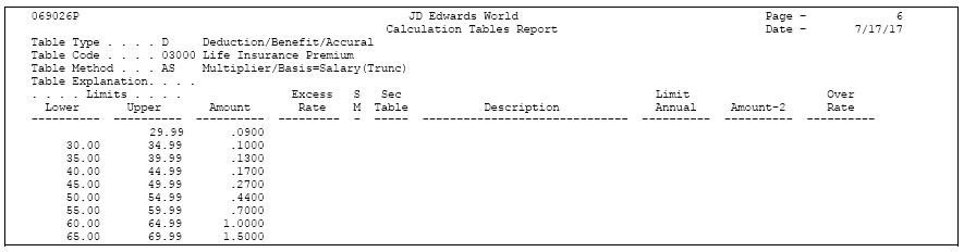

The Calculation Tables Report provides a listing of the calculation tables by table code. Review this report to verify that the information you entered on each calculation table is accurate.

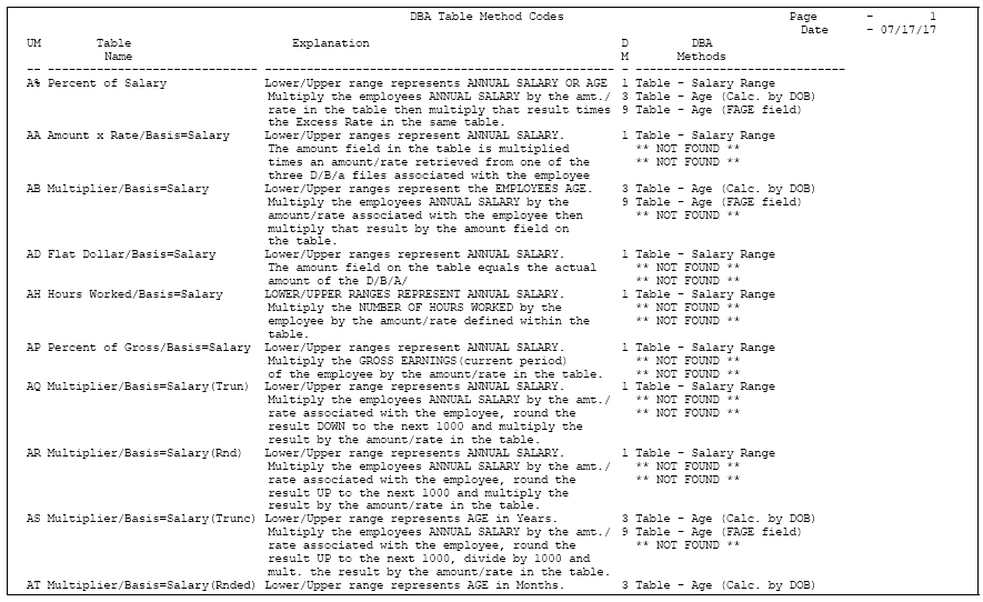

From Pay/Deductions/Benefits (G0742), choose Table Method Explanations
The DBA Table Method Codes report provides a listing of each table method code followed by the description of the table method. This menu selection uses World Writer to print the report.
