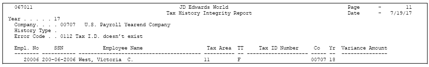

Use the Tax History Integrity Report to identify errors in your Taxation Summary History (F06136) table. You use the information in this table to produce governmental, year-end forms for employees. When you keep this table free of errors, you simplify the year-end processing tasks.
27.2.1 Before You Begin
  • Enter the appropriate tax earnings limitations and rates in the processing options. Without these figures, the system cannot identify certain errors.
Figure 27-1 Tax History Integrity Report
Description of Figure 27-1 follows
Description of ''Figure 27-1 Tax History Integrity Report''

27.2.4 Reviewing Error Codes for the Taxation History Integrity Report

0112 - Tax ID doesn't exist The corporate tax ID on the record does not exist in the Corporate Tax ID table (F069086).
Manually add the corporate tax ID on the Corporate Tax IDs form located on the Taxes and Insurance menu (G0744). Then, run the Tax History Integrity Report in update mode.
0113 - Tax ID doesn't match The corporate tax ID on the record does not match the corporate tax ID in the Corporate Tax ID table (F069086).
Verify that the tax ID on the Corporate Tax IDs form located on the Taxes and Insurance menu (G0744) is correct. This ID might have changed, but history records exist with the prior number. If the tax ID is incorrect, change it, then run the Tax History Integrity Report in update mode.

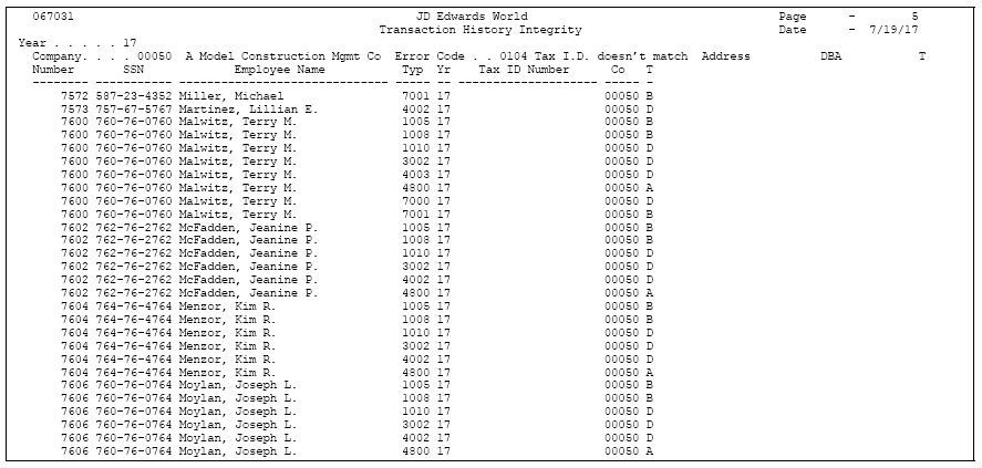

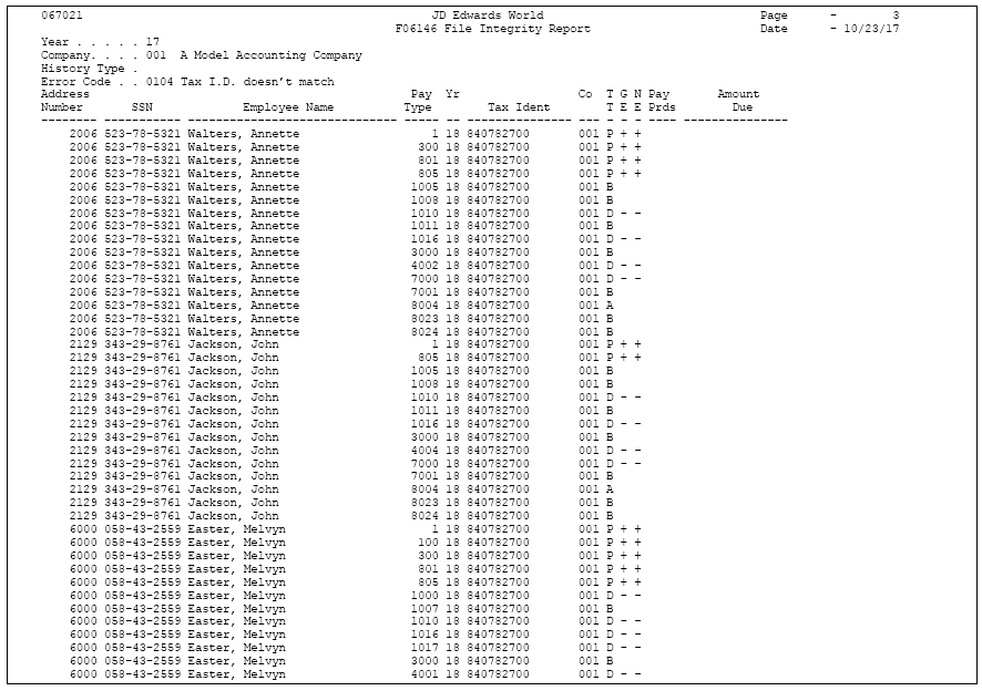

Use the PDBA Integrity Report to identify errors in your Payroll Month PDBAs Summary History table (F06146). This table contains the adjustment amounts that you might need to add to taxable wages or report in other detail boxes on the year-end forms. These amounts might include 401(k) contributions, moving expenses, group term life insurance premiums, and so on. When you keep this table free of errors, you simplify the year-end processing tasks.
Figure 27-2 File Integrity Report
Description of Figure 27-2 follows
Description of ''Figure 27-2 File Integrity Report''

27.3.3 Reviewing Error Codes for PDBA History Integrity
The following list briefly explains the error codes (07/IT) that might show on the PDBA Integrity report.
Code Description
0101 - Employee Number is invalid The employee number does not exist in the Employee Master table (F060116).
Manually add the employee back into the master file and rerun the Transaction History Integrity Report.
0102 - Pay, Deduction or Benefit Type doesn't exist The Pay, Deduction, Benefit, or Accrual number does not exist in the Transaction Parameter table (F069116).

Use the DBA Integrity Report to identify errors in your Calendar Month DBA Summary History table (F06145). When you keep this table free of errors, you simplify the year-end processing tasks.
Figure 27-3 Transaction History Integrity report
Description of Figure 27-3 follows
Description of ''Figure 27-3 Transaction History Integrity report''
27.4.1 Data Selection for Transaction History Integrity Report
Specify the last two digits of the current year in the data selection.
27.4.2 Data Sequence for Transaction History Integrity Report
Do not change the data sequence of the report.
27.4.3 Reviewing Error Codes for DBA History Integrity
The following list briefly explains the error codes that might print on the DBA Integrity report. These codes are defined in user defined codes table 07/ID.
Code Description
0101 - Employee Number doesn't exist The employee number does not exist in the Employee Master table (F060116).
Manually add the employee back into the master table and run the Calendar Month DBA Integrity Report in update mode.
0102 - DBA Type doesn't exist The Deduction, Benefit, or Accrual number does not exist in the Transaction Parameter table (F069116).
Manually add the DBA number using the DBA Setup form located on the Pay/Deductions/Benefits Setup menu (G0742). Then, run the Calendar Month DBA Integrity Report in update mode.
0103 - Tax ID doesn't exist The corporate tax ID on the record does not exist in the Corporate Tax ID table (F069086).
Manually add the corporate tax ID on the Corporate Tax IDs form located on the Taxes and Insurance menu (G0744). Then, run the Calendar Month DBA Integrity Report in update mode.
0104 - Tax ID doesn't match The corporate tax ID on the record does not match the corporate tax ID in the Corporate Tax ID table (F069086).
Verify that the tax ID on the corporate tax IDs screen located on the Taxes and Insurance menu (G0744) is correct. If not, correct it and run the Calendar Month DBA Integrity Report in update mode.
Note: W-2 forms will not print correctly if the Federal A Corporate Tax ID contains punctuation or spaces.
