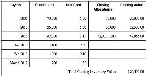

Figure A-16 March Total Closing Inventory Value (1 of 2)
Description of Figure A-16 follows
Description of "Figure A-16 March Total Closing Inventory Value (1 of 2)"
Figure A-17 March Total Closing Inventory Value (2 of 2)
Description of Figure A-17 follows
Description of "Figure A-17 March Total Closing Inventory Value (2 of 2)"
The system uses the same formulas and makes the calculations based on the February transactions.
During March, the company purchased a total of 700 units for 925.00. They sold 2500 units. The system uses the following formula to determine the closing inventory:
Opening inventory (147,000) + purchases (1400 + 1500 + 700) - sales (900 + 500 + 2500) = closing inventory (146,700)
The accumulation/depletion from the beginning of the year is:
Closing inventory (146,700) - opening inventory (147,000) = <300>
The system allocates the closing inventory as follows:
Figure A-18 March Closing Inventory Allocation
Description of Figure A-18 follows
Description of "Figure A-18 March Closing Inventory Allocation"
The system calculates the March COGS:
Opening inventory value (170,800.00) + purchases (2800.00 +3150.00 + 925.00) - closing inventory value (170,455.00) = COGS (7220.00)
The system calculates the March average cost:
Total purchase amount (<3450.00>) / total purchase quantity (<300>) = average cost (1.15)
The system calculates the LIFO adjustment:
Average cost of the accumulation/depletion(345 / 300 = 1.15) - current period's average cost (925 / 700 = 1.32) = accumulation/depletion cost (<.17>)
Accumulation/depletion (300) * accumulation/depletion cost (<0.17>) = LIFO accumulation/depletion adjustment (<51.43>)
See the matrix indicating how to credit or debit accumulation/depletion to determine how to make the income statement and balance sheet entries for the LIFO adjustment.
The depletion in March reduced the inventory of a prior layer. April's opening balance will be the same as all of the other months due to the fact that the prior period entries are reversed.
The remaining months follow the same calculations. In December, the last period in the year, no LIFO adjustment entries are made to the accounts.
