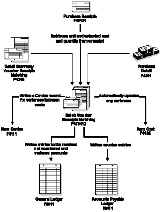

Frequently, you do not know the price of the inventory when you purchase it. Typically, you enter an average price or average formula price when you receive the inventory. At a later date, you update the system information with the actual price or formula when it is known. This process is also called "recosting."
Landed costs are costs in excess of the purchase price of an item. You assign each item a landed cost or landed cost rule. You need this information to accurately reflect the value of your stock.
You enter the cost of an item during purchase order entry. If you do not enter a different cost or adjust the cost at any other point, the system retrieves this cost to determine the cost of an item.
When you receive an invoice for purchased items, use the voucher matching programs to match invoices either in detail (sales line by sales line) or in summary (match the total of all sales lines to the total amount due to the supplier). At this point, you can change the cost of an item if it is different from what the system retrieves. You can also revise paid vouchers by using the Summary Voucher Matching program. The voucher matching programs:
Update the general ledger accounts for any variances
Keep the general ledger and inventory in balance
Update the Item Cost table (F4105) with the last in cost
Write records to the average cost history table to be extracted later by the batch update program
You must run the batch Voucher Receipts Matching subsystem program to process any variances on the invoice and landed costs.
The following graphic illustrates how the subsystem integrates with other systems for the recosting process.

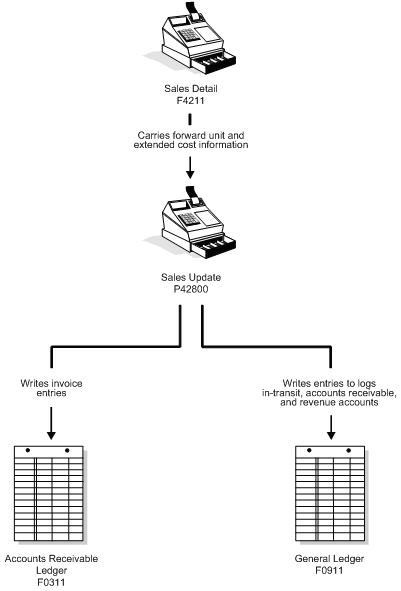

The following steps outline the process when you loan product to a partner:
You enter a sales order to record the loan.
The system retrieves the item cost from the Item Cost table (F4105) and assigns the selling price based on the sales costing method defined in the Inventory Management system.
Generally, you reduce inventory during the load confirm process when you actually remove the item from its location in your inventory. Because this process reduces inventory, it writes a record to the Cardex using the item and cost information from the sales order.
The Sales Update program updates the general ledger accounts for the inventory reduction.
When you loan product to another company, the system reduces the on-hand inventory quantity. Because you anticipate the borrowing company to return the loan and you still own the inventory, you will want to include this quantity in your valuation. Conversely if you borrow product, you anticipate returning the quantity to the other company. Therefore, even though the borrowing transactions actually increase your inventory quantity, you do not want to include them in your valuation. An include accommodations flag in the Agreement Management system allows you to capture the net value, or accommodations, from loans and borrows.
The following diagrams illustrate this process for a loan.
