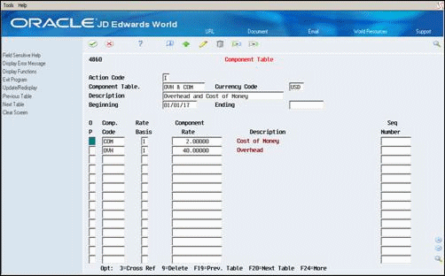

To define component calculation rules
On Component Table
  1. To identify a specific set of component calculation rules, complete the following fields:
    • Component Table
    • Description
  2. If you work in a multi-currency environment, complete the following field:
    • Currency Code
  3. To specify effective dates for the rules, complete the following optional fields:
    • Beginning
    • Ending
  4. To define one or more component calculation rules, complete the following fields:
    • Component Code
    • Rate Basis
    • Component Rate

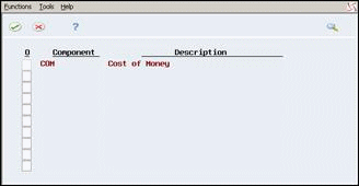

  2. Choose Cross Reference (Option 3) for a specific component calculation rule.
    Figure 34-2 Component Description screen
    Description of Figure 34-2 follows
    Description of ''Figure 34-2 Component Description screen''
  3. On Component Cross Reference, choose Select for Cross Reference (Option 4) for each component calculation rule that you want to include in the cross-reference.
    A component link number associates component calculations with its related workfile transaction.
    You can include only previously defined component calculation rules in your cross-reference information.
    The system highlights the Option field on Component Table for component calculation rules that include cross-reference information.
