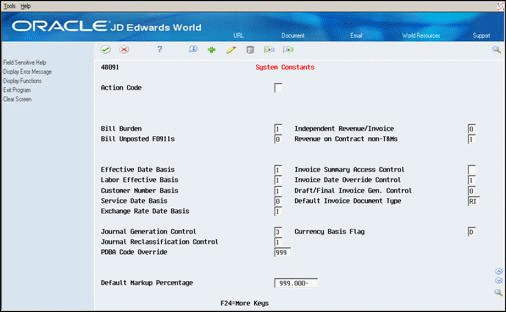

To set up system constants
On System Constants
Figure 33-1 System Constants screen
Description of Figure 33-1 follows
Description of ''Figure 33-1 System Constants screen''
  1. To specify how you want the system to process billable costs, complete the following fields:
    • Bill Burden
    • Bill Unposted F0911s
  2. To specify how the system processes revenue, complete the following field:
    • Independent Revenue/Invoice
  3. To recognize revenue for non-T&M contract billing lines prior to the billing process and control whether the system recognizes Not to Exceed rules for revenue, complete the following field:
    • Revenue on Contract Non-T&Ms
    See Section 11.2, "Defining Billing Lines for Lump Sum" and Section 11.7, "Defining Unit Price Billing Lines" for information about revenue on non-T&M owner pay items.
  4. To specify the dates you want the system to use when processing workfile transactions, complete the following fields:
    • Effective Date Basis
    • Labor Effective Basis
  5. To specify the date the system uses when processing accounts receivable transactions, complete the following field:
    • Service Date Basis
  6. To build an additional audit table for invoice information, complete the following field:
    • Invoice Summary Access Control
  7. To specify how the system processes invoices, complete the following fields:
    • Invoice Date Override Control
    • Draft/Final Invoice Generation Control
    • Default Invoice Document Type
  8. To specify how the system processes journal entries, complete the following fields:
    • Journal Generation Control
    • Journal Reclassification Control
    • PDBA Code Override
  9. To specify how the system processes multi-currency transactions, complete the following fields:
    • Exchange Rate Date Basis
    • Currency Basis Flag
  10. To specify the default value that the system uses when workfile transactions do not meet the criteria for any other markup rules, complete the following field:
    • Default Markup Percentage
