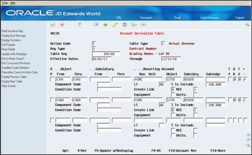

On Account Derivation Table
Figure 36-1 Account Derivation Table (Condition Code Names) screen
Description of Figure 36-1 follows
Description of ''Figure 36-1 Account Derivation Table (Condition Code Names) screen''
  1. Complete the following fields to locate a specific reallocation rule:
    • Table Type
    • Key Type
    • Table Key
    • Effective Dates
  2. Choose Condition Code Definition (F13).

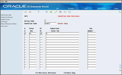

    Figure 36-2 Condition Code Revisions screen
    Description of Figure 36-2 follows
    Description of ''Figure 36-2 Condition Code Revisions screen''
  3. On Condition Code Revisions (P4871), complete the following field to locate a condition code:
    • Condition Code
  4. Complete the following field to define more than one condition for the code:
    • And/Or Selection (AO)
  5. Complete the following fields to define the conditions:
    • Value One
    • Relationship (Df Rl)
    • Comparison Value Two
    • Sequence Number (optional)
