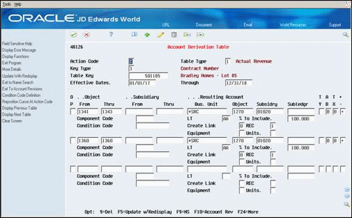

On Account Derivation Table
Figure 37-1 Account Derivation Table screen
Choose Condition Code Definition (F13).

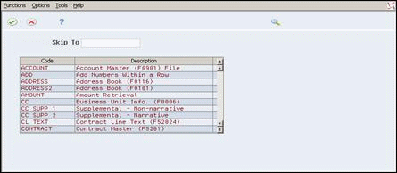

On Retrieval Reference, choose Field Sensitive Help (F1) for the following field to see a list of the predefined retrieval codes:
Retrieval Code
On Retrieval Code Selection, choose the code you want to use to define the retrieval reference.

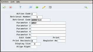

On Retrieval Reference, complete the following fields to specify an y of the parameters required for the retrieval code:
Parameter 1 - 5
Use the Add action.
