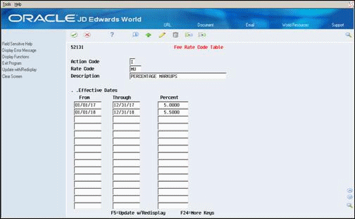

To define a fee rate code
On Fee Rate Code Table.
Figure 41-1 Fee Rate Code Table screen
Description of Figure 41-1 follows
Description of ''Figure 41-1 Fee Rate Code Table screen''
  1. To identify the fee rate code, complete the following fields:
    • Rate Code
    • Description
  2. Complete the following fields for one or more detail lines:
    • Effective From
    • Effective Through
    • Fee Percent
    • From date (optional)
    • Through date (required)

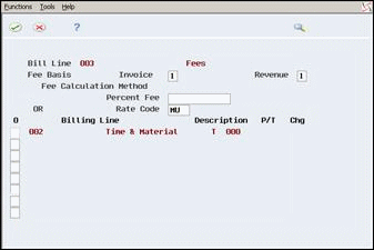

To assign a fee rate code to a fee billing line
On Contract Billing Line Details.
  1. To locate a contract, complete the Contract Number field.
  2. For a Fee billing line, choose Cross Reference (Option 2).
    Figure 41-2 Cross Reference for a Fee Billing Line screen
    Description of Figure 41-2 follows
    Description of ''Figure 41-2 Cross Reference for a Fee Billing Line screen''
  3. On Fee Cross Reference, enter the Rate Code.
