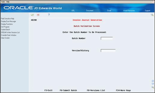

To create preliminary A/ R and G/L entries
On Invoice Journal Generation
Figure 26-1 Invoice Journal Generation screen
Complete the following fields and press Enter:
Batch Number
Version (optional)
If you leave the Version field blank, when you choose Enter, the system automatically uses the ZJDE0001 version.
Choose Submit Batch (F6).
The system displays the Exit and Submit Job Window so you can verify the batch post submission.
Choose Submit Job (F6).

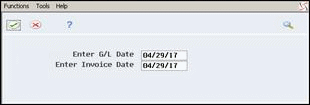

You use the Invoice Date Override Control system constant to control when the system displays the Date Override Window on Invoice Journal Generation. You can set the constant so that the system:
Always displays the window
Only displays the window when you choose Override Date (F10)
Never displays the window
The default date displayed in the Date Override Window is always the current system date.
Complete the following fields:
Batch
Version
Choose Override Date (F10).
On Date Override Window, complete the following fields and press Enter:
Enter G/L Date
Enter Invoice Date
Choose Process (F6).

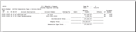

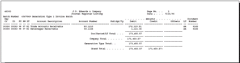

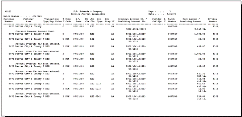

When the system creates preliminary A/R and G/L entries, you can review the batch status on Batch Review to determine whether the entries were generated with errors. To verify the information for the general ledger journal before you create the final A/R and G/L entries, you can review the following reports:
Invoice Journal Generation Report (R48131), to review the detail of all cost transactions that make up the pay items for your invoices, and the accounting rules for the transactions
Billing Journal Register (R48300), to review journal entry details summarized by business unit, object, subsidiary, and subledger
Depending on the processing options, the reports can include error messages and warnings related to the journal information.
Review the Billing Journal Register first for errors and warnings. Use the Invoice Journal Generation Report to locate errors resulting from the account derivation rules.
Figure 26-3 Invoice Journal Generation Report
Figure 26-5 Journal Register Listing (Additional)

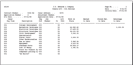

To create final A/R and G/L entries
On Create A/R and G/L Entries
Figure 26-6 Generate A/R and G/L Entries screen
Batch Number
Version
If the Invoice Date Override Control option in the Service Billing Constants is set to automatically display the date override window, then enter the override G/L date and invoice date to assign to the invoices and invoice journal entries. Choose Process (F6).
The system displays a message prompting you to verify the batch submission.
See Also:
Figure 26-7 Generate A/R - G/L Entries Report
