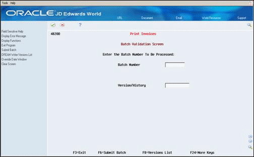

On Print Invoices
Figure 25-1 Print Invoices screen
Description of Figure 25-1 follows
Description of ''Figure 25-1 Print Invoices screen''
  1. Enter the batch number that contains the invoices to be printed.
  2. Place the cursor in the following field:
    • Version

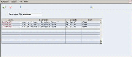

  3. Choose Field Sensitive Help (F1).
    The system displays DREAM Writer Selection List.
    Figure 25-2 DREAM Writer Selection List screen
    Description of Figure 25-2 follows
    Description of ''Figure 25-2 DREAM Writer Selection List screen''
  4. On DREAM Writer Selection List, choose Select Value (Option 4) for a specific program version.
    After you enter the information, the system displays the version number you selected in the Version field on Print Invoices. If you do not specify a version in the Version field on Print Invoices, the system runs version ZJDE0001.
    The value for the invoice type in the processing option for the ZJDE000l program might not correspond to the value indicated in the DREAM Writer title. If you need to change the invoice type for the print program, you can access this processing option when you select Print Invoices. Choose the Versions List function (F8) and then select Change (Option 2) for the version.
  5. Choose Submit Batch (F6).
    The system displays the message Verify Invoice Print Submission.
  6. Choose Submit Batch again.
