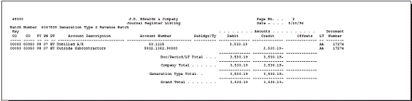

30.1.2 Journal Register Listing
Figure 30-3 Journal Register Listing
Description of Figure 30-3 follows
Description of ''Figure 30-3 Journal Register Listing''
