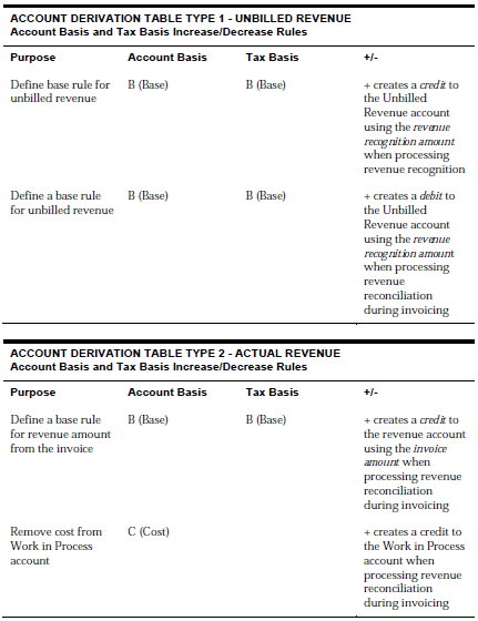

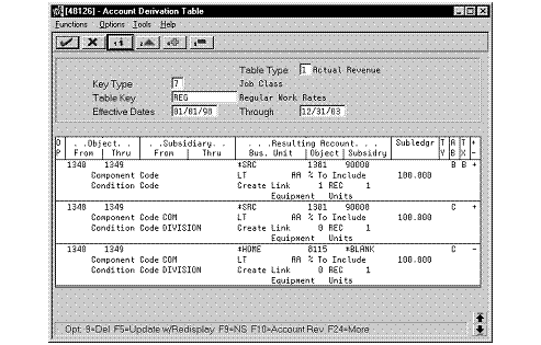

C.1 Base Rules
There are three types of Account Derivation Tables that the system can use to create revenue recognition and invoice journal entries. The type of journal processing that you select in the system constants controls whether the system is restricted from using a specific table type. Each applicable type must contain a base rule that defines how the system creates journal entries.
The following table shows the relationship between the Journal Generation Control field in the system constants and the Table Type field for the account derivation rules.
If you are processing Set Journal Generation Control in system constants as: Create Information for Account Derivation Table Types Restricted Account Derivation Table Types
Invoices only 1 3 1 and 2
Revenue Recognition only 2 1 and 3 2
Invoices and Revenue Recognition without Revenue Reconciliation 3 1 and 3 2
Invoices and Revenue Recognition with Revenue Reconciliation 4 1, 2, and 3 N/A

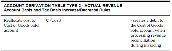

The system uses the RC Automatic Accounting Instruction (AAI) for accounts receivable and retainage when you generate invoices. The RC AAI does not apply if you are processing revenue recognition only.
The following table shows how the system uses the base rules to create the accounting journal entries. The amount basis results from either the invoicing or revenue recognition process.
Journal Generation Control Table Types Amount Basis "+" Indicates System Created Entries
1 Invoices 3 Invoice Credit entry Actual Revenue
  RC AAI Invoice Debit entry Accounts Receivable
2 Revenue Recognition 1 Revenue Recognition Credit Entry Actual Revenue
  3 Revenue Recognition Debit Entry Unbilled Accounts Receivable
3 Revenue Recognition without Reconciliation 1 Revenue Recognition Credit Entry Actual Revenue
  3 Invoice Credit Entry Unbilled Accounts Receivable
  RC AAI Invoice Debit Entry Accounts Receivable
4 Revenue Recognition with Reconciliation 1 Revenue Recognition Credit Entry Unbilled Revenue
  2 Invoice Credit Entry Actual Revenue
  3 Invoice Debit Entry Unbilled Revenue
  RC AAIs Invoice Debit Entry Accounts Receivable

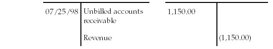

C.2 Invoicing Only
When you process invoicing only:
  • The journal generation control is 1
  • Revenue recognition does not apply
  • The system calculates the same amount for actual revenue and accounts receivable
  • The system calculates the amounts for revenue and accounts receivable simultaneously
  • The RC AAI designates the accounts for accounts receivable and retainage
For example, if the cost for a workfile transaction is 100.00 and the markup is 15 percent, the amounts for the invoice and accounts receivable are 115.00. The system creates the following journal entry:
Figure C-1 Example Invoicing Journal Entry
Description of Figure C-1 follows
Description of ''Figure C-1 Example Invoicing Journal Entry''
The "T" account posting in the general ledger is:
Figure C-2 Example Invoicing T Account Posting in the General Ledger
Description of Figure C-2 follows
Description of ''Figure C-2 Example Invoicing T Account Posting in the General Ledger''
The RC AAI directs the system to the accounts receivable and retainage account information. Account Derivation Table Type 3 directs the system to the base rules for the actual revenue account.

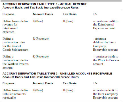

The system uses two different table types to direct the system to the base rules for the journal entries:
  • Table type 1 directs the system to the rules for actual revenue
  • Table type 3 directs the system to the rules for unbilled accounts receivable

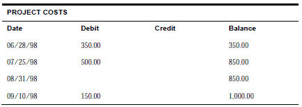

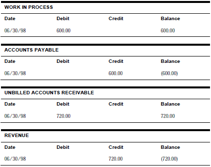

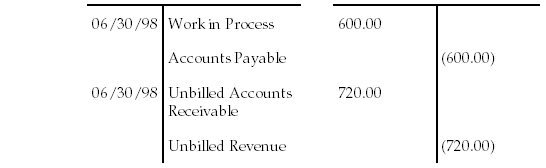

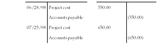

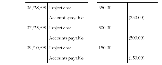

For example, your company began a project on June 15 and completed the project 90 days later. The total cost for the project was 1,000.00. Every week, the company generates the workfile transactions with a 15 percent markup added to the cost. Your company processes revenue recognition at the end of each month, beginning in June. They process the invoice on September 25.
The system creates the following journal entries for the project costs:
Figure C-5 Journal Entries for the Project Costs
Description of Figure C-5 follows
Description of ''Figure C-5 Journal Entries for the Project Costs''
The "T" account postings and balances in the general ledger are:
Figure C-6 T Account Postings and Balances in the General Ledger
Description of Figure C-6 follows
Description of ''Figure C-6 T Account Postings and Balances in the General Ledger''

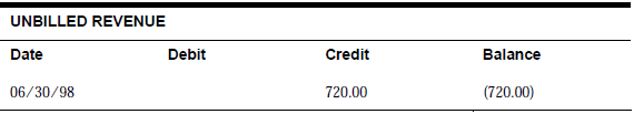

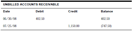

C.4.1 Revenue Recognition for June

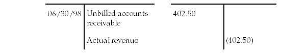

On June 30, your company processes revenue recognition. The workfile contains a new transaction for 402.50. The system uses the following calculation for the workfile transaction:
  • 350.00 cost X 15 percent markup = 52.50
  • 350.00 cost + 52.50 = 402.50

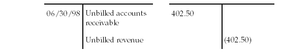

The system creates the following journal entry for revenue recognition:
Figure C-7 Journal Entry for June Revenue Recognition
Description of Figure C-7 follows
Description of ''Figure C-7 Journal Entry for June Revenue Recognition''

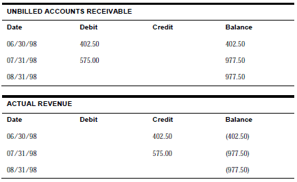

The "T" account postings and balances for June in the general ledger are:
Figure C-8 T Account Postings and Balances for June in the General Ledger
Description of Figure C-8 follows
Description of ''Figure C-8 T Account Postings and Balances for June in the General Ledger ''

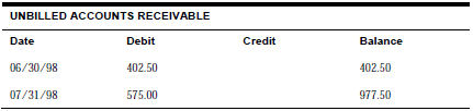

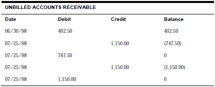

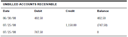

Account Derivation Table Type 3 directs the system to unbilled accounts receivable base rules. It creates a debit journal entry for the revenue recognition amount.
Figure C-9 Debit Journal Entry for the June Revenue Recognition Amount
Description of Figure C-9 follows
Description of ''Figure C-9 Debit Journal Entry for the June Revenue Recognition Amount''

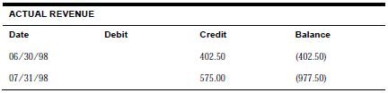

Accounts Derivation Table Type 1 directs the system to the base rules for actual revenue. It creates a credit journal entry for the revenue recognition amount.
C.4.2 Revenue Recognition for July

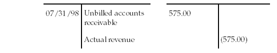

On July 31, your company processes revenue recognition. The workfile contains a new transaction for 575.00. The system uses the following calculation for the workfile transaction:
  • 500.00 cost X 15 percent markup = 75.00
  • 500.00 cost + 75.00 = 575.00
Figure C-10 Journal Entry for July Revenue Recognition
Description of Figure C-10 follows
Description of ''Figure C-10 Journal Entry for July Revenue Recognition''
The "T" account postings and balances for July in the general ledger are:
Figure C-11 T Account Postings and Balances for July in the General Ledger
Description of Figure C-11 follows
Description of ''Figure C-11 T Account Postings and Balances for July in the General Ledger''
Figure C-12 Debit Journal Entry for July Revenue Recognition Amount
Description of Figure C-12 follows
Description of ''Figure C-12 Debit Journal Entry for July Revenue Recognition Amount''

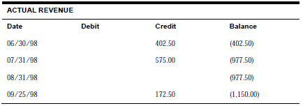

Account Derivation Table Type 1 directs the system to the base rules for actual revenue. It creates a credit journal entry for the revenue recognition amount.

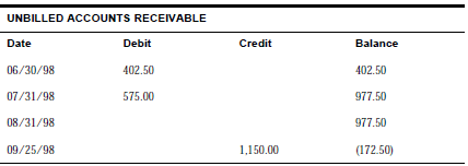

C.4.3 Revenue Recognition for August
In August, your company does not have new costs for the project. No new workfile transactions exist for the project. The balances for August in the general ledger are:
Figure C-13 August Balances in the General Ledger
Description of Figure C-13 follows
Description of ''Figure C-13 August Balances in the General Ledger''

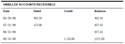

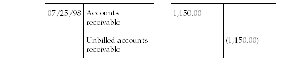

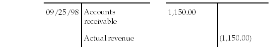

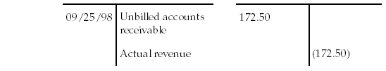

C.4.4 Invoicing for September
On September 25, your company processes the invoice. The workfile contains a new transaction for 172.50. The system uses the following calculation for the workfile transaction:
  • 150.00 cost X 15 percent markup = 22.50
  • 150.00 cost + 22.50 = 172.50
The system creates the following journal entry for the invoice:
Figure C-14 September Invoicing Journal Entry
Description of Figure C-14 follows
Description of ''Figure C-14 September Invoicing Journal Entry''

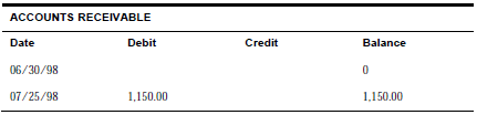

The workfile transactions for June, July, and September have not been invoiced up to now. The system sums the invoice amounts for the three months to create an invoice amount of 1,150.00.
The "T" account postings and balances for September in the general ledger for the invoice journals are:
Figure C-15 September Invoicing T Account Postings and Balances in the General Ledger
Description of Figure C-15 follows
Description of ''Figure C-15 September Invoicing T Account Postings and Balances in the General Ledger''

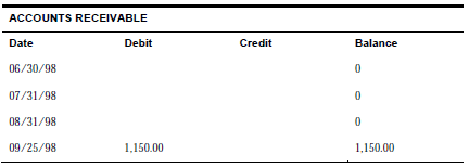

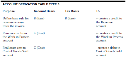

The system uses the Account Derivation Table Type 3 to determine the base rules for unbilled accounts receivable. When it creates the journal entry, it credits the invoice amount to unbilled accounts receivable. Unbilled Accounts Receivable contains an unreconciled balance of 172.50.
Figure C-16 September Invoicing Accounts Receivable Table
Description of Figure C-16 follows
Description of ''Figure C-16 September Invoicing Accounts Receivable Table''
Accounts receivable contains the actual invoiced amount. The system uses the RC AAI to create the journal entry for Accounts Receivable.

After you post the adjustment, the amount for actual revenue equals the amount for accounts receivable, and the variance for unbilled accounts receivable self-corrects. The "T" account postings and balances for September in the general ledger are:
Figure C-18 September T Account Postings and Balances in the General Ledger
Description of Figure C-18 follows
Description of ''Figure C-18 September T Account Postings and Balances in the General Ledger''

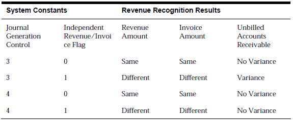

C.5 Revenue Recognition and Invoicing with Reconciliation
Many companies do not want a variance between invoice and recognized revenue amounts. In this case, the revenue and receivable amounts are unbilled estimates. The actual revenue and receivable amounts always equal the invoiced amounts. When a company processes invoices, all the estimates are reconciled.
For example, if the company recognizes revenue monthly, but generates invoices only after the work is completed, the estimated revenue and receivable amounts are reconciled when the actual revenue and receivable amounts for the invoice are processed.
When you process invoices with revenue reconciliation, the journal generation control is 4.
When you process revenue recognition:
  • Invoicing does not apply when you process revenue recognition at the end of each month
  • The system calculates the same amount for unbilled revenue and unbilled accounts receivable
  • The system calculates the amounts for unbilled revenue and unbilled accounts receivable simultaneously
  • The system uses two different table types for the account derivation rules to create the journal entries:
    • · Table type 1 directs the system to the rules for unbilled revenue
    • · Table type 3 directs the system to the rules for unbilled accounts receivable
When the work is complete at a later time, and you process invoices:
  • The system calculates the same amount for unbilled accounts receivable and accounts receivable
  • The system calculates the amounts for unbilled accounts receivable and accounts receivable simultaneously
  • The RC AAI designates the A/R account
  • The system uses the account derivation rules and AAIs to create the journal entries. Table type 3 directs:
    • · The system to the rules for unbilled accounts receivable
    • · The RC AAI to the account information for accounts receivable
The system also:
  • Processes the revenue reconciliation journals
  • Reconciles the unbilled revenue and receivable amounts
  • Creates the actual income amounts
  • Uses three different table types for the account derivation rules to create journal entries:
    • · Type 1 to reconcile the unbilled revenue amounts
    • · Type 2 to credit the actual revenue amount
    • · Type 3 to reconcile the unbilled accounts receivable amounts
For example, your company began a project on June 15 and completed the project 30 days later. The total cost for the project was 1,000.00. Every week, the company generates the workfile transactions with a 15 percent markup added to the cost. Your company processes revenue recognition at the end of each month, beginning in June. They process the invoice on July 25. The system creates the following journal entries for the project costs:
Figure C-21 Journal Entry for Project Cost
Description of Figure C-21 follows
Description of ''Figure C-21 Journal Entry for Project Cost''

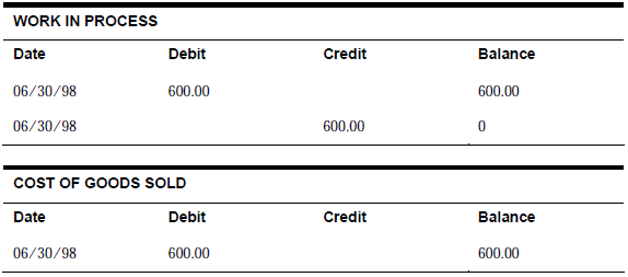

The "T" account postings and balances for the cost in the general ledger are:
Figure C-22 T Account Postings and Balances for the Cost in the General Ledger
Description of Figure C-22 follows
Description of ''Figure C-22 T Account Postings and Balances for the Cost in the General Ledger''
C.5.1 Revenue Recognition for June
The system creates the following journal entry for revenue recognition for the unbilled revenue and unbilled accounts receivable:
Figure C-23 Journal Entry for Revenue Recognition for Unbilled Revenue and Unbilled Accounts Receivable
Description of Figure C-23 follows
Description of ''Figure C-23 Journal Entry for Revenue Recognition for Unbilled Revenue and Unbilled Accounts Receivable''
Figure C-24 June T Account Postings and Balances in the General Ledger
Description of Figure C-24 follows
Description of ''Figure C-24 June T Account Postings and Balances in the General Ledger''
Figure C-25 Debit Journal Entry for Revenue Recognition Amount
Description of Figure C-25 follows
Description of ''Figure C-25 Debit Journal Entry for Revenue Recognition Amount''
Account Derivation Table Type 1 directs the system to unbilled revenue base rules. It creates a credit journal entry for the revenue recognition amount.
C.5.2 Invoicing for July
On July 25, your company processes the invoice. The workfile contains a new transaction for 747.50. The system uses the following calculation for the workfile transaction:
  • 650.00 cost X 15 percent markup = 97.50
  • 650.00 cost + 97.50 = 747.50

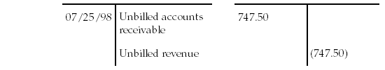

The system creates the following journal entry for the June and July workfile transactions by adding the 402.50 and 747.50 that apply to the invoice:
Figure C-26 Journal Entry for June and July Workfile Transactions
Description of Figure C-26 follows
Description of ''Figure C-26 Journal Entry for June and July Workfile Transactions''
Figure C-27 July T Account Postings and Balances in the General Ledger
Description of Figure C-27 follows
Description of ''Figure C-27 July T Account Postings and Balances in the General Ledger''
"S" Account Derivation Table Type 3 directs the system to unbilled accounts receivable base rules. It creates a credit journal entry for the invoice amount.
Figure C-28 Credit Journal Entry for the Invoice Amount
Description of Figure C-28 follows
Description of ''Figure C-28 Credit Journal Entry for the Invoice Amount''
The RC AAI directs the system to the accounts receivable and retainage account information. It uses the invoice amount to create the debit for the journal entry.

The account postings and the balances in the general ledger for the journals are:
Figure C-30 Account Postings and Balances in the General Ledger for the Journals
Description of Figure C-30 follows
Description of ''Figure C-30 Account Postings and Balances in the General Ledger for the Journals''
Account Derivation Table Type 3 directs the system to the base rules for unbilled accounts receivable. It creates a debit journal entry for the revenue recognition amount.

Description of ''Figure C-35 Journal Entries for Revenue Recognition''
Figure C-36 Journal Entries for Revenue Recognition
Description of Figure C-36 follows
Description of ''Figure C-36 Journal Entries for Revenue Recognition''
Account Derivation Table Type 3 directs the system to the base rules for unbilled accounts receivable. It creates a debit journal entry for the invoice amount.
Figure C-37 Debit Journal Entry for the Invoice Amount
Description of Figure C-37 follows
Description of ''Figure C-37 Debit Journal Entry for the Invoice Amount''
Account Derivation Table Type 2 directs the system to the base rules for actual revenue. It creates a credit journal entry for the invoice amount.

C.7 Invoicing Only
A company creates an invoice for 1,200.00. The original cost per unit is 10.00 for 100 units. The cost of each unit is recorded in the Work in Process account. After the units are invoiced, the cost is moved from the Work in Process account to the Cost of Goods Sold account. Each unit is sold for 12.00.
The journal entries are:
Figure C-38 Invoicing Only Journal Entries
Description of Figure C-38 follows
Description of ''Figure C-38 Invoicing Only Journal Entries''
The Account Derivation Table rules for Table Type 3 - Actual Revenue first direct the 1,200.00 invoice amount to the Sales Revenue account. The system uses the AAIs to create the Accounts Receivable portion of the journal entry. Then, the Work in Process account is reduced and the Cost of Goods Sold is increased by the cost amount.
The account postings and balances for June in the general ledger are:
Figure C-39 June Account Postings and Balances in the General Ledger
Description of Figure C-39 follows
Description of ''Figure C-39 June Account Postings and Balances in the General Ledger''
In the example, the Journal Generation system constant is set to 1 because the company is creating invoices only without revenue recognition. Account Derivation Table Type 3 is the only table needed to create the revenue and reallocation journal entries.
C.7.1 Account Derivation Table Rules
You set up the Account Derivation Table rules for invoicing only as follows:
Figure C-40 Account Derivation Table Rules for Invoicing
Description of Figure C-40 follows
Description of ''Figure C-40 Account Derivation Table Rules for Invoicing''
The RC AAI directs the system to the account information associated with the debit to Accounts Receivable.
Caution:
To determine the correct +/- entry, you must analyze the type of account and the normal type of balance within the account. For example, the Work in Process account is usually a balance sheet account with a debit (+) balance. If you use a + on Table Type 3 when the Journal Generation is set to only create invoices, the system automatically creates a credit (-) entry to the resulting account.

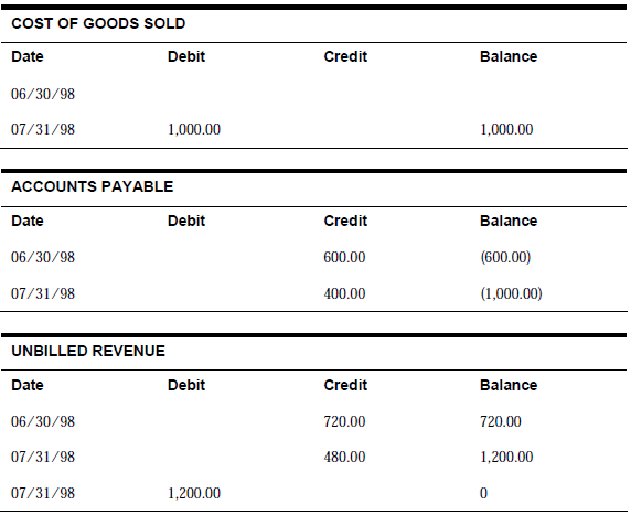

C.9 Invoicing and Revenue Recognition without Reconciliation
A company recognizes revenue for 1,200.00 over a two-month period. The second month, the company processes an invoice for 1,200.00. The original cost per unit is 10.00 for 100 units. The cost of each unit is recorded in the Work in Process account. After revenue is recognized for the units, the cost is moved from the Work in Process Account to the Cost of Goods Sold account. Revenue is recognized for each unit at 12.00 per unit.
Figure C-46 Without Reconciliation Journal Entries
Description of Figure C-46 follows
Description of ''Figure C-46 Without Reconciliation Journal Entries''
In June, the Account Derivation Table rules for Table Type 1 - Actual Revenue first direct the 720.00 revenue amount to the Revenue account. The Account Derivation Table rules for Table Type 3 - Unbilled Receivables directs the 720.00 for unbilled receivables to the Unbilled Accounts Receivable account.
In July, the system uses the RC AAI to debit the Accounts Receivable account for the amount of the invoice. Then, the system uses Table Type 3 - Unbilled Receivables to create a 1,200.00 credit.
The system also determines whether the workfile transactions that make up the 1,200.00 invoice require any revenue adjustments. In this example, a 420.00 workfile transaction was not included in the revenue batch prior to creating the invoice. The system creates two additional journal entries for the revenue adjustments applicable to the workfile transaction.
The system uses the Account Derivation Table rules for Table Type 1 - Actual Revenue to adjust the revenue amount by 420.00 and create a credit to the Revenue account. Then the system uses the Account Derivation Table rules for Table Type 3 - Unbilled Receivables to adjust unbilled receivables by 420.00 and create a debit to the Unbilled Accounts Receivable account.
In this example, Unbilled Accounts Receivable reconciled to "zero" because of the timing difference between revenue recognition and invoicing. Typically, a variance would exist in the account each month because the system does not create reconciling entries to reconcile the unbilled balance.
Finally, the system reduces the Work in Process and increases the Cost of Goods Sold by the cost amount each month.

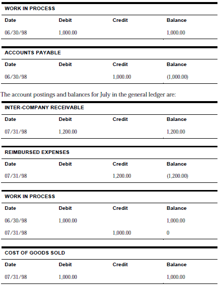

Figure C-47 June Account Postings and Balances in the General Ledger (1 of 2)
Description of Figure C-47 follows
Description of ''Figure C-47 June Account Postings and Balances in the General Ledger (1 of 2)''
Figure C-48 June Account Postings and Balances in the General Ledger (2 of 2)
Description of Figure C-48 follows
Description of ''Figure C-48 June Account Postings and Balances in the General Ledger (2 of 2)''

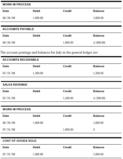

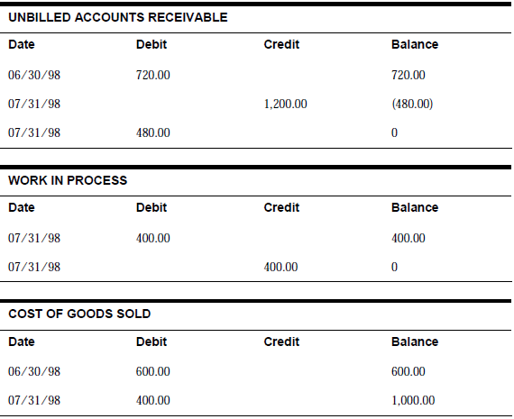

The account postings and balances for July in the general ledger are:
Figure C-49 July Account Postings and Balances in the General Ledger (1 of 2)
Description of Figure C-49 follows
Description of ''Figure C-49 July Account Postings and Balances in the General Ledger (1 of 2)''
Figure C-50 July Account Postings and Balances in the General Ledger (2 of 2)
Description of Figure C-50 follows
Description of ''Figure C-50 July Account Postings and Balances in the General Ledger (2 of 2)''

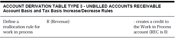

The Reverse Entry Control (REC) field is used to prevent the system from creating a reversing entry for rules on the Account Derivation Table. You can use the Reverse Entry Control field with any entry other than the Base Entry rule for a table.
When the Journal Generation Control is 3, the system uses Table Type 3 - Unbilled Accounts Receivable to create both a journal entry for revenue recognition and invoices. The revenue recognition journal entry debits Unbilled Accounts Receivable. The invoice journal entry credits Unbilled Accounts Receivable.
If a reallocation rule is defined on Table Type 3 - Unbilled Accounts Receivable and is only applicable to revenue recognition, the Reverse Entry Control should be set to prevent the system from using the rule when it creates the invoice journal entries.
The reallocation rule for the Work in Process and Cost of Goods Sold accounts creates journal entries only when the system creates the revenue recognition journals. In this case, the value in the Reverse Entry Control field should be 0 to prevent the system from creating additional journal entries, per Method 2 in the following account derivation rules.
The journal entries for June are:
Figure C-54 Journal Entries for June
Description of Figure C-54 follows
Description of ''Figure C-54 Journal Entries for June''
Figure C-55 June Account Postings and Balances in the General Ledger (1 of 2)
Description of Figure C-55 follows
Description of ''Figure C-55 June Account Postings and Balances in the General Ledger (1 of 2)''
Figure C-56 June Account Postings and Balances in the General Ledger (2 of 2)
Description of Figure C-56 follows
Description of ''Figure C-56 June Account Postings and Balances in the General Ledger (2 of 2)''
In June, the Account Derivation Table rules for Table Type 1 - Actual Revenue first direct the 720.00 revenue amount to the Revenue account. The Account Derivation Table rules for Table Type 3 - Unbilled Receivables direct the 720.00 for unbilled receivables to the Unbilled Accounts Receivable account.
The journal entries for July are:
Figure C-57 July Journal Entries
Description of Figure C-57 follows
Description of ''Figure C-57 July Journal Entries''

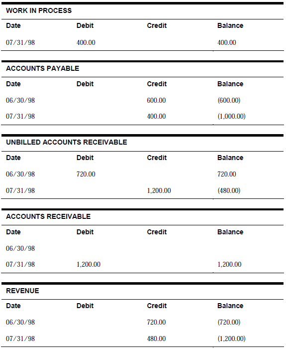

The account postings and balance for July in the general ledger are:
Figure C-58 July Account Postings and Balances in the General Ledger (1 of 4)
Description of Figure C-58 follows
Description of ''Figure C-58 July Account Postings and Balances in the General Ledger (1 of 4)''
Figure C-59 July Account Postings and Balances in the General Ledger (2 of 4)
Description of Figure C-59 follows
Description of ''Figure C-59 July Account Postings and Balances in the General Ledger (2 of 4)''
Figure C-60 July Account Postings and Balances in the General Ledger (3 of 4)
Description of Figure C-60 follows
Description of ''Figure C-60 July Account Postings and Balances in the General Ledger (3 of 4)''
Figure C-61 July Account Postings and Balances in the General Ledger (4 of 4)
Description of Figure C-61 follows
Description of ''Figure C-61 July Account Postings and Balances in the General Ledger (4 of 4)''
C.10.1 Account Derivation Table Rules
When you set up the Account Derivation Tables rules for revenue recognition and invoicing with reconciliation, you must define all three table types. Set up the rules as follows:
Figure C-62 Account Derivation Table Rules, Types 1 and 2
Description of Figure C-62 follows
Description of ''Figure C-62 Account Derivation Table Rules, Types 1 and 2''
Figure C-63 Account Derivation Table Rules, Type 2 (Actual Revenue)
Description of Figure C-63 follows
Description of ''Figure C-63 Account Derivation Table Rules, Type 2 (Actual Revenue)''
The Reverse Entry Control (REC) field does not apply because the reallocation rules for the Work in Process and Cost of Goods Sold accounts are defined on Table Type 2 - Actual Revenue. Table Type 2 - Actual Revenue is used only during invoice journaling when the system performs the revenue reconciliation.
Figure C-64 Account Derivation Tables, Type 3
Description of Figure C-64 follows
Description of ''Figure C-64 Account Derivation Tables, Type 3''
Figure C-65 Account Derivation Tables, Type 3 (Continued)
Description of Figure C-65 follows
Description of ''Figure C-65 Account Derivation Tables, Type 3 (Continued)''
C.11 Component Reallocations
A component is a markup that can be associated with a workfile transaction's cost, revenue, and invoice amount, or any combination of these three. If a component amount exists, an account derivation rule can reclassify the amount.
Figure C-66 Account Derivation Table screen
Description of Figure C-66 follows
Description of ''Figure C-66 Account Derivation Table screen''

The following results occur based on the relationships between the system constants and the revenue recognition process:
Figure C-69 Independent Revenue Results
Description of Figure C-69 follows
Description of ''Figure C-69 Independent Revenue Results''
If the Journal Generation Control is:
  • 3 - process revenue recognition without reconciliation
  • 4 - process revenue recognition with reconciliation
If the Independent Revenue Invoice Control is:
  • 0 - the invoice amount always equals the revenue amount
  • 1 - the invoice and revenue amounts can differ
