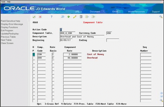

To define one or more component calculation rules, complete the following fields:
Component Code
Rate Basis
Component Rate
| Field | Explanation |
| Component Table
(CTBL) |
A user-specified code that identifies a set of component rules.
If you work in a multi-currency environment, the system displays only the codes that are related to markup tables with the same currency code in the Component Table Selection window. |
| Currency Code
(CRCD) |
A code that indicates the currency of a customer's or a supplier's transactions.
Form-specific information Specify a currency code in conjunction with the component table and effective dates to identify a set of component rules. The currency code that you specify in this field controls the decimal display on the Component Table form. |
| Beginning
(EFTB) |
The date on which an address, item, transaction, or table becomes active or the date from which you want transactions to display. |
| Ending
(EFTE) |
The date on which the item, transaction, or table becomes inactive or the date through which you want transactions to display. |
| Comp Code
(CCOD) |
A component code identifies a provisional burden that is accounted for at the billing detail transaction level. |
| Component Rate Basis
(UORC) |
A code that determines whether the calculation of the components is based on the unit(s) or amount(s) of the base billing detail transaction.
1 – Amount Basis. The number in the Component Rate field is treated as a percentage. The system calculates the component amount by multiplying the component rate percentage by the cost, invoice or revenue amount from the base billing detail transaction. 2 – Unit Basis. The number in the Component Rate field is treated as a flat amount. The system calculates the component amount by multiplying the component rate flat amount by the number of units from the base billing detail transaction. Note: You can enter C for 1 or U for 2. |
| Component Rate Percent
(CRTP) |
The rate that the system applies when it creates the individual component records. This field can be either a percentage or a flat amount, depending on the value entered in the "Component Rate Basis" (UORC) field.
If the component rate basis is units, then the component rate is a flat amount which is multiplied by the number of units from the base billing detail transaction. If the component rate basis is amount, then the component rate is a percentage which is multiplied by the cost, invoice, or revenue amount from the base billing detail transaction. |

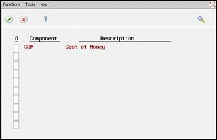

Choose Cross Reference (Option 3) for a specific component calculation rule.
Figure 19-2 Component Cross Reference screen
On Component Cross Reference, choose Select for Cross Reference (Option 4) for each component calculation rule that you want to include in the cross-reference.
A component link number associates component calculations with its related workfile transaction.
Note: You can include only previously defined component calculation rules in your cross-reference information. |

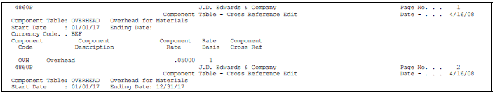

The system highlights the Option field on Component Table for component calculation rules that include cross-reference information.
Figure 19-3 Component Table - Cross Reference Edit report (1 of 2)
Figure 19-4 Component Table - Cross Reference Edit report (2 of 2)
