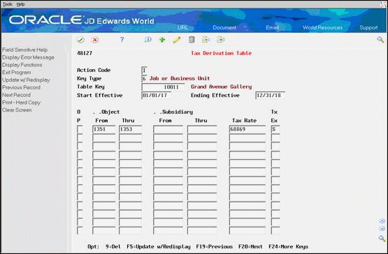

On Tax Derivation Table
Figure 24-1 Tax Derivation Table screen
Description of Figure 24-1 follows
Description of ''Figure 24-1 Tax Derivation Table screen''
  1. Complete the following fields:
    • Key Type
    • Table Key
  2. Complete the following optional fields to further define the tax rule:
    • Start Effective
    • Ending Effective
  3. Complete the following fields to specify the account range for the rule:
    • Object From
    • Object Thru
    • Subsidiary From (optional)
    • Subsidiary Thru (optional)
  4. Complete the following fields to specify the tax information for the rule:
    • Tax Rate
    • Tax Explanation
Field Explanation
Tax Rate
(TXA1)
A code that identifies a tax or geographic area that has common tax rates and tax distribution. You must define the tax/rate area to include the tax authorities (for example, state, county, city, rapid transit district, province, and so on) and their rates. In order for the codes to be valid, you must set them up in the Tax Rate/Area file.
Form-specific information
You can specify a specific Tax Rate/Area or use one of the following values:
*CC – Use the Tax Rate/Area and Tax Explanation Code from the Business Unit
*WO – Use the Tax Rate/Area and Tax Explanation Code from the Work Order
Tax Expl Code
(EXR1)
A user defined code (00/EX) that controls how a tax is assessed and distributed to the G/L revenue and expense accounts.
