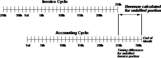

14.3.1 Reconciliation for Timing Differences
If you do not recognize revenue and generate invoices at the same time, the timing difference creates a variance in unbilled accounts receivable.
Figure 14-1 Timing the Revenue Recognition and Invoice Generation
Description of Figure 14-1 follows
Description of ''Figure 14-1 Timing the Revenue Recognition and Invoice Generation''
For example, you plan to invoice a project only after the customer approves and accepts the completed project. The project takes three months to complete and you recognize revenue for the project each month. Because of the timing difference between when you recognize revenue (each month) and generate invoices (after completion) for the project, an unreconciled balance exists in unbilled accounts receivable.
Three months later, when you bill the project:
  • Trade accounts receivable and total revenue amounts for the project are the same
  • The variance in unbilled accounts receivable nets to zero
In the case of a timing difference, over time, all variances are reconciled and net to zero for unbilled accounts receivable.
