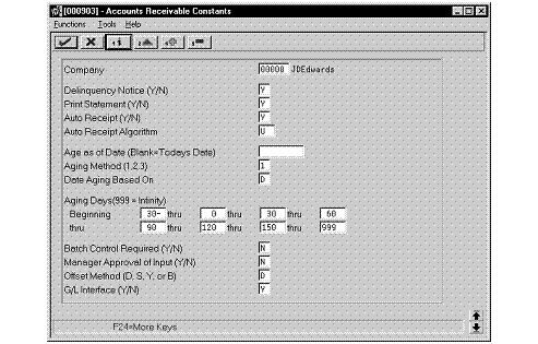

To set up the automatic offset method for A/R
From Accounts Receivable (G03), enter 29
From Accounts Receivable Setup (G0341), choose Accounts Receivable Constants
On Accounts Receivable Constants
Figure 6-2 Accounts Receivable Constants screen
To locate a specific company, complete the following field:
Company
To specify the offset method, complete the following field:
Offset Method
| Field | Explanation |
| Offset Method (D, S, Y, or B) | The method for automatically generating an offset entry when it is posted to the general ledger. Valid codes are:
The system creates offsets against actual amount and multi-currency ledger types only. |

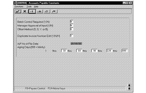

To set up the automatic offset method for A/P
From Accounts Payable (G04), enter 29
From Accounts Payable Setup (G0341), choose Accounts Payable Constants
Figure 6-3 Accounts Payable Constants screen
Complete the following field:
Offset Method
