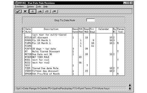

Figure 24-1 Due Date Rule Revisions screen
Complete the following fields:
Date Rule
Description
To define how the system calculates the due date, complete any of the following fields:
Based on Date
Months to Add
Days to Add
Fix Days to Use
To specify information about a workday calendar, complete the following fields:
Calendar
Workday Rule

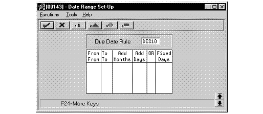

To set up a date range as part of your due date rule, choose the Date Range option next to the rule.
On Date Range Setup, complete the following fields:
From Day Range
To Day Range
Complete the following optional fields and press Enter:
Add Months
Add Days
Fixed Days
Choose the Update function to update and redisplay the due date rule.

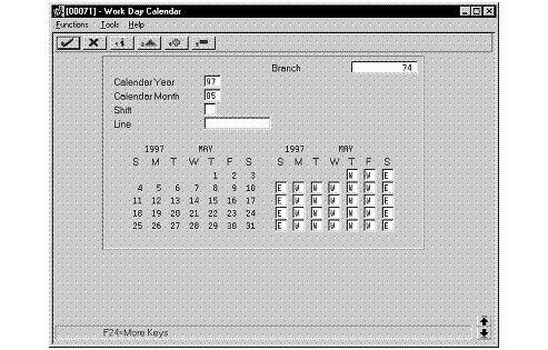

If you specify a workday rule, you can adjust the payments due date to correspond with your working days. For example, you can prevent unintended "grace periods" that might occur if the due date falls on a Saturday and your business is closed. In addition, you can specify that the payment is due in 30 working days instead of 30 calendar days.
Branch
Calendar Year
Calendar Month
The calendar for the month and year displays twice. The left portion of the screen shows the numerical days, and the right portion of the screen shows the workdays and non-workdays.
In the right portion of the screen, change the default values as necessary for each day of the week.

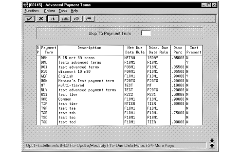

Figure 24-4 Advanced Payment Terms screen
Payment Term
Description (optional)
To attach a due date rule to the payment term, complete the following fields:
Net Due Date Rule
Discount Due Date Rule
To specify a discount percentage for the invoice, complete the following field:
Discount Percentage
| Field | Explanation |
| Payment Terms | A code that specifies the terms of payment, including the percentage of discount available if the invoice is paid within a certain amount of time. A blank code usually indicates the most frequently used payment term. You define the specifications for each type of payment term on the Payment Terms Revisions screen. For example:
This code prints on customer invoices. |
| Description - Payment Terms | The text that describes the payment terms code. You can print this text on the invoice, for example, 2/10, net 30, fixed day 25. |
| Net Due Date Rule | The due date rule that the system uses to calculate the net due date of an invoice installment. You define net due date rules on the Due Date Rules Revisions screen. |
| Discount Due Date Rule | The due date rule that the system uses to calculate the discount due date of an invoice. This is similar to a discount due date payment term. You define the discount due date rule on the Due Date Rules Revisions screen. |
| Disc Perc | The percent of the total invoice that will be discounted if the invoice is paid within the discount period. This is entered as a decimal, for example, a 2% discount is .02. |

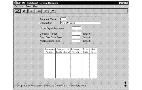

Figure 24-5 Installment Payment Revisions screen
Payment Terms
To set up equal installment payments with the same due date rules, complete the following fields in the header area:
Number of Equal Payments
Discount Percent
Net Due Date Rule
To set up unequal installment payments or to apply different due date rules, complete the following fields for each installment in the detail area:
Sequence Number
Percent of Installment
Discount Percent
Net Due Date Rule
| No. of Equal Payments | This field indicates the number of equal installments to be initially generated by the system. Using default values, the system uses this fast path method to create equal installments. |
| Discount Percent | The default value for the percent of the total invoice that will be discounted if the invoice is paid within the discount period. This is entered as a decimal, for example, a 2% discount is .02. Note, this field is only available the first time that installments are entered for a payment term. It is the value which will initially be replicated for the generated installments. |
| Disc. Due Date Rule | The default value of the discount due date rule that the system uses when generating equal installments.
Note: This field is only available for use when first generating new equal installments for a payment term. |
| Net Due Date Rule | The default value for the Net Due Date rule when generating equal installments. Note, this field is only available for use when first generating new equal installments for a payment term. |
| Sequence Number | A number used to organize the file into a logical group for online viewing and reporting. |
| Percent of Installment | The percentage of the invoice that is going to be split to generate one installment. The total of all installments must add up to 100.00 % of the invoice total amount. This is different than the split payment concept where the split is a fixed percent. Here you create installments using variable percentages. If the percent of the installment is 20%, you enter it as 20. |
| Discount Percent | The percent of the total invoice that will be discounted if the invoice is paid within the discount period. This is entered as a decimal, for example, a 2% discount is .02. |

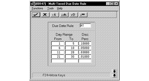

Choose the Add Multi-Tiered Information option.
Figure 24-6 Multi-Tiered Due Date Rule screen
Day Range From
Day Range To
Discount Percent
| From Day | Enter the from day value for the first tier. This must be equal to 1 as it is the first tier. |
| To Day | Enter the day value for the end day of the first tier. This must be greater than the from day value for this tier. There must be no overlaps and no gaps. |
| Discount % - Payment Terms | The percent of the total invoice that will be discounted if the invoice is paid within the discount period specified by the first tier. This is entered as a decimal, for example, a 2% discount is .02. |
