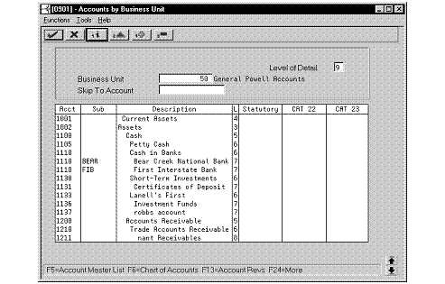

To set up an alternate chart of accounts
On Accounts by Business Unit
Figure 5-1 Accounts by Business Unit screen
Description of Figure 5-1 follows
Description of "Figure 5-1 Accounts by Business Unit screen"

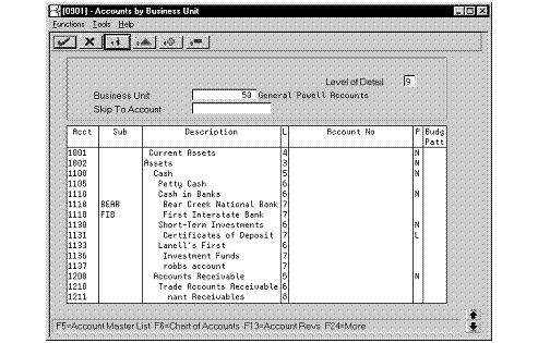

  1. Choose the Expanded Category Codes/3rd Account Formats function.
    Figure 5-2 Accounts by Business Unit (Expanded) screen
    Description of Figure 5-2 follows
    Description of "Figure 5-2 Accounts by Business Unit (Expanded) screen"
  2. To specify a business unit, complete the following field:
    • Business Unit
  3. To enter an alternate chart of accounts, complete the following fields:
    • Account
    • Subsidiary
    • Description
    • Level
    • Category Code 21 (Statutory)
    • Category Code 22
    • Category Code 23

In the Level of Detail field at the top of the Account Structure by BU screen, enter a level of detail (LOD) number. This limits the account information to accounts whose LOD is equal to or greater than the LOD you specify. Leave this field blank to display all LODs. After you press Enter to inquire on a business unit, the level of detail appears in the L field next to each account.
