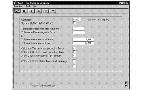

To set up tax rules by company
On Tax Rules by Company
Figure 6-1 Tax Rules by Company screen
Description of Figure 6-1 follows
Description of "Figure 6-1 Tax Rules by Company screen"
  1. Complete the following fields:
    • Company
    • System
  2. To specify the calculation rules for the company, complete the following fields:
    • Calculate Tax on Gross (Including Discount)
    • Calculate Discount on Gross (Including Tax)
    For Germany, verify that the Calculate Tax on Gross and Calculate Discount on Gross fields are both set to yes (Y).
  3. To specify tolerance percentage ranges, complete the following fields:
    • Tolerance Percentage for Warning
    • Tolerance Percentage for Error
  4. To specify tolerance amount ranges, complete the following fields:
    • Tolerance Amount for Warning
    • Tolerance Amount for Error
  5. To further specify tolerance information for the Accounts Receivable system, complete the following fields:
    • Allow Understatement of Tax
    • Calculate Sales Order Taxes on Summary
    • Tax Service Date Selection
  6. Use the Add action.
