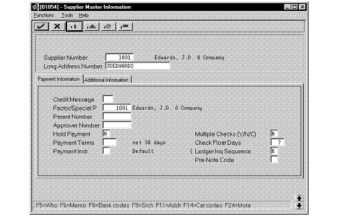

On Supplier Master Information
Figure 11-1 Supplier Master Information screen
Complete one of the following fields:
Supplier Number
Long Address Number
To access the additional information for the supplier, do one of the following:
For a new supplier, use the Add action.
For an existing supplier, use the Change action.

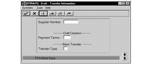

Figure 11-2 Draft - Transfer Information screen
On Draft - Transfer Information, complete the following fields:
Payment Terms
Transfer Type
