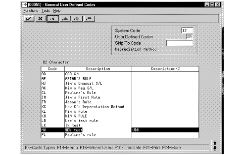

To define depreciation codes for user defined depreciation
On any User Defined Codes screen
Figure 13-1 General User Defined Codes screen
Description of Figure 13-1 follows
Description of "Figure 13-1 General User Defined Codes screen"
  1. To access the user defined codes file for depreciation method, complete the following fields:
    • System Code
    • User Defined Codes
  2. To define depreciation codes, complete the following fields:
    • Character Code
    • Description
    • Description 2

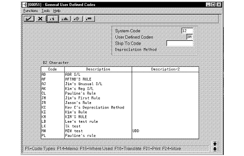

  3. Access the detail area.
    Figure 13-2 General User Defined Codes (Detail) screen
    Description of Figure 13-2 follows
    Description of "Figure 13-2 General User Defined Codes (Detail) screen"
  4. To identify the depreciation method as a user defined method, complete the following fields:
    • Special Handling Code
    • Hard Coded Y/N
