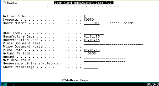

You use the Fixed Asset Additional Data program (P74R1201) to enter information about your fixed assets. The system uses this information when you print legally required documents for fixed assets.
The system opens the screen that you need to complete after you add or modify data in the Asset Master Information program (P1201).

Figure 45-1 Item Card Additional Data RUS screen
To enter additional information for fixed assets
From Item Card Additional Data RUS (P74R1201)
Complete the following fields, as needed:
OKOF Code - Enter the code that identifies the asset in accordance with OKOF.
Date of Manufacturing - Enter the date on which the asset was placed in service.
Date of Modernization - Enter the date on which the asset was upgraded or modernized. You may leave this field blank.
Document Name of Placement - The name of the Acceptance Document (OC-1) defaults.
Document Number of Placement - The legal number of the Acceptance Document (OC-1) defaults.
Date of Placement - The date of the Acceptance Document (OC-1) defaults.
Actual Periods - Enter the number of periods that the asset has been in service.
Amount - Enter the amount the system adds to the actual balance of the associated account balance. Enter negative numbers by entering a minus sign (-) before or after the amount.
Net Book Value - Enter the net book value that the system prints on the Fixed Asset Card.
Membership of Share Holdings - Enter the name of a shareholder for a joint venture.
Share Percentage - Enter the percentage of the asset owned by the shareholder in a joint venture.
Press Enter to display the P74R1202 video.
Presence of Jewels - Enter the description of the precious materials the asset has.
Item Number (short) - Enter the item number related to this asset.
UM - Enter the unit of measure for the precious materials. The unit of measure must exist in the Unit of Measure (00/UM) UDC table.
Actual Weight - Enter the weight of the related precious material.
Item Characteristics - Enter a description of the asset.
Main Item - Enter an eight-digit code that identifies the main asset, if the item contains parts (children).
Remark - Enter a brief description of the main asset.
Child Asset 1 - Enter an eight-digit code that identifies the first part of the asset, if the asset contains parts. You can validate this code with the Item Master if you set the processing options in the Fixed Asset Additional Data program (P74R1201)
Child Asset 2 - Enter an eight-digit code that identifies the second part of the asset. You can validate this code with the Item Master if you set the processing options in the Fixed Asset Additional Data program (P74R1201)
Child Asset 3 - Enter an eight-digit code that identifies the third part of the asset. You can validate this code with the Item Master if you set the processing options in the Fixed Asset Additional Data program (P74R1201)
Child Asset 4 - Enter an eight-digit code that identifies the fourth part of the asset. You can validate this code with the Item Master if you set the processing options in the Fixed Asset Additional Data program (P74R1201)
Press Enter to save the record.

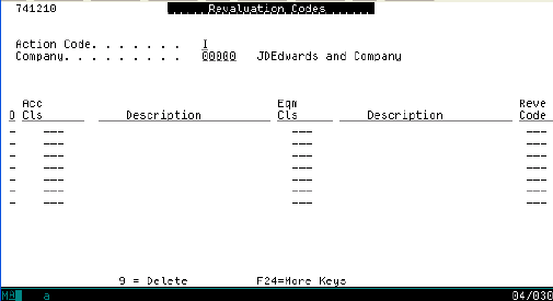

To properly process fixed asset cards, you need to enter a revaluation code for each Category Code combination, for example, accounting class/equipment class, set up in the UDCs. You must define two category codes for each asset and then link these category codes with the revaluation code. The Fixed Asset Card Program selects the revaluation rate based on the revaluation code.
To enter revaluation codes, use P74R1210.
From Revaluation Codes window
In the Action Code field, type I, and then press Enter to view the currently defined revaluation codes.
Change the Action Code to C.
Complete the following fields:
O - Enter the option you wish to perform.
Acc Cls - Enter the accounting class.
Eqm Cls - Enter the equipment class.
Reve Code - Enter the revaluation code to associate with the accounting/equipment class combination. The revaluation codes are defined in the Revaluation Index UDC (12/RI) table.
