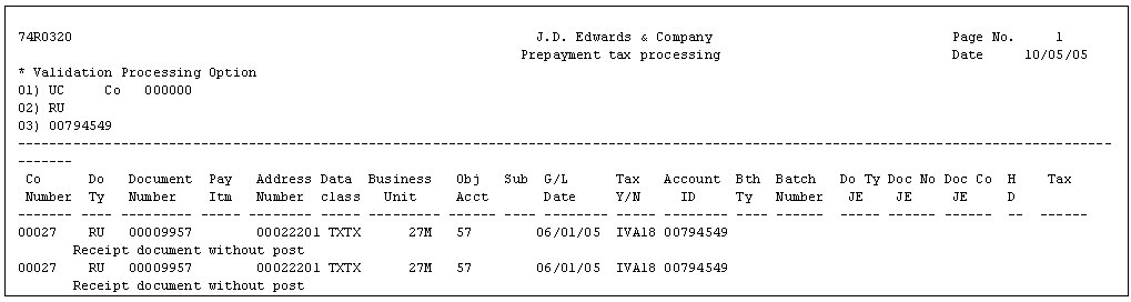

When the prepayment tax journal entries are posted, the system generates the R74R0320 report with information on the transactions processed or with information about the processing errors, if applicable, similar to the following example.
Figure 39-1 Prepayment Tax Processing report
Description of Figure 39-1 follows
Description of "Figure 39-1 Prepayment Tax Processing report"
