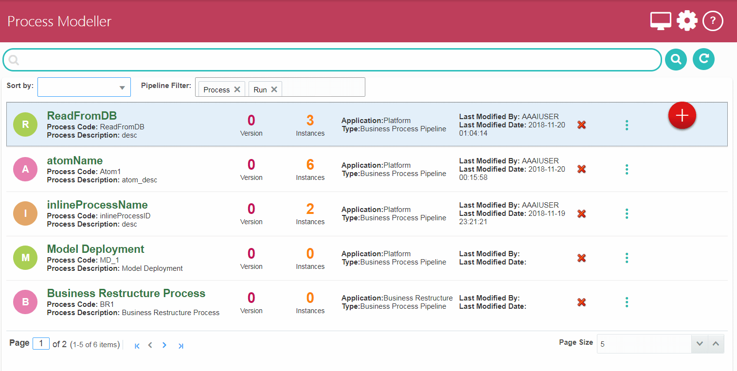

The Process Modeller window displays the existing Business Process Pipelines and Run Pipelines with the details such as Process ID, Process Name, Process Description, Version, Instance, Application, and Last Modified details.
You can do the following tasks from this window:
·       Click  to create a new Pipeline.
·       Click the Process Name link to launch and edit the Process Flow.
·       Click  to delete a Pipeline.
·       Click  to view the following sub menu:
§       Click View to see the process flow.
§       Click Copy to create a new Pipeline with the same process flow.
§       Click Process Flow Monitor to monitor the Pipeline.
§       Click Test Process Flow to test/check whether the Business Pipeline you designed works as expected.
§       Click Execute Run to execute a Run Pipeline.
§       Click Export Process to export a Process.
·       Using the Search grid, you can search for a specific Pipeline by providing a keyword from Process ID, Process Name or Process Description and clicking. Click  to reset the Search fields.
·       You can sort the Pipelines based on Process ID, Process Name, or Application. Click the Sort by drop-down and select the attribute by which you want to sort.
·       You can use Filter Pipeline field to filter pipelines based on pipeline type. For example, if you want to view only Run Pipelines, remove Process from the Filter Pipeline field.
·       Click  to go to Process Monitor window.
