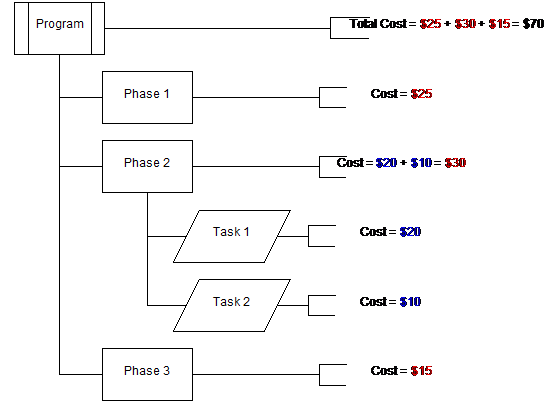

By default, cost information for each field will be rolled up through the project structure such that cost at the summary or parent task is a summation of the cost values of its child objects. If cost (Budgeted Labor Cost and Actual Labor Cost) is incurred at the Summary task level, then the cost is the summation of costs at the summary task level and the child levels below the summary task.There are flags (not visible by default) that can be enabled to allow users to determine whether they want the parent/summary task's values to be calculated/rolled up or edited manually.
As you can see in the example below, if a cost is associated with the leaf node it gets added to the parent node. The total cost of the entire Program can be obtained in this manner.
In this diagram, the cost for Phase 2 is $30, which is the sum of the costs for its leaf-level objects. You can also edit Cost at the parent node level for Phase 2.
