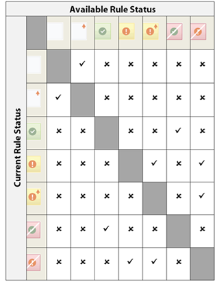

The following table displays which states are accessible for a Rule in any particular state. These are the states you can select by clicking on a cell within the dashboard. The rows represent the current state for a Rule on a particular Site, and the columns represent the potential states for the Rule.
