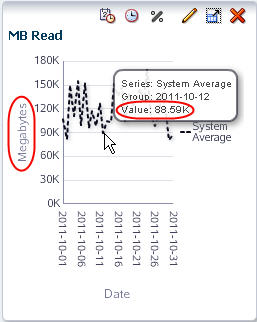

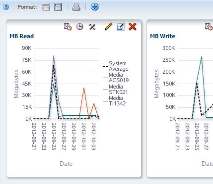

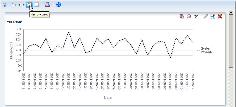

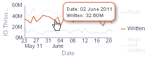

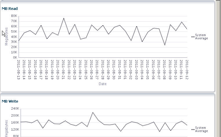

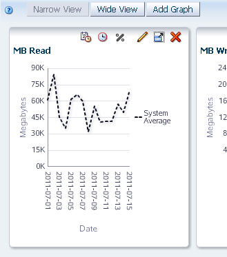

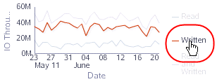

Line Graphs

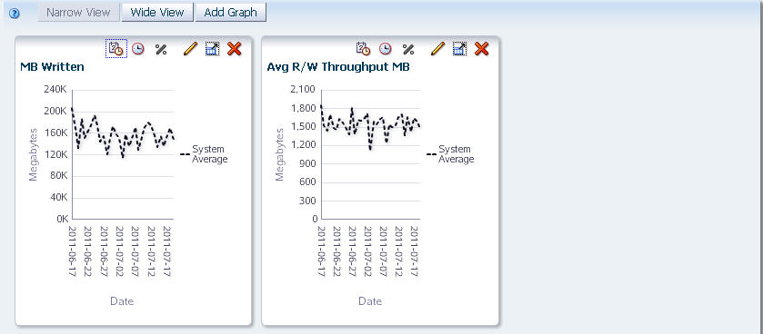

Line graphs are used to compare actual values for one or more resources over a period of time. Each line represents a resource (drive or media) or other category of data. Time is always shown on the horizontal axis. Each point on the line represents an actual value at a point in time. There must be at least two data points available for a line graph; if there is only one data point, the graph will display as a bar chart.
The default date range for most STA line graphs (libraries, complexes, drives, and media) is the last 30 days. For exchanges, the default is one day—the current date.
User Action Description
Display detailed values Move the mouse over a point in time on a line to display the specific value in a tooltip. Other lines on the graph are dimmed. Description of if_linedetail.png follows
Highlight values Move the mouse over an area of the legend to highlight that line on the graph. All other lines remain on the graph but are dimmed. Description of if_linehighlight.png follows

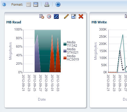

Area Charts
Area charts are used to compare percentage values for two or more resources over a period of time. An area chart is similar to a line graph, but in addition, the area under the line is filled in with a color or pattern. Each line represents a resource (drive or media) or other category of data, and the size of the area under the line represents the resource's percentage of the total. Time is always displayed on the horizontal axis. Each point on the line represents an actual data value at a point in time.
The default date range for most STA area charts (libraries, complexes, drives, and media) is the last 30 days. For exchanges, the default is one day—the current date.
Display detailed values Move the mouse over a point in time on a line to display the specific value in a tooltip. Other sections on the graph are dimmed. Description of if_areadetail.jpg follows
Highlight values Move the mouse over an area of the legend to highlight that section on the graph. All other sections remain on the graph but are dimmed. Description of if_areahighlight.jpg follows

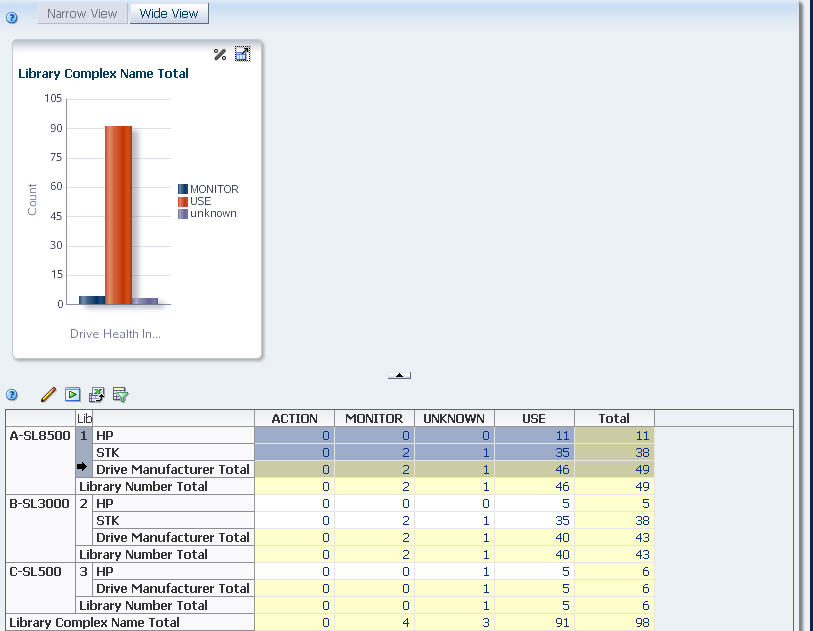

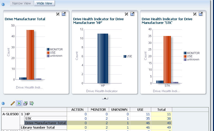

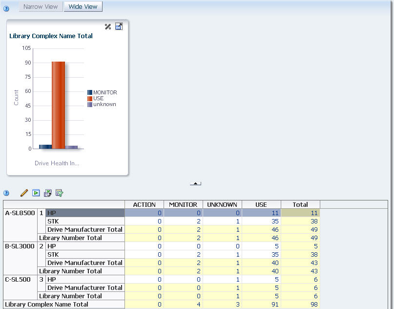

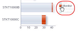

Bar Charts
Bar charts are used to display actual values for one or more resources at a point in time. Each bar represents a resource (drive or media) or other category of data, and the size of the bar represents the resource's actual value.
Display detailed values Move the mouse over a bar to display the specific value in a tooltip. Other bars on the graph are dimmed.
Link to a detail screen Note: This action is available from the Dashboard only.
Click an area of the bar to link to the detail screen for that resource type; in this example, the link is to the Drives –Overview screen. The List View table on the screen indicates that a filter has been applied:
Description of if_barlinktarget.png follows
Highlight values Move the mouse over an area of the legend to highlight that entry in the graph. All other entries remain on the graph but are dimmed. Description of if_barhighlight.png follows

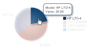

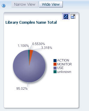

Pie Charts
Pie charts are used to compare percentage values for two or more resources at a point in time. Each section of the pie represents a resource (drive or media) or other category of data, and the size of the section represents the resource's percentage of the total. To be meaningful, pie charts require graphing at least two resources, as only one resource will take up all of the pie.
Display detailed values Move the mouse over a section of the pie to display the percentage value in a tooltip. Other sections of the pie are dimmed. Description of if_piedetail.png follows
Link to an Overview screen Note: This action is available on the Dashboard only.
Click a pie section to link to the Overview screen for that resource type; in this example, the link is to the Drives –Overview screen. The List View table on the screen indicates that a filter has been applied:
Description of if_pielinktarget.png follows

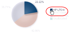

Highlight values Move the mouse over an area of the legend to highlight that entry in the pie chart. All other entries remain on the chart but are dimmed. Description of if_piehighlight.png follows

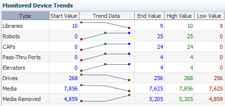

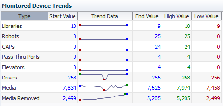

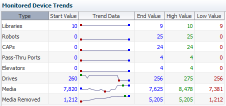

Spark Charts
Embedded spark charts are included in some Dashboard table portlets (see the STA User's Guide for table portlet descriptions). A spark chart is a small line graph that plots up to four key values—Start, End, High, and Low—for a selected date range. Spark charts can help you to see patterns in data values over time.
Depending on the date range selected and the variation among the key values, a given chart may have only two or three dots plotted, rather than four. This is because the dot for one value may hide the other if two key values are close in date and value. Filtering for a shorter date range may reveal more detail.
Figure 3-1 through Figure 3-3 show three different date ranges for the same Dashboard portlet. Because all three ranges use the current date as the end date, the End Values are the same for all. The other key values vary, however, as the start date and relative high and low values are different for each range.
Figure 3-1 Monitored Device Trends Filtered for "Less Than 250 Days Ago"
Description of Figure 3-1 follows
Description of "Figure 3-1 Monitored Device Trends Filtered for "Less Than 250 Days Ago""
Figure 3-2 Monitored Device Trends Filtered for "Less Than 30 Days Ago"
Description of Figure 3-2 follows
Description of "Figure 3-2 Monitored Device Trends Filtered for "Less Than 30 Days Ago""
Figure 3-3 Monitored Device Trends Filtered for "Less Than 2 Days Ago"
Description of Figure 3-3 follows
Description of "Figure 3-3 Monitored Device Trends Filtered for "Less Than 2 Days Ago""

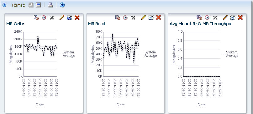

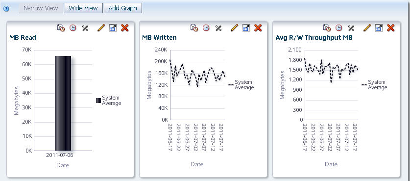

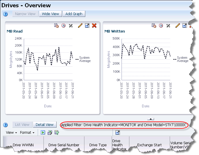

Graphs on Overview Screens
The Graphics Area of Overview screens consists of the Graphics Area Toolbar and one or more graph panes. Each graph pane also has a Graph Pane Toolbar. When multiple graph panes are displayed, they are tiled, up to three per row. You can display up to 15 graph panes at a time.
You can modify the data displayed on individual graph panes through any of the following actions:

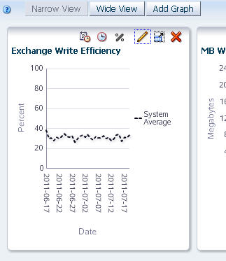

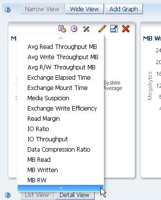

Graphed Attribute
Each graph pane displays values for exactly one drive or media attribute. You can change the displayed attribute by clicking the Change Graphed Attribute icon on the Graph Pane Toolbar and then selecting any of the available attributes for that resource type.
See "Change the Graphed Attribute" for detailed instructions.

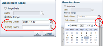

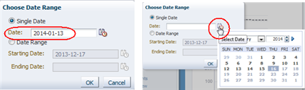

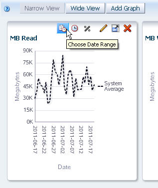

Date Range
By default, most graph panes display values for the previous 30 days. This is a rolling time period which is updated daily. The exception to this is the graph panes on the Exchanges Overview screen, which display values for the current date only.
You can change the date range by clicking the Choose Date Range icon on the Graph Pane Toolbar. You can then specify new start and ending dates for the range or a point in time (one day). Date ranges longer than one day are displayed as line graphs. Point-in-time graphs are displayed as bar charts. See "Change the Date Range" for detailed instructions.
Once you have specified a new date range for an individual graph, you can apply that range to all graphs on the screen by clicking the Synchronize Date Range icon. See "Synchronize a Date Range Across All Graphs" for detailed instructions.

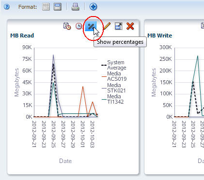

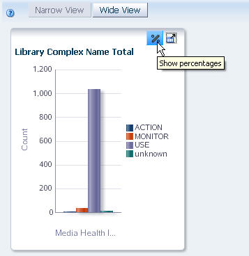

Real and Percentage Values
By default, the graph panes display actual data values. You can optionally switch to a percentage display, which shows individual resource values as a percentage of the whole. Actual values are displayed as a line graph, and percentage values are displayed as an area graph.
You can switch between actual and percentage value displays by selecting the Show Percentages icon on the Graph Pane Toolbar.
See "Switch Between Actual and Percentage Values – Overview Screens" for detailed instructions.

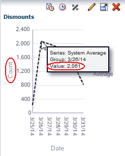

Units of measure are identified on the horizontal and vertical axes of each graph pane. On line and area graphs, which show values over time, time is always shown on the horizontal axis, and the attribute values are shown on the vertical axis. The scale of both axes automatically adjust to provide a useful amount of detail for the values included in the graph.
If the graphed attribute includes a unit of measure, such as MB Read, then the total value of a given data point is the product of the unit of measure included in the attribute multiplied by the unit of measure of the vertical axis. The sample graph panes shown below use different units of measure on their vertical axes.

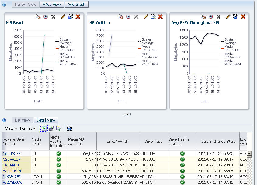

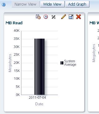

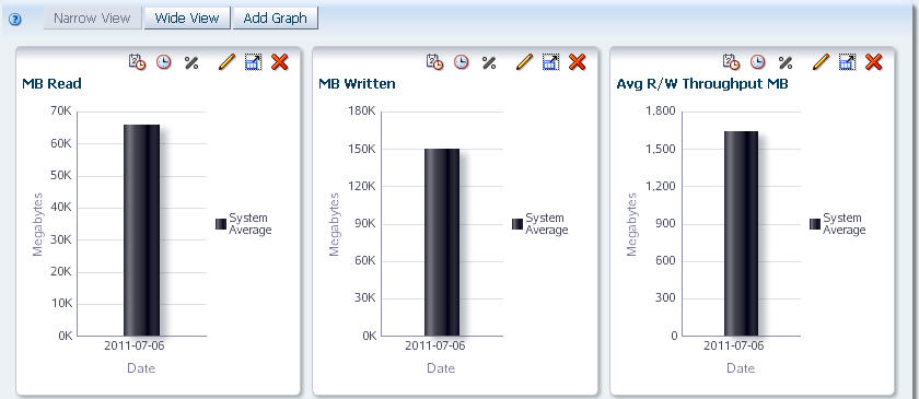

When you first start an Overview screen, the graph panes display only the system average for their selected attribute. You can compare individual resources to each other and the system average by adding the resources to the graphs. You add individual resources by selecting their records on the List View table, and then applying the selection to the graphs. The individual values are then highlighted on the graph, and the system average is ghosted.
You can change the displayed resources simply by selecting different ones and re-applying the selection. If there is no data for a selected resource, no values will appear on the graph, but the resource will be added to the graph key to indicate that it has been selected. When you leave the Overview screen, the selections are cleared, so that when you return, the graph panes again display the system average only.
To clear all resources from the graphs without exiting the screen, you can deselect all records on the List View table, and then re-apply the selection to the graphs.
See "Add Library Resources to Graphs" for detailed instructions.

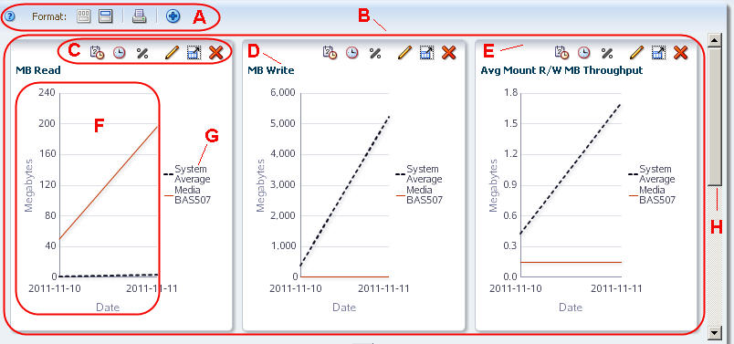

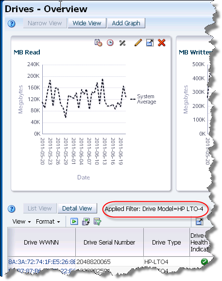

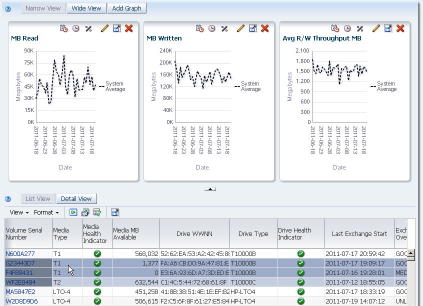

Graphics Area Layout – Overview Screens
Description of if_graphicsovwpane.jpg follows

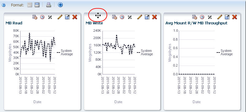

Item Name Description
A Overview Graphics Area Toolbar Provides direct access to commands for managing the Graphics Area. See "Graphics Area Toolbar for Overview Screens" for descriptions of each icon.
B Graphs Graphs are tiled in rows of up to three. Up to five rows can be displayed.
C Overview Graph Pane Toolbar Provides direct access to commands for manipulating the display of this graph pane. See "Graph Pane Toolbar for Overview Screens" for details.
D Graph Pane title Identifies the graphed attribute.
E Graph Pane border Shaded area at the top of the graph pane. Allows you to grab the pane and move it. See "Rearrange Graph Panes" for details.
F Graph Area where the body of the graph is displayed. The horizontal axis is always Date, and the vertical axis is the unit of measure for the displayed values.
G Legend Key to the items included on the graph.
H Vertical scrollbar Appears only if the there are too many graphs to display in one row.

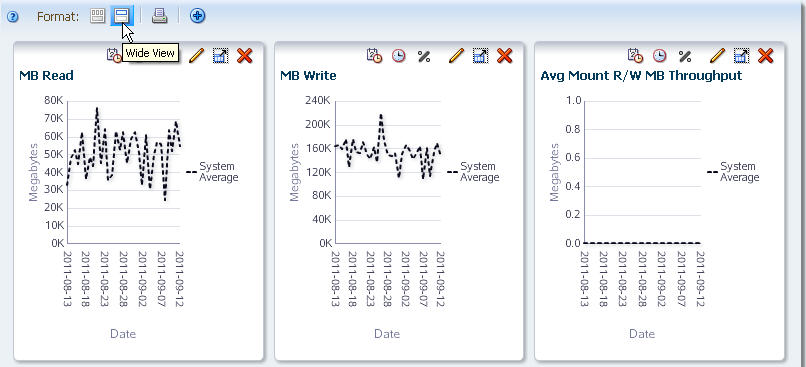

Narrow View icon Narrow View Tiles graph panes across the Graphics Area in rows of up to three graphs each. This is the default view.
Related Topic: "Switch Between Narrow and Wide Views"
Wide View icon Wide View Expands each graph horizontally across the entire Graphics Area with individual graphs stacked vertically.

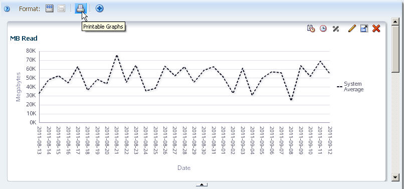

Printable Graphs icon Printable Graphs Provides a "quick print" function. Displays a printable form of the displayed graphs in a separate browser tab or window.
Related Topic: "Perform a Graph "Quick Print""

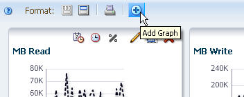

Add Graph icon Add Graph Adds a new graph pane displaying the default attribute to the Graphics Area.
Related Topic: "Add a Graph Pane"
The Overview Graph Pane Toolbar appears at the top of each graph pane on Overview screens. It provides direct access to frequently used commands for modifying the graph pane.
Description of if_toolbargrovw.jpg follows
Icon Name Description
Choose Date Range icon Choose Date Range Displays the date editor, which allows you to change the date range to a new range or a single day.
Related Topic: "Change the Date Range"

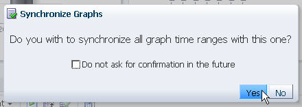

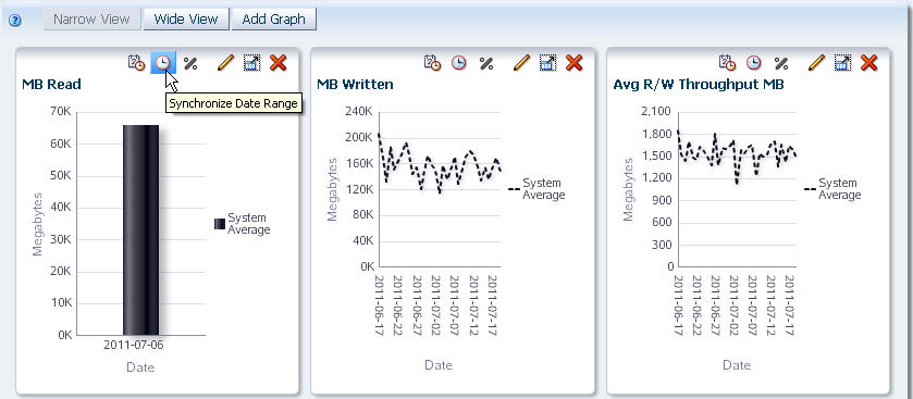

Synchronize Date Range icon Synchronize Date Range Applies the date range for the current graphics pane to all graphics panes on the screen.
Related Topic: "Synchronize a Date Range Across All Graphs"
Show Percentages icon Show Percentages Switches between real value and percentage value displays.
Related Topic: "Switch Between Actual and Percentage Values – Overview Screens"

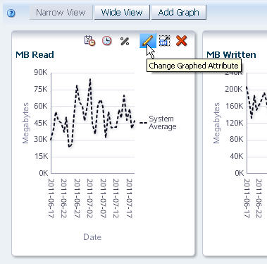

Change Graphed Attribute icon Change Graphed Attribute Allows you to change the attribute displayed on the graph.
Related Topic: "Change the Graphed Attribute"

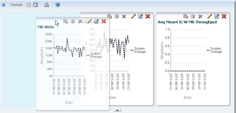

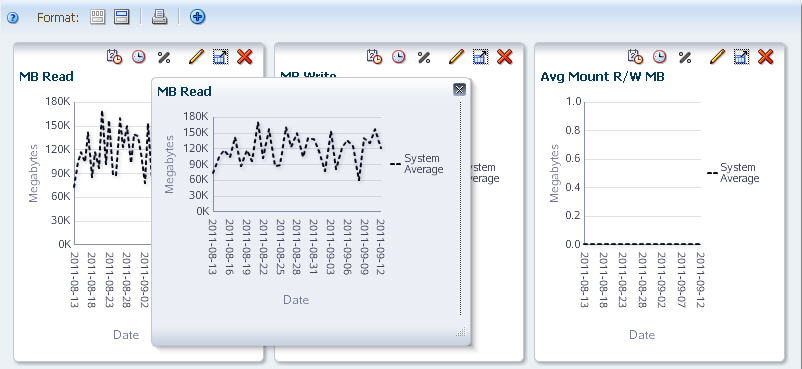

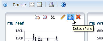

Detach Pane icon Detach Pane Detaches the graph from the screen and displays it in a separate window in the browser foreground.
Related Topic: "Detach a Graph Pane"

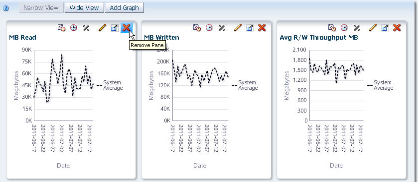

Remove Pane icon Remove Pane Deletes the graph pane from the screen.
Related Topic: "Remove a Graph Pane"

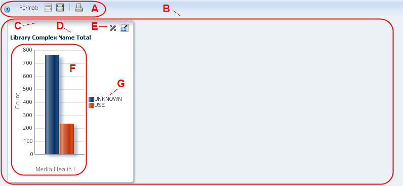

Graphics Area Layout – Analysis Screens
Description of if_graphicsanlyspane.jpg follows
A Analysis Graphics Area Toolbar Provides direct access to commands for managing the Graphics Area. See "Graphics Area Toolbar for Overview Screens" for descriptions of each icon.
B Graphs Graphs are tiled in rows of up to three. Up to five rows can be displayed. The default view shows one graph only.
C Graph pane border Shaded area at the top of the graph pane.
Note: Analysis screen graph panes cannot be rearranged.
D Graph pane title Identifies the graphed attribute.
E Analysis Graph Pane Toolbar Provides direct access to commands for manipulating the display of this graph pane. See "Graph Pane Toolbar for Analysis Screens" for details.

Best Practices for Graph Displays
This section provides tips for using the STA graph displays.
Hiding graphs
The graphs at the top of most Overview screens are often not needed. Use the Collapse Pane button between the graphs and the table to collapse the graphs and make more space for the table. You can save this view as a default template so it is easily applied to the screen.
See "Collapse and Restore the Graphics Area".
System average
The dotted black line shown by default in all graphs shows a summary or average across your tape library system. This provides a good comparative baseline.
See "Individual Records".
Displaying individual values
You can add specific resources (drives, media, and so on) to the graphs by multi-selecting them from the table, and then clicking the Apply icon. This is a powerful tool for comparing resources within your tape library system.
See "Add Library Resources to Graphs".
Synchronizing graphs
You can synchronize date and time ranges on the Overview screen graphs by clicking the Synchronize Date Range icon on each graph. This provides a good way to compare resources across multiple data ranges—you can change the date and time range in one graph and then synchronize the other graphs to it.
See "Synchronize a Date Range Across All Graphs".

Detach a Graph Pane
This procedure applies to both Overview and Analysis screens.
Use this procedure to separate a graph pane from the Graphics Area and display it in a separate window in the browser foreground. Once you have detached a graph pane, you can resize it and move it anywhere within the browser window. You can detach only one pane at a time.
  1. Click Detach Pane in the Graph Pane Toolbar.
    Description of if_graphdetach.jpg follows
    The graph pane is displayed in a separate window in the screen foreground.
    Description of if_graphdetached.jpg follows
    If you navigate to another screen, the pane is automatically closed.
  2. Optionally, you can move or resize the pane as follows:
  3. To restore the graph pane to its normal position, do either of the following:
This procedure applies to Overview screens only.
Use this procedure to rearrange graph panes in the Graphics Area. This procedure can be used in narrow view or wide view.
  1. Move the mouse over the Graph Pane border of the pane you want to move. The Move Object cursor appears.
    Description of if_grpaneselect.jpg follows
  2. Click and drag the pane to its new location.
    Description of if_grpanemoving.jpg follows
  3. Once the pane is near the position you want, release the cursor.
    The pane snaps into place. You do not need to position it exactly.
    Description of if_grpanemoved.jpg follows
Add a Graph Pane
Use this procedure to add a graph pane to the screen. Data is displayed in the new graph according to the following criteria:
  • The graph displays the default attribute for the resource type. For media, the default is Data Mounts; for drives, it is MB Read. You can change the attribute to any available attribute for the resource.
  • If the existing graph panes have all been synchronized to the same date range, the new graph uses the same one; otherwise, the graph uses the system default date range of the previous 30 days.
  • The new graph displays actual values, even if all the existing graphs display percentages.
  • If individual resources have been applied to the existing graphs, the new graph displays the same ones.
  1. Click Add Graph on the Graphics Area Toolbar.
    You can display up to 15 graph panes at a time; once you reach 15, the Add Graph icon is disabled (dimmed).
    Description of if_graphadd.jpg follows
    The graph pane is added to the end of the Graphics Area display. You may need to use the vertical scrollbar to view the graph.
Remove a Graph Pane
Use this procedure to delete a graph pane from the Graphics Area display.
  1. Click Remove Pane on the Graph Pane Toolbar.
    Description of if_grremove.jpg follows
    The pane is removed from the display.
    Description of if_grremoved.jpg follows
    See "Add a Graph Pane" for instructions on restoring the graph pane to the display.
Use this procedure to display graphs in narrow and wide formats. Narrow view is the default, and it allows you to do side-by-side comparisons of graphed attributes. Wide view allows you to see each graph in greater detail.
  1. Click Wide View on the Graphics Area Toolbar.
    Description of if_grwideview.jpg follows
    The display changes to wide view, in which each graph pane is expanded horizontally across the entire Graphics Area. A vertical scrollbar appears, allowing you to scroll down to the remaining panes.
    Description of if_grwide.jpg follows
  2. To switch back to narrow view, click Narrow View in the Graphics Area Toolbar.
    Description of if_grnarrowview.jpg follows
Use this procedure to perform a "quick print" of all graphs currently displayed.
For best results, you might want to display the graphs in Wide View mode. This will allow you to see more detail in the printed graphs.
  1. Click Printable Graphs on the Graphics Area Toolbar.
    Description of if_grprintable.jpg follows
    A new tab is created in your browser window, showing all graphs in a printable format.
    Description of if_grprintabletab.jpg follows
  2. You can use your browser's standard Print function to send this display to a printer.
Use this procedure to change the resource attribute that is displayed in a graph pane.
  1. Click Change Graphed Attribute in the Graph Pane Toolbar.
    Description of if_grchangeattrib.jpg follows
    A menu appears, displaying all available attributes for this resource type. Only 14 attributes are visible at a time. A scroll button at the bottom of the menu allows you to scroll down through the entire list.
    Description of if_grchangeattribmenu.jpg follows
  2. Select the attribute you want the graph to display.
    Description of if_grchangeattribselect.jpg follows
    The graph is updated according to your selection.
Use this procedure to change the date range on a graph pane. You can specify a new range or a point in time (single day).
  1. Click Choose Date Range on the Graph Pane Toolbar.
    Description of if_grdaterange.jpg follows
    The Choose Date Range dialog box appears.
    Description of if_grchoosedated.jpg follows
  2. Complete the dialog box, specifying either a single day or a range of dates.
    • For a point in time, do the following:
      1. Select the Single Date option.
      2. In the Date field, specify the date you want to display. You can type the date manually or click the Select Date icon on the dialog box to display the Date editor and choose the date. The date format is yyyy-mm-dd.
        Description of if_datechooser.png follows
    • For a range of dates, do the following:
      1. Select the Date Range option.
      2. In the Starting Date and Ending Date fields, enter the first and last dates of the range. You can type the dates manually or click the Select Date icon on the dialog box to display the Date-time editor and choose the dates. The date format is yyyy-mm-dd.
        Description of if_rangechooser.png follows
  3. When the date selection is as you want, click OK.
Use this procedure to synchronize all graph panes to the same date range.
  1. In one graph pane on the screen, set the date range you want to apply to all the panes. See "Change the Date Range" for instructions.
    Description of if_grsyncbegin.jpg follows
  2. Click Synchronize Date Range in the Graph Pane Toolbar of that graph pane.
    Description of if_grsyncdaterange.jpg follows
    The Synchronize Graphs confirmation dialog box appears.
    Description of if_grsyncconfirmd.jpg follows
  3. Click Yes to synchronize.
    All graph panes in the Graphics Area are synchronized to display the same date range. All other data display characteristics (graphed attribute, actual versus percentage values, added resources) remain unchanged.
    Description of if_grsyncdone.jpg follows

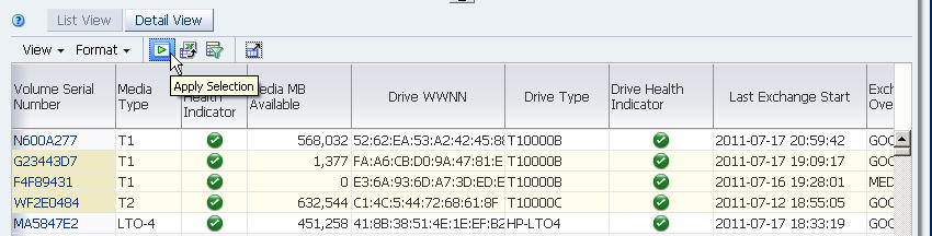

Use this procedure to add selected library resources—such as libraries, drives, media, and so on—to all graph panes on the screen. In the default view, graphs display only the system average for the graphed attribute.
  1. In the List View table, select one or more resources.
    You can use multi-select to select more than one resource; see "Multi-select" for details.
    Description of if_grselectres.jpg follows
  2. Click Apply Selection on the List View Toolbar.
    Description of if_grapplyselection.jpg follows
    The selected resources are added to all graph panes on the screen.
    Depending on the data values for the selected resources, the scale of one or more graph panes may change. The scales of the horizontal and vertical axes automatically adjust to show a useful amount of detail for the selected resources.
    Description of if_grselectapplied.jpg follows
  3. You can change the selected resources, as follows:
    • To remove these resources and add different ones, repeat Step 1 and Step 2, this time selecting different resources.
    • To remove all resources from the graphs and display just the System Average, deselect all the selected resources in the table and click Apply Selection again.

  2. Click Show Percentages on the Graph Pane Toolbar.
    Description of if_grshowpercent.jpg follows
    The graphed values change from actual to percent, and the line graph changes to an area chart.
    Description of if_grpercentvalues.jpg follows
  3. The Show Percentages icon acts as a toggle. You can click it again to switch back to actual values.
Switch Between Actual and Percentage Values – Analysis Screens
This procedure applies to Analysis screens only.
Use this procedure to switch between actual and percentage values on a graph pane. Actual values are displayed by default. Percentage values compare individual resources within a set of selected resources; therefore, displaying percentage values is most useful when at least two resources have been added to the graph.
  1. Click Show Percentages on the Graph Pane Toolbar.
    Description of if_grpercentanlys.jpg follows
    The graphed values change from actual to percent, and the bar chart changes to a pie chart.
    Description of if_grpercentanlysdone.jpg follows
  2. The Show Percentages icon acts as a toggle. You can click it again to switch back to actual values.

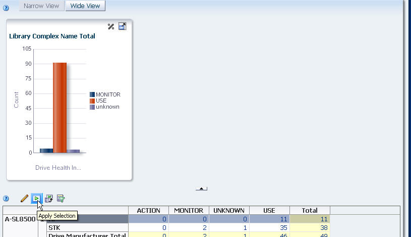

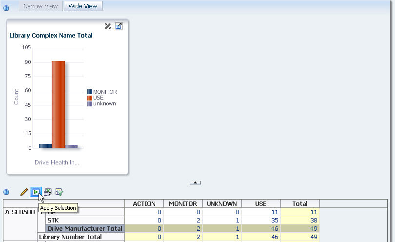

Graph Detail for a Pivot Table Attribute
Use this procedure to graph detail data for a pivot table attribute. This results in just one graph pane in the Graphics Area.
You can graph attributes that appear on the row edge only, and only one row at a time. If you select a column edge attribute, or if you select multiple rows, you will see the error, "Please select one and only one row."
  1. In the pivot table, select a row that shows one value for an attribute.
    In this example, the "HP" value for the Drive Manufacturer attribute is selected.
    Description of if_grselectrow.jpg follows
  2. Click Apply Selection in the Pivot Table Toolbar.
    Description of if_grapplyselectanlys.jpg follows
    The selected attribute value is displayed in a single graph pane.
Graph Aggregated Data From a Pivot Table
Use this procedure to graph aggregated data from a pivot table. This results in multiple graph panes in the Graphics Area: one for the aggregated totals and one each for the attribute values included in the totals.
  1. In the pivot table, select a layer that aggregates multiple attribute values.
    In this example, the nesting layer is "Library Number", which aggregates data for two drive manufacturers: "HP" and "STK".
    Description of if_grselectnesting.jpg follows
    Description of if_grapplysummary.jpg follows
    The Graphics Area is updated as follows:
    • The left-most pane shows the summary data for the attribute.
    • The panes to the right show detail for each attribute included in the aggregation, one pane per attribute. In this example, there are two detail panes: one for "HP" and one for "STK".
      Description of if_grapplysummarydone.jpg follows
