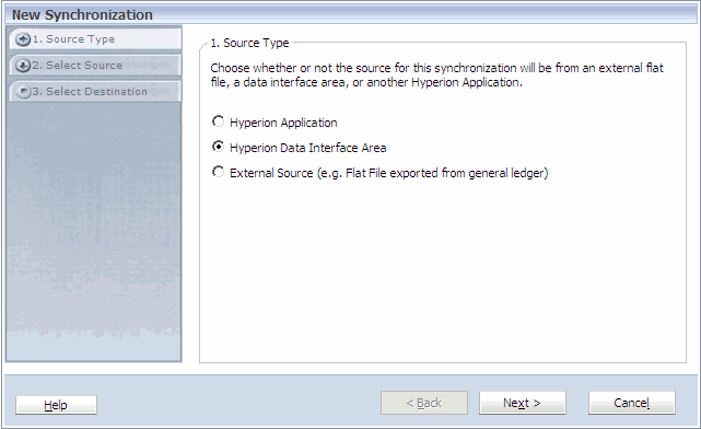

From the Data Synchronizer, select File, New, Synchronization.
Select Hyperion Data Interface Area.
Click Next.
