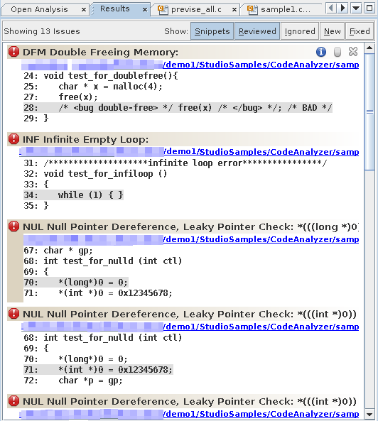

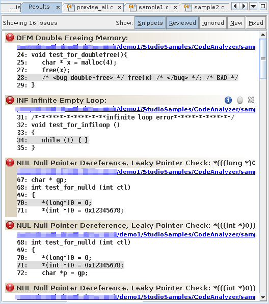

The Code Analyzer GUI opens and the Results tab displays the static code issues found during compilation. The text at the top left of the Results tab indicates that thirteen static code issues were found.
For each issue, the tab displays the issue type, the path name of the source file in which the issue was found, and a code snippet from that file with the relevant source line highlighted.

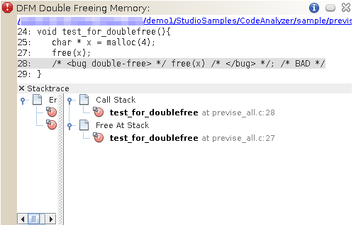

To see more information about the first issue, a Double Freeing Memory
error, click the error icon
The stack trace for the issue opens displaying the error path:

Click the same error icon to close the stack trace.

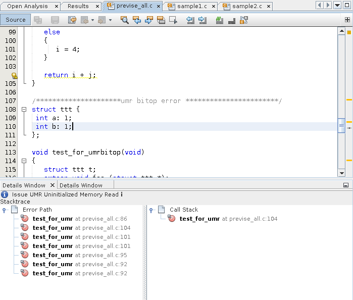

The error path for this issue contains many more function calls than the one for the Double Freeing Memory issue.
Double click the first function call.
The source file opens with that call highlighted. The error path is displayed in a Details Window below the source code.
Double-click the other function calls in the error path to follow the path through the code that leads to the error.

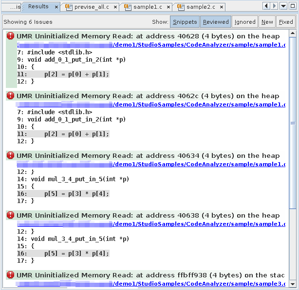

Run the instrumented binary to collect the dynamic memory access data.
$ ./a.out
The dynamic memory access error data is written to the sample/a.out.analyze/dynamic directory.
Start the Code Analyzer GUI to view the results.
$ code-analyzer a.out &
The Results tab shows both static issues and dynamic memory issues. The background color behind an issue description indicates whether it is a static code issue (tan) or a dynamic memory access issue (pale green).

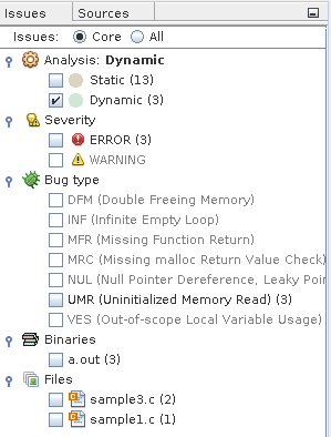

To filter the results and show just the dynamic memory issues, select the Dynamic option in the Issues tab.
The Results tab now shows just the three core dynamic memory issues.
To see all of the dynamic memory issues, select the All radio button at the top of the Issues tab. The Results tab now displays six dynamic memory issues.
Look at the three issues that were added to the display and see how they are related to the core issues. Fixing the cause of the first issue in the display is likely also to eliminate the second and third issues.

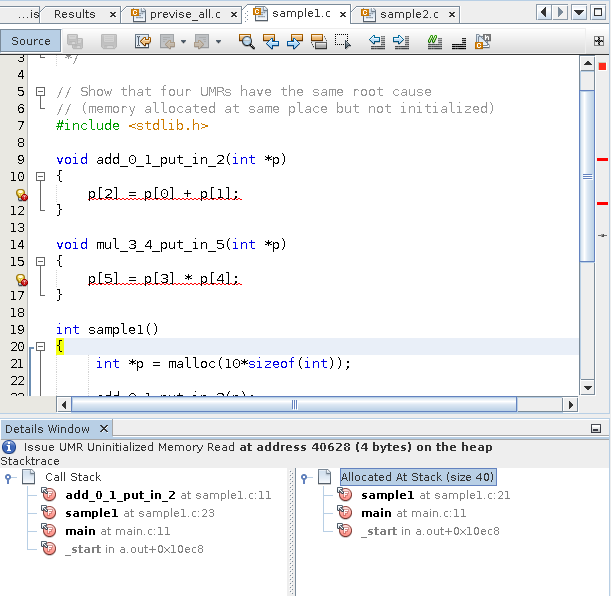

Investigate the first issue by clicking the error icon to display the stack trace.
For this issue, the stack trace includes the Call Stack and the Allocated At Stack.
Double-click function calls in the stacks to see the associated lines in the source file.
When the source file opens, the stack trace is displayed in a Details window below the file.

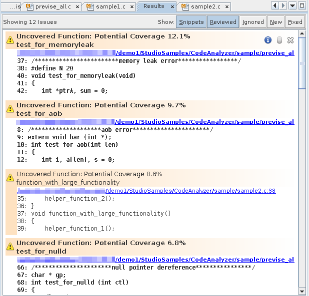

To filter the results and show just the code coverage issues, select the Coverage option in the Issues tab.
The Results tab now shows just the twelve code coverage issues. The description of each issue includes a potential coverage percentage, which indicates the percentage of coverage that will be added to the total coverage for the application if a test covering the relevant function is added.
at the top of the Results tab to hide the code
snippets.
In the Issues tab, nine of the coverage issues are in the previse_all.c source file, three are in sample2.c, and one is in previse_1.c.

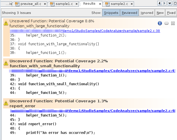

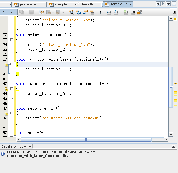

To show just the issues for the sample2.c file, select the option for that file on the Issues tab.
The Results tab now shows just the three code coverage issues found in sample2.c.
Open the source file by clicking the source file path link in one of issues. Scroll down in the source file until you see the warning icons in the left margin.
Code that is not covered is marked with a yellow bracket.
The coverage issues found in the file are marked with warning icons
