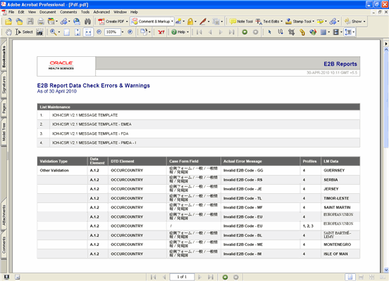

Running an E2B check validates if the E2B report has all these mandatory elements present that is required for its successful processing.This check performs the function that prints the ”E2B Report – DTD Length Check Warnings” and ”E2B report – DTD Validation”.
The following illustration shows a sample E2B check report that is generated in PDF format:
Surrounding text describes pdf2.gif.
As can be seen in the PDF, the sample report displays the case form fields where the validation error has occurred.
Apart from the case form location where the error occurred, the report lists the type of error, data elements, DTD elements, the actual message/cause of the error, and the profiles which were tested for each validation type.
