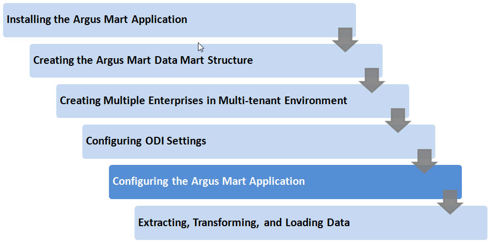

The following figure depicts your progress in the complete installation process:
Figure 6-1 Installation Progress: Configuring the Argus Mart Application
Surrounding text describes Figure 6-1 .

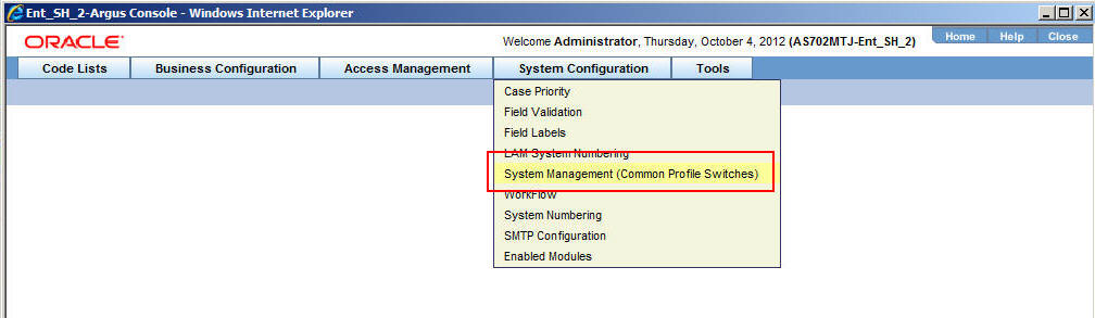

  1. Log on to the Argus Safety Console and navigate to System Configuration > System Management (Common Profile Switches).
    Figure 6-2 System Management Link on Argus Safety Console
    Surrounding text describes Figure 6-2 .
