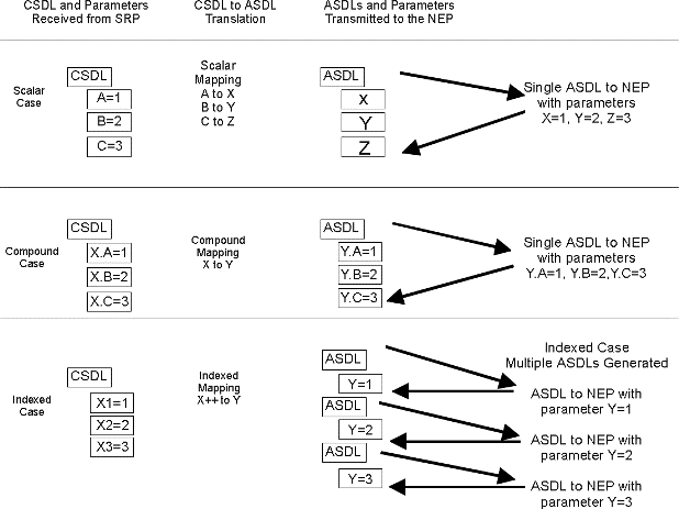

Each atomic action has parameters that are sent to the NEP by the atomic action. The parameters determine whether the SARM transmits a particular atomic action.
tbl_asdl_parm is a Static Table that is used by the SARM to define the parameter labels and values associated with a given atomic action. It also provides the mapping between the service action parameter labels received from the service request processor (csdl_lbl) and the atomic action parameter labels (asdl_lbl) transmitted to the NEP for interpretation by the Interpreter State Tables.
For each service action label (csdl_lbl), the SARM checks the current service action parameter name-value pairs for a matching label. If no matching label is found, it checks for a label in the work order global parameter name-value pairs. If no matching label is found in either of these parameter name value pairs and the parameter type (param_typ) which is mandatory, the default value (default_vlu), is used.
If no default value is set, the SARM registers an atomic action parameter mapping failure. If the parameter is indexed, the csdl_lbl must contain a ++ or the SARM will not start.
Atomic action parameters can be one of the following types:
R: required scalar
O: optional scalar
C: required compound
N: optional compound
M: mandatory indexed
I: optional indexed
X: required XML
Y: optional XML
P: required XPATH
Q: optional XPATH
+ –: the current index value for this atomic action. Only applicable to indexed atomic actions.
You can create, modify, or delete new runtime parameters, specify the parameter type, and specify whether the parameter is optional or mandatory using the Design Studio Data Schema editor. See Oracle Communications Design Studio Help references for the Activation tab and the Details tab for the ASAP Data Schema editor.You may use a data dictionary with ASAP in the following two scenarios:

Scalar parameters are conventional name-value pair parameters.
   Service Action      C-ADD_FEATURE
        PARM  NE_ID   NEWYORK
        PARM  LEN     2111112
        PARM  LATA    516
        PARM  LCC     555

These parameters contain a sequential numerical index value to tell the SARM that it should execute the same operation (for example, an atomic action) for all occurrences of that index. Consequently, if there are several options on a particular service action command (OPT1, OPT2, OPT3, etc.), you can specify the OPT parameter as an indexed parameter. When you specify the OPT parameter as an indexed parameter, the SARM generates several occurrences of that same atomic action, and each command has a different value for the option being transmitted to the NEP.
If there are 100 such indexed parameters on the service action command, the SARM transmits the same atomic action 100 times. Each time the SARM transmits the atomic action, the parameter has a different option value.
If an indexed parameter is configured to be transmitted on a given atomic action, only one indexed parameter value is transmitted with each atomic action, and the same atomic action is executed repeatedly.
For instance, if the work order contains:
OPT1 = 3WC
OPT2 = CWT
And the service action-to-atomic action mapping contains the following:
Service Action Parameter Atomic Action parameter ------------------------ ------------------------- OPT[++] OPTION
By convention, the ++ notation appears at the end of the label within square brackets. This convention makes it easy to identify the index.That particular atomic action is executed twice. The first time, the atomic action has an OPTION parameter with the value 3WC. The second time, the atomic action has an OPTION parameter with the value of CWT.

Compound parameters contain structures or arrays of information that are represented by a particular structure name or compound parameter name. Each compound parameter can contain a large number of elements. If you use compound parameters, you only require a single entry in the ASAP translation tables to call the compound parameter and all its associated parameter elements.
If you configure a compound parameter to be transmitted on an atomic action, ASAP transmits all elements for the compound parameter to the NEP at the same time.
In the case of compound parameters, the base name of the parameter on the work order must be exactly as specified in the tbl_asdl_parm and the base name must not have a period in it.For example, if there is a compound parameter with the base name CMPNDPARAM specified in the tbl_asdl_parm as type C, you can define a work order with the following parameters:
CMPNDPARAM1=value1 CMPNDPARAM2=value2 CMPNDPARAM3=value3 CMPNDPARAMABC=value4
A compound parameter can be used by selecting parameter type C or N. A compound parameter (whether it is indexed or not) does not trigger the multiple execution of the same atomic action.
The following formats are supported for compound parameters:
Format 1 – Suffix cannot contain a period. For example:
BasenameSuffixA
BasenameSuffixB
BasenameSuffixC
Format 2 – a period comes directly after the basename. For example:
Basename.SuffixA
Basename.SuffixB
Basename.SuffixC
The basename must match the name defined in tbl_asdl_parm.To create a compound parameter using Design Studio:

The compound parameter can have an index. If using a compound indexed parameter, the parameter type must be C. The following format is supported for only indexed compound parameters.
Basename[1].Suffix
Basename[2].Suffix
Basename[3].Suffix
You can define compound parameters and indexed parameters at the same time. This allows for the specification of multi-dimensional data elements.
For an example of a compound indexed parameter, see "Scenario 4 – One Service Action to Multiple Atomic Actions Routed to Multiple NEs".Avoid the use of compound parameters unless absolutely necessary. Using compounds makes the SARMs error checking capability far less effective and makes order entry through Order Control Application (OCA) more difficult. When multiple sets of parameters that have variable numbers of elements must be passed to the same implementation method for provisioning, a compound parameter with an associated index can be used (the index is purely for logical representation of the data and should not be confused with the atomic action indexing capability in ASAP). For example, a Java method that provisions multiple features in an optimized manner could be passed a compound structure containing variables as shown:
FEATURE[1].NAME = 3WC FEATURE[2].NAME = CFD FEATURE[2].NUM_RINGS = 5 BLOCKED_NUMBER[1].PATTERN[1] BLOCKED_NUMBER[1].PATTERN[2]
Whenever an index is used within an atomic action parameter label, the index is encapsulated within brackets (regardless of the type of ASAP parameter):
SUD[1].CODE = A SUD[1].VALUE = 1 SUD[2].CODE = C SUD[2].VALUE = 7

You can group ASAP scalar parameters in Design Studio by using the structured schema element feature. The structure element is a container that holds ASAP parameters. For example the following scalar groups can be defined using two levels of structure elements:
Structure element1
     Structure element2
              Scalar1
              Scalar2
Structure element3
     Structure element4
              Scalar3
              Scalar4
In a real world scenario, these structure could be as follows:
Person
     Name
         First_name
         Last_name
Place
     Address
         Number
         Street
The structure elements used in Design Studio are converted into individual ASAP scalar parameters by absorbing the structured element names into the scalar parameter name. The example used above describing a person and place would by default look as follows as ASAP parameters:
Person_Name_First_name Person_Name_Last_name Place_Address_Number Place_Address_Street
The default character used to separate the elements in the ASAP parameter names is the underscore (_). It is possible to change this character. See Design Studio for more information.
