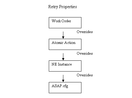

Because different NEs often have different retry requirements, it is necessary to provide a flexible retry mechanism that enables retry properties to be specified at the NE instance level and at the atomic action level (this is in addition to the ability to configure a single set of system-wide retry properties, which apply to all atomic actions and all NEs that trigger a retry).
Flexible retry configuration in ASAP enables specification of retry properties in the following locations:
ASAP.cfg: This configuration file contains values for the Number of Retries and the Retry Interval, which will be used whenever a retry occurs, on any NE or atomic action, if no other values are configured elsewhere.
Work Order: If the Number of Retries and Retry Time Interval are specified on a work order, these values will override those defined elsewhere in the system (including the ASAP.cfg: file, atomic action level, or NE instance level).
Atomic Action: If you specify the Number of Retries and Retry Interval at the atomic action level, and a retry is encountered on any of the action processors mapped to that atomic action, the values you specify will be used. These values will override those defined at the NE instance level and at the ASAP.cfg: level.
Network Element Instance: If you specify the Number of Retries and Retry Interval on the Network Element editor, any command triggering a retry against this NE instance will use the retry values you specify. These values will override those defined at the ASAP.cfg: level.
NE Template: If you specify the Number of Retries and Retry Interval on the NE Template editor, any NE created from the template will inherit the retry values you specify.
Dynamic NE Template: If you specify the Number of Retries and Retry Interval on the Dynamic NE Template editor, any NE instances dynamically created using the template will inherit the retry values you specify. These values will override those defined at the ASAP.cfg: level.

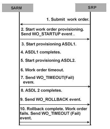

Delayed Failure properties instruct the SARM to continue provisioning an order until the Order Delayed Failure Threshold is reached and the order is failed. These properties are work order properties.
Table 5-2 Delayed Failure Properties
| Property | Description |
 Delayed Failure Property  |
 Requests the SARM to treat all hard errors on atomic actions as Delayed Failures. The SARM skips any subsequent atomic action in the service action, continues provisioning at the next service action, and then fails the order. You can use the Delayed Failure property to override the ASDL_EXIT configuration in the State Table program or Java method. This property should only be set when there are no dependencies on subsequent service actions on the work order. Upon hard failure of an atomic action, the associated service action is failed by ASAP, even if the Delayed Failure property is set.  |
 Order Delayed Fail Threshold  |
 Specifies the number of delayed failures that a particular order can have before the order is explicitly failed. This property is intended for batch orders.  |
Rollback must be turned off for delayed failure to work.

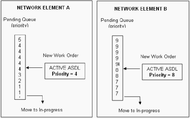

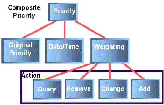

The composite priority mechanism ensures a balance between maximizing throughput and the need to provision higher priority atomic actions over those with lower priority. This mechanism does not guarantee the explicit sequential execution of work orders. Rather, it is designed to ensure that high priority orders are not impeded by lower priority orders that are in progress at the same time. ASAP will use any available processing power to activate orders, and does so by activating many orders in parallel across many network devices.
After orders are placed in the in-progress queue, each atomic action on the order inherits the work order properties including the due date and time, order priority and action. These attributes are used to determine where the atomic action should be placed in the pending queue but do not guarantee that it will be provisioned in advance of any other atomic action. The following diagram shows the importance of the attributes (from left to right) in the prioritization of the atomic action. Details of the algorithm are explained in the main flow of the use case.
ASAP maintains one pending queue for each NE. Many orders are processed at the same time but only a single atomic action is active for each order at any given time due to the serial nature of atomic action processing within an order. In other words, if there are 100 orders in progress, there are 100 active atomic actions. While ASAP is processing a high priority atomic action for one work order, atomic actions from lower priority orders will also be processed against different NEs. ASAP retrieves future-dated orders from the database based on their due date/time, and subjects these orders to composite prioritization at the atomic action level. When a work order is submitted to ASAP, it is subject to BATCH_SLEEP_INTERVAL, which is the time period between SARM database queries for orders that have become due.
Composite priorities operate as follows:
A work order is submitted into ASAP with the following attributes:
Due date and time
Priority
Action (query, remove, change or add)
When the order arrives at its due date and time and BATCH_SLEEP_INTERVAL expires, its first atomic action, referred to as the active atomic action for the purposes of this example, is inserted into the pending queue according to the following algorithm:
Search through the pending queue comparing the priority of the active atomic action (as inherited from the work order) to those already in the queue. If there are no atomic actions with identical priorities insert the atomic action into the queue according to its priority (in other words, an active atomic action with a priority of 4 is inserted behind an atomic action with a priority of 3 but ahead of an atomic action with a priority of 6 – the lower the number, the higher the priority and hence the closer to the front of the pending queue) and proceed to step 3.
For the subset of atomic actions in the pending queue whose priorities match the active atomic actions priority, ASAP examines the due dates and times of each and inserts the active atomic action into the queue according to its due date and time. In other words, the active atomic action is inserted behind atomic actions with older due dates and times but ahead of atomic actions with newer due dates and times. atomic actions with older due dates and times are closer to the front of the pending queue. Go to step 3.
For the subset of atomic actions in the pending queue whose priorities and due dates and times match the priority and due date and time of the active atomic action, insert the atomic action into the pending queue according to its action. An active atomic action with an action of ”Query” is inserted ahead of atomic actions with other actions. The priority of the action from highest to lowest is Query, Remove, Change, Add.
Eventually the atomic action is moved to the in-progress queue where it provisions and completes. While the SARM is being notified that the atomic action has completed an idle connection is detected and another atomic action may be scheduled.
If the active atomic action is placed in the retry queue, the retry timer starts. During the time the active atomic action remains in the retry queue other atomic actions may be scheduled.
When the retry time interval expires and the atomic action is placed back in the pending queue, step 2 is repeated.

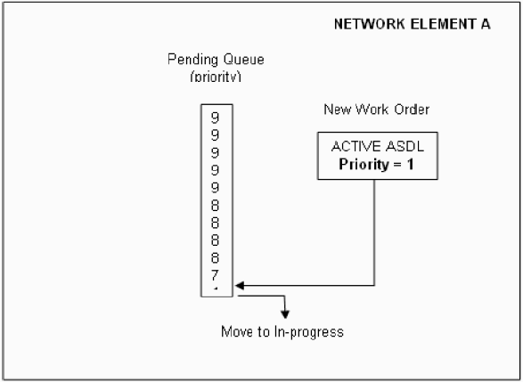

Figure 5-3 shows multiple pending queues (one for NE A and one for NE B). NE A has many high priority atomic actions (for example: priority 1, 2) in its pending queue while NE B has many lower priority atomic actions (for example priority 7, 8, 9) in its pending queue. Because there only low priority atomic actions in NE Bs pending queue, these will be provisioned at the same time as the high priority atomic actions on NE As pending queue.
The following diagram shows a single queue containing low priority atomic actions when a high priority atomic action arrives. The high priority atomic action is inserted ahead of all lower priority atomic actions in the pending queue and as a result will be placed in-progress before any of the others. When the high priority atomic action has completed, the SARM must be notified and an idle connection will be detected. At this time another atomic action (possibly of greater, equal or lower priority) may be scheduled (for example: in this example the atomic action with priority 7).

In this example, the work order has one service action with three atomic actions. The expected result is that the work order fails after exceeding the time specified in the wo_timeout parameter on the work order and all completed atomic actions are rolled back.
SRP submits work order to the SARM for provisioning.
The SARM starts provisioning the work order and sets the timer for work order timeout based on the timeout value. The SARM sends a WO_STARTUP event notification to the SRP.
The SARM starts provisioning the first atomic action in the work order.
The first atomic action is successfully provisioned.
The SARM starts provisioning the second atomic action in the work order.
While provisioning the second atomic action, a work order timeout occurs.
The SARM sends a WO_TIMEOUT (Fail) event notification to the SRP. The SARM resets the timer to zero and waits until the second atomic action completes.
When the second atomic action completes (with a Success or Fail status) all successfully completed atomic actions are rolled back.
The SARM sends a WO_ROLLBACK event notification to the SRP.
Rollback completes and the work order is failed. The SARM sends a WO_TIMEOUT (Fail) event notification to the SRP. The SARM may also send a WO_FAILURE event notification to the SRP.
