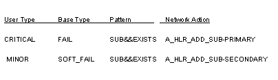

Problem: The customer has a network in which each HLR (referred to as a primary HLR) has a backup HLR (referred to as a secondary HLR). Services must be activated on both HLRs but if activations fail on primary HLRs the work order must be failed; if activations fail on secondary HLRs they must be soft failed.
Solution: Create different atomic actions that map to the same implementation. Configure two user-defined exit types that include the atomic action names in the configuration. Configure the base type for the primary atomic action with FAIL. Configure the base type for the secondary atomic action with SOFT_FAIL. The service model for this configuration is shown in the following diagram:
The user-defined exit type configuration is shown as follows:
In this example, whenever the response from the network element contains the strings SUB and EXISTS and the atomic action is A_HLR_ADD_SUB-PRIMARY, then a failure is triggered. Whenever the response from the network element contains the strings SUB and EXISTS and the atomic action is A_HLR_ADD_SUB-SECONDARY then a soft failure is triggered.
