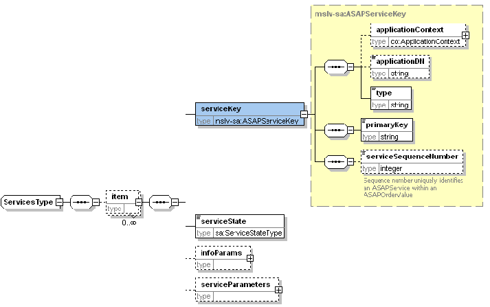

The ServicesType tag includes details on services for a work order, except those that failed. As shown, each service inside the ServicesType tag includes a tag serviceState, which contains the state of the service.
The information parameters (infoParams) and service parameters (serviceParameters) are shown within the related service (instead at the order level as with previous releases).
