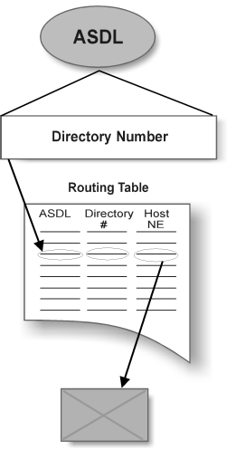

If the remote NE is not identified in the service action command, the host NE is determined by the directory number specified in the atomic action. The directory number consists of the NPA, NXX, and Line. Figure 6-2 illustrates this routing.

Atomic actions are routed through a directory number (DN) identifier. The DN is identified on the work order and is passed to an atomic action as a parameter. Figure 6-3 illustrates atomic action routing by DN.
Depending on your telecommunications situation, you may require routing based on different parts of the phone number/atomic action combination; for example, NXX and the first two digits of the line number.
An atomic action instance will be routed according to the DN/atomic action routing table if the atomic action parameter MCLI is set to SKIPCLLI on the work order. This value implies that the remote NE information is not known.
