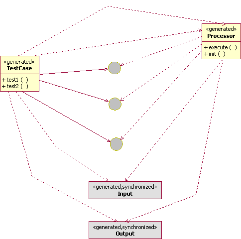

You can use the action processor to auto-generate Java files with classes and methods configured for the protocol and attributes you selected. The auto-generated code are code stubs that provides a logical framework where you must include your business logic for sending and receiving responses.
The Java with code generation implementation for an action processor creates a Java processor that composes messages to be sent to a device, evaluates the response for errors, extracts output information from the response, and populates the information into output parameters.
Figure 12-1 shows some of the auto-generated files, whether they are synchronized, and how they relate to each other.

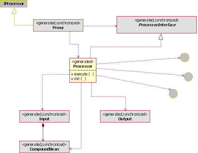

When you configure the action processor to auto-generate Java code stubs, the central class is the Processor. You must add business logic to this class. The Processor is created only once. The processor includes sample code based on the associated atomic action parameters at creation time. You should delay creating the processor until the action processor is associated with an atomic action that has fully defined parameters. If parameters are not yet defined or the action processor is not yet associated with the atomic action, then the generated sample code will be incomplete and will require additional coding.
Synchronized classes or interfaces are rebuilt every time you save changes to atomic action parameters (for example, classes and interfaces are synchronized with the model and reflect the model). Therefore, you should never make code changes to any synchronized class or interface. Design Studio overwrites the code when you run the next build (with changes in the model). You should write code only for the Processor class.There are 2 methods in the Processor:
execute
init
The main method is execute. When called, it is provided with the following:
A number of classes to perform operations.
An input class that contains all input parameters.
An output class to populate the output parameters.
Access to a logger.
An implementation of the exit type to match responses against user-defined exit types and to set the exit type for the processor.
Access to the Connection Handler to send requests and get responses from a connected device.

The InputBean returns another bean that represents the compound if the parameter is a compound parameter with named members,. The returned bean has convenience methods to get the members within the compound. A compound bean for every defined type of compound parameter is created. You also get a set of instances of these beans based on the work order (you get a list of these). If the compound parameter does not have named members, it provides a vector of the members.
Specify the compound members whenever possible. Indicating the members will simplify the coding required and eliminate possible code to mode synchronization issues.Multi-instance Compound parameters start at index one (e.g. CMPD[1]).
Bracket type (Index Parameter Identification Tokens) and delimiter (Indexed Parameter Delimiter) settings are configured on the Project editor Cartridge Locations tab in the Code Generation area. Design Studio applies these settings to all generated code within the cartridge. The following examples assume the defaults (square brackets with a period delimiter).

The proxy:
The proxy creates the input, the output, and the exit type classes.
The proxy populates the exit type classes and initializes them.
The proxy creates the processor that will be called and initializes it.
If the logger needs to be used by the processor, the proxy provides this during the init method call.
The proxy invokes the processor by calling the execute method with the input, output, connection, and exit type.
The processor obtains parameters from the InputBean to compose a message or command to be sent to a device.
The processor calls the send request to send that message to the device.
The processor sets the exit type based on the response.
The processor sets output parameters based on the response.
The processor may parse the response to obtain additional values for populating the output parameters.
The proxy cleans up the processor.
The proxy looks at the exit type that was set and populates it for return to the NEP, and cleans up the exit type.
The proxy extracts all output parameters for return to the NEP and to populate the work order.
The proxy then cleans up this class and (16) the remaining classes.

The unit test framework initiates all tests in test subfolder. Unit testing is implemented as a JUnit test. JUnit tests can optionally be run with the JDT Debugger.
Figure 12-2 shows the generated test case and how it relates to the processor, input, and output files.
The TestCase simulates the proxy for each individual test, and:
Creates an implementation of the interfaces, either the real implementation or a stubbed test implementation.
Generates input and output beans.
Invokes the processor.
The TestCase is a JUnitTestCase. Each TestCase can contain many tests, and each test is defined by a no-parameter method beginning with "test".
The generated TestCase has a framework that provides a test. The test runs based on input files, which find the data and test criteria for a particular test. This framework enables developers to create simple files to define new tests. This works for any standard type of test where you pass in data and check the request to ensure it was sent as expected, and that the returned exit type is the one you expected. Also, this allows for a simple, standard response to be used inside the test.
Sample test classes are provided for simulating IExit and ILogger. A base output class provides the methods required for output classes.
Run the TestCase class as a JUnit test, or as a Java application. Running as a JUnit test provides a richer user experience by providing results in the JUnit view. Running as a Java application allows the TestCase to be run as part of an automated test framework. Java application test case results appear in the Eclipse IDE in the Console view.
