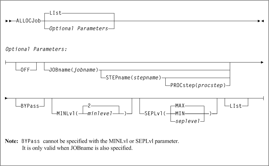

The SMC ALLOCJob command enables you to override SMC default allocation parameters by job name, step name, and PROC step.
The SMS parameter is no longer supported for this command. If necessary, code your SMS ACS routines to select jobnames.As shown in Figure 2-2, the ALLOCJob command includes the following parameters:
optionally, lists current default allocation settings and override settings (in the order they are processed) by job name, step name, and PROC step.
LIst is the default when no parameters are specified on the ALLOCJob command.
LIst may be specified with other parameters. In this case, the LIst is generated after the other parameters are processed.
optionally, removes all job name, step name, and PROC step overrides for allocation.
If no other parameters are specified, allocation overrides are removed for all jobs.
If only JOBname is specified, allocation overrides are removed for ALL ALLOCJob entries for that job name.
If JOBname, STEPname and PROCstep are specified, allocation overrides are removed only for the specified entry.
Global allocation settings are not affected by this parameter.
optionally, specifies a job name. This parameter is required unless LIst or OFF is specified.
jobname indicates the job name. The value entered must be one to eight characters in length. An asterisk (*) can be used as a wildcard when included as the last character. ALLOCJob is set for all jobs whose job names match the characters preceding the asterisk.
optionally, specifies a step name. This parameter is only valid when JOBname is also specified. It is not valid in JES3 environments with TAPE SETUP processing.
stepname indicates the step name. The value entered must be one to eight characters in length. An asterisk (*) can be used as a wildcard when included as the last character.
optionally, specifies a PROC step. This parameter is only valid when JOBname and STEPname are also specified. It is not valid in JES3 environments with TAPE SETUP processing.
procstep indicates the PROC step. The value entered must be one to eight characters in length. An asterisk (*) can be used as a wildcard when included as the last character.
optionally, specifies that SMC allocation influencing is not performed for the indicated job (jobname, stepname, or procstep).
This parameter cannot be specified with the MINLvl, SEPLvl, or SMS parameter. It is only valid when JOBname is also specified.
It is recommended that you useMINLV=0 instead of BYPASS, except when no mounts will be performed (that is, IEFBR14 jobs).optionally, specifies the desired minimum level of drive exclusion. If a job is not allocatable at the minimum exclusion level, the SMC still excludes drives to the minimum level and allows the job to fail.
This parameter cannot be specified with the BYPass parameter. It is only valid when JOBname is also specified.
minlevel indicates the desired minimum allocation exclusion level. Valid values are 0-8. 0 indicates that the SMC will not exclude any drives, even if all drives would be excluded during level 1 exclusion processing. The default is the current value of the ALLOCDEF MINLVL setting. Refer to Oracle's ELS publication Configuring and Managing SMC for more information about SMC exclusion levels.
MINLVL=0 indicates that the job will not be failed by the SMC even if the device and specific volume are incompatible. MINLVL=0 may be used to force SMC to allow allocation to succeed when a ”foreign” tape cartridge has the same volume serial number as an existing library or virtual volume.
Increasing minlevel has no effect unless message SMC0045 or SMC0091 has been issued for a specific job step.
optionally, specifies the exclusion level at which affinity and GDG chains are separated. This parameter cannot be specified with the BYPass parameter. It is only valid when JOBname is also specified.
Specify one of the following values:
an exclusion level between the minimum and maximum levels. When sufficient drives exist, the SMC attempts to separate chains at this level. Refer to Oracle's ELS publication Configuring and Managing SMC for more information about SMC exclusion levels. The seplevel value cannot be less than the minlevel value.
Do not separate Affinity and GDG chains beyond the minimum level.
Separate Affinity and GDG chains for conflicting exclusion criteria whenever sufficient drives are available. This is the default.

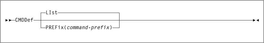

As shown in Figure 2-3, the CMDDef command includes the following parameters:
optionally, lists the current command prefix.
This is the default if no parameters are specified. It cannot be specified with any other parameter.
optionally, specifies a command prefix for the SMC subsystem. This parameter may only be specified in the SMCPARMS data set.
command-prefix indicates the command prefix. The value entered must be one to eight characters in length and meet the following requirements:
Valid characters include A-Z 0-9 @ ¢ $ # , . / ’ ( ) < > * & + - = | ! ; : ” % _ ?
The command prefix cannot include a command string, a command abbreviation, or any string that invokes a command.
The command prefix cannot include a string that is a subset or superset of an existing prefix beginning with the same character.
The MVS command,DISPLAY OPDATA, displays all active command prefixes and their corresponding subsystem name.Interfaces:

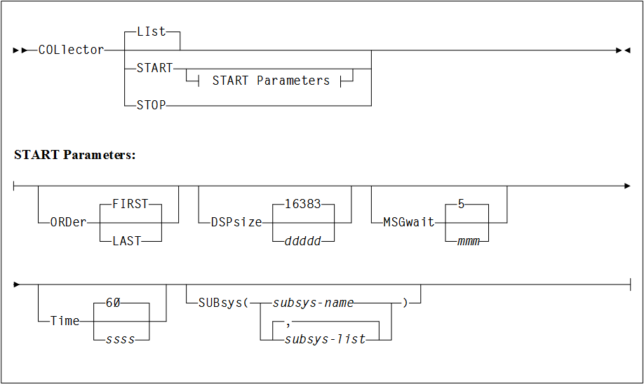

The SMC COLlector command is used to start or stop the statistical gathering function. This function allows the Virtual Storage Manger GUI to retrieve z/OS SMF records in real time.
As shown in Figure 2-4, the COLlector command includes the following parameters:
optionally, displays status information for the SMC collector.
optionally, starts the SMC collector.
optionally, stops the SMC collector.
optionally, specifies the order of the SMCXU83 IEFU83/IEFU84 exit. The parameter is used to order the SMCXU83 exit when other exits are present. The default is FIRST.
optionally, specifies the size (number of 4K blocks) of the collector data space used to accumulate SMF records. The data space is created on the first COLlector START. DSPsize can not be changed after the first start. The default is a data space of 64M.
ddddd indicates the number of 4K blocks.
optionally, specifies whether SMC0274 and SMC0275 messages are displayed. Message SMC0274 messages indicates that the SMC collector data space is full.
Specify YES or NO. NO is the default.
optionally, specifies the time between SMC0274 messages. This message indicates that the SMC collector data space is full.
mmm indicates the number of minutes to wait.
optionally, specifies the time to pause the data transmission to the requestor due to no data to send.
ssss indicates the number of seconds.

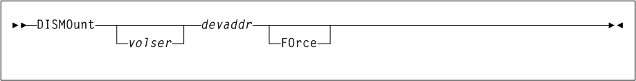

As shown in Figure 2-6, the DISMount command includes the following parameters:
optionally, the volume to be dismounted. The volume is dismounted only if the volume on the drive matches the specified volser. If volser is omitted, any volume that is on the drive is dismounted.
The MVS device address for which the volume is to be dismounted. The device must be defined by a TapePlex known to SMC.
This is a required value.
Ifvolser is omitted, a comma must precede the device address.optionally, indicates that if a loaded volume is found on the drive, it should be rewound and unloaded prior to attempting the requested dismount. This parameter is not supported for virtual drives.

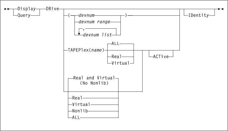

The SMC Display DRive command displays SMC drive attribute and TapePlex ownership information.
TapePlex drive information can also be obtained by issuing the HSCDisplay DRives command via the SMC Route command.As shown in Figure 2-7, the Display DRive command includes the following parameters:
a device number, range of device numbers, or list of device numbers to be processed. If specified, all device addresses specified are displayed. The devnum form of the Display DRive command is the only way that defined devices that are not TapePlex owned, or not defined by an SMC UNITAttr command, can be displayed.
devnum, devnum-range, and devnum-list are mutually exclusive with all other Display DRive parameters.
optionally, lists only devices owned by the specified TapePlex.
name indicates the TapePlex name. The following rules apply:
The value must be between 1 and 8 characters in length.
The first character must be either an alpha character or digit.
The last character must be either an alpha character or digit.
Any character between the first and last must be either an alpha character, digit, or hyphen.
optionally, lists only ”real” (that is, nonvirtual) devices owned by the specified TapePlex.
optionally, lists only virtual devices owned by the specified TapePlex.
optionally, lists all devices owned by the specified TapePlex. This is the default if no parameters are specified.
optionally, lists only ”real” (that is, nonvirtual) devices owned by SMC-defined TapePlexes.
optionally, lists only virtual devices owned by SMC-defined TapePlexes.
optionally, lists only ”real” devices that are not owned by any SMC-defined TapePlex, but have UNITATTR statements defined.
optionally, lists all devices owned by SMC-defined TapePlexes.
optionally, lists only drives currently mounted or awaiting mounts according to SMC internal data.
If aDisplay DRive command is issued without any parameters, by default, the SMC lists all real and virtual devices owned by SMC-defined TapePlexes.optionally, displays informational message SMC0178, identifying the drive serial number.

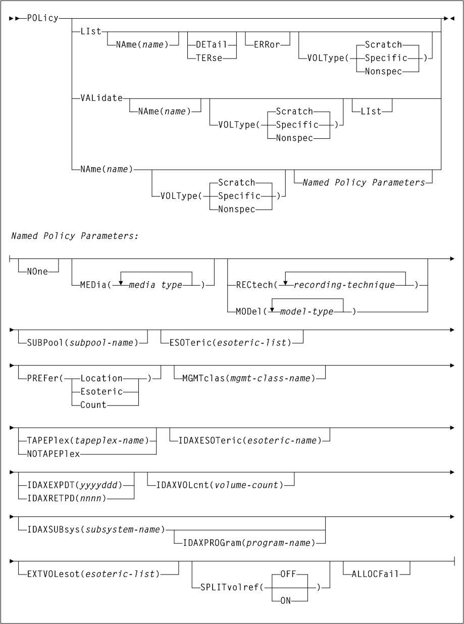

The SMC Display POLicy command displays information for a named policy. This command provides the same output as the SMC POLicy command with the LIst keyword.
As shown in Figure 2-8, the Display POLicy command includes the following parameters:
optionally, specifies the name of a policy that matches the name specified in a TAPEREQ or DFSMS ACS routine management class.
name may be specified with or without the keyword NAme. If the keyword NAme is not specified, the name, if specified, must be the first parameter.

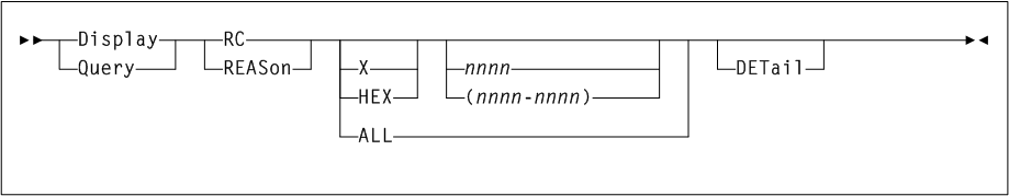

The SMC Display RC command displays information about the meaning of an SMC return or reason code, or an HSC/VTCS UUI reason code.
As shown in Figure 2-9, the Display RC command includes the following parameters:
optionally, specifies that the reason or return code value or range is specified as a hexadecimal number.
optionally, lists the return codes for which the explanation is to be displayed.
If X or HEX is specified, the value may contain hexadecimal characters 0-9 and A-F.
If X or HEX is not specified, the value may contain only numeric characters.
A range specified from the console may contain a maximum of 16 values.
optionally, indicates that all defined return or reason codes are to be listed. ALL is permitted only from a utility. ALL and H or HEX are mutually exclusive.
optionally, indicates that detailed information about the requested codes is to be listed.

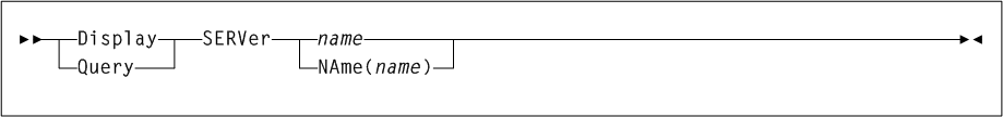

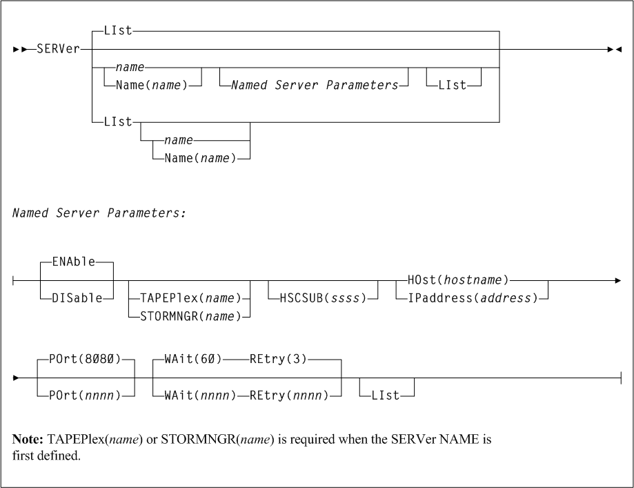

The SMC Display SERVer command displays information for a named server. This command provides the same output as the SMC SERVer command with the LIst keyword.
As shown in Figure 2-10, the Display SERVer command includes the following parameters:
indicates the server name to be defined, modified, or listed. This is a required value.

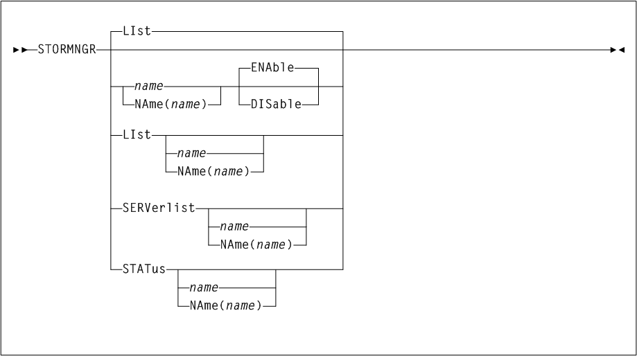

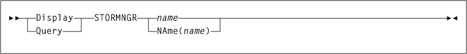

The SMC Display STORMNGR command displays information for a named VLE. This command provides the same output as the SMC STORMNGR command with the LIst keyword.
As shown in Figure 2-12, the Display STORMNGR command includes the following parameters:
Specifies the VLE to be defined, modified or listed. This name is also defined to VTCS, and is initially defined by the VLE GUI. If name is not specified, then all VLEs are listed.
Interfaces:

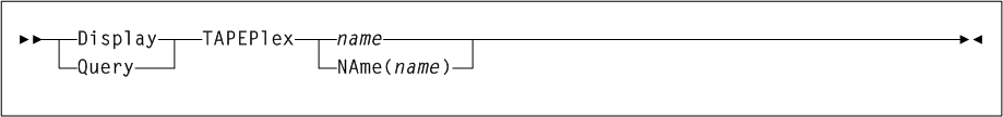

The SMC Display TAPEPlex command displays information for a named TapePlex. This command provides the same output as the SMC TAPEPlex command with the LIst keyword.
As shown in Figure 2-13, the Display TAPEPlex command includes the following parameters:
indicates the TapePlex name to be added, modified, or listed. This is a required value.

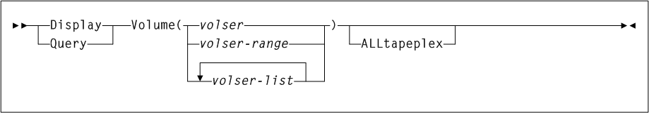

As shown in Figure 2-14, the Display Volume command includes the following parameters:
indicates the volser, volser range, or volser list to be processed. If multiple volumes are specified, only the first 100 are queried. This is a required value.
optionally, specifies that all active TapePlexes are queried for the specified volser, volser-range, or volser-list. If specified, multiple display lines may be listed for the same volser if it is defined in multiple TapePlexes.
If this parameter is not specified, the Display Volume command queries TapePlexes in the order they are defined and lists only the first occurrence of the volume.

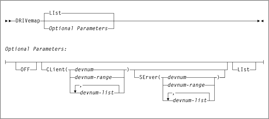

The SMC DRIVemap command maps client drive addresses to server drive addresses. This command enables users to specify different MVS device addresses on different hosts for the same TapePlex or virtual drives in client-server mode.
Refer to Oracle's ELS publication Configuring and Managing SMC for more information about drive mapping and for information about usingDRIVemap commands and the HSC DRVHOST parameter when client and server addresses differ.As shown in Figure 2-15, the MNTD command includes the following parameters:
optionally, lists all current DRIVemap mappings.
LIst is the default when no parameters are specified on the DRIVemap command. In this case, all DRIVemap entries are listed.
LIst may be specified with other parameters. In this case, the LIst is applied after the other parameters are processed.
optionally, removes all current DRIVemap mappings. When specified with CLient, this parameter removes DRIVemap ranges specified in the CLient parameter.
optionally, specifies the device numbers mapped by the DRIVemap command.
devnum, devnum-range, or devnum-list indicates the device number, device number range, or device number list.
optionally, specifies the device numbers that are defined on the HSC server.
The ranges and lists must match those in the CLient parameter. For example:
CL(AA0-AA2) SE(BA0-BA2) is valid.
CL(AA0-AA2) SE(BA0, BA1, BA2) is invalid.

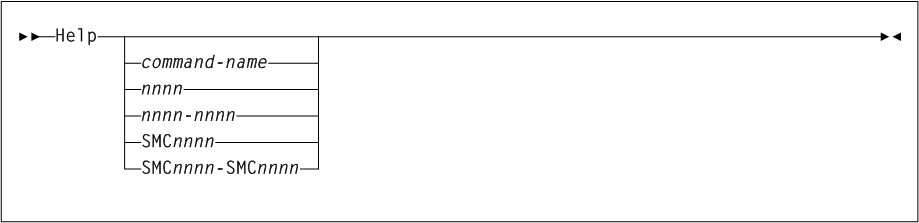

As shown in Figure 2-16, the Help command includes the following parameters:
If you enter theHelp command without any parameters, information is displayed for all available SMC commands.optionally, indicates an SMC command name.
optionally, indicates the four-digit numerical portion of an SMC message identifier. Leading zeros are not required.
optionally, indicates a range of SMC messages specified using the four-digit numerical portion of the message identifier.
optionally, indicates a full SMC message identifier.
optionally, indicates a range of SMC messages specified using full message identifiers.

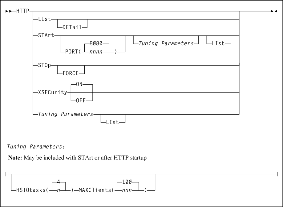

The SMC HTTP command starts an SMC socket listener component that supports a limited subset of HTTP capabilities, and enables the local SMC subsystem to act as an HTTP server for SMC client subsystems on other hosts. Requests that are sent from other SMC client subsystems to this SMC with an active HTTP Server component are processed by the local HSC.
The SMC HTTP command should only be executed on hosts where an HSC subsystem is executing; otherwise the HTTP command provides no operational benefit.
SMC subsystems on other hosts that will be clients to this local SMC with active HTTP Server component must use the SMC SERVER command to define the communications path to this host.
As shown in Figure 2-17, the HTTP command includes the following parameters:
optionally, displays SMC HTTP server status information and interval statistics.
optionally, lists I/O, error, accept and reject counts, and CGI module use count information in addition to information displayed in the LIst command.
optionally, starts the SMC HTTP server.
optionally, specifies the port number to be listened to for incoming requests.
nnnn indicates the TCP/IP port number. It is recommended that you do not specify well know TCP/IP port numbers. If not specified, The default is 8080.
optionally, stops the SMC HTTP server.
optionally, directs SMC to process the HTTP STOp command even if the status of the SMC HTTP server is not active. Use this parameter only if there has been an unrecoverable HTTP service task termination and the normal SMC HTTP STOp command has been rejected.
optionally, specifies whether the XAPI user password security protocol is globally enforced for requests processed by this HTTP server.
specifies that the XAPI security protocol is enforced for this server. This is the default setting.
specifies that the XAPI security protocol is not enforced for this server. If specified then the server will accept all requests and operate like a pre-ELS 7.3 server.
The following parameters can be entered with STArt or after HTTP startup. It is strongly recommended that you do not change the default values for these parameters unless directed by Oracle StorageTek Software Support.
optionally, specifies the maximum number of SMC HTTP socket I/O tasks to start.
n indicates the number of I/O tasks.
TheHSIOtasks parameter cannot be specified after HTTP server startup, it must be specified as part of the HTTP START command. However the remaining tuning parameters, MAXClients, SQUELEN, and WQUELEN may be changed after SMC HTTP server startup has completed.optionally, specifies the maximum number of connected requests that will be allowed at one time.
nnn indicates the number of requests. This value must be between 1 and 300. The default value is 100.

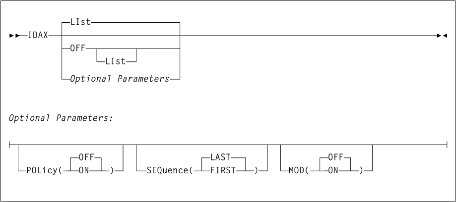

The SMC IDAX command controls SMC behavior during IDAX (MVS Interpreter/Dynamic Allocation Exit) processing.
As shown in Figure 2-16, the IDAX command includes the following parameters:
TheVTVMAXvol parameter is no longer supported. Instead, use the POLICY parameter IDAXVOLCNT. Refer to Configuring and Managing SMC for more information about selecting IDAX policies.optionally, lists current SMC IDAX settings.
LIst is the default when no parameters are specified on the IDAX command.
optionally, resets all IDAX settings to original SMC default settings. Specify LIst with this parameter to list these settings. OFF cannot be specified with any other parameter.
optionally, specifies whether SMC TAPEREQ or POLicy command processing is performed during IDAX.
TAPEREQ or POLicy command processing is not performed during IDAX. This is the default.
IDAX POLICY(ON) only applies to policy parameters that begin with the letters IDAX. If none of the policies contain IDAX policy parameters then setting IDAX POLICY(ON) adds unnecessary overhead.
SMC policy processing at IDAX using a DFSMS ACS routine MGMTCLAS as a policy name is controlled by the MGMTPol parameter of the SMSDef command.
optionally, specifies the relative sequence of SMC and IBM DFSMS ACS routine invocation during IDAX (Interpreter/Dynamic Allocation Exit) processing.
SMC invokes the DFSMS ACS routines after IBM. This is the default.
SMC invokes the DFSMS routines before IBM. This parameter allows your SMC DFSMS routines to assign tape esoterics to data sets with no specified esoteric, or to data sets that would otherwise be SMS-managed if IBM invoked the DFSMS routines before the SMC.
optionally, specifies whether the POLicy IDAXESOT parameters or SMC DFSMS esoteric substitution applies to DISP=MOD data sets as well as DISP=NEW data sets.
SMC POLicy IDAXESOT parameters or SMC DFSMS esoteric substitution do not apply to DISP=MOD data sets. This is the default.
SMC IDAX parameters and SMC DFSMS esoteric substitution (if specified) apply to all DISP=MOD data sets when the first reference to the data set in the job's JCL specifies either DISP=MOD or DISP=NEW.
During SMS IDAX substitution, the SMC cannot determine whether aMOD data set exists.Interfaces:

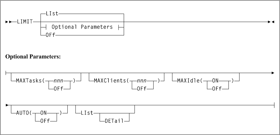

The SMC LIMIT command enables you to limit resource usage in the SMC subsystem. This command can limit exposure to Sx78 type abends.
By default, the SMC subsystem starts a new SMC work task whenever a new request is received but no free SMC work task is available. This default behavior manifests using the default LIMIT settings of LIMIT AUTO OFF and LIMIT MAXTASKS OFF.
However, depending upon the SMC subsystem work load, the SMC subsystem may attempt to start work tasks beyond the limits of SMC subsystem resource availability. This may cause Sx78 type abends due to virtual memory constraints. Such abends may lead to misdirected allocation, lost mount conditions, or loss of the SMC subsystem altogether.
If you specify LIMIT AUTO ON or LIMIT MAXTASKS nnn to override the default SMC subsystem behavior, then SMC queues requests for new work when the calculated or specified SMC work task limit is reached.
LIMIT AUTO ON causes SMC to use a calculated work task limit based upon SMC subsystem availability.
LIMIT MAXTASKS nnn causes SMC to use the specified work task limit.
The calculated or specified SMC work task limit acts to slow the processing for new requests. For example, if the calculated or specified SMC work task limit is 200, and a new request is received when 200 SMC work tasks are already active, then the new request is queued and waits until either an existing SMC work task completes its processing, or the LIMIT MAXIDLE nnn time elapses.
If the LIMIT MAXIDLE nnn time elapses and no existing SMC work task completes its processing, then the SMC starts a new work task to process the new request even though the number of work tasks now exceeds the calculated or specified work task limit. Therefore, the calculated or specified work task limit is a "soft" limit.
The default LIMIT MAXIDLE time is ten seconds. Therefore, the number of additional SMC work tasks above the calculated or specified work task limit is limited to one new work task every ten seconds until existing work tasks complete their processing.
Oracle recommends that you only use theLIMIT command to change the default LIMIT settings if your SMC subsystem experiences Sx78 type abends.As shown in Figure 2-19, the LIMIT command includes the following parameters:
limits the number of work tasks within the SMC subsystem. Work tasks process operator commands, allocation queries, mount and dismount requests, and TCP/IP connections to remote hosts, and other system processes. Typically these requests are short lived and their resources are reusable.
the maximum number SMC subsystem work tasks, between 16 and 500.
specifies no MAXTasks limit. The default value is OFf which implies the maximum MAXTasks limit of 500 work tasks.
optionally, limits the number of work tasks within the SMC subsystem that can be connected to a remote server at once. These work tasks are a subset of MAXTASKS.
The LIMIT MAXClients command is different from the HTTP MAXCLIENTS command:
The LIMIT MAXClients limits the number of client connections on the client side of client/server.
The HTTP MAXClients limits the number of client connections on the server side of client/server.
The number of SMC subsystem socket I/O work tasks between 1 and 500.
specifies no MAXClients limit. The default value is OFf which implies the maximum MAXCLIENTS limit of 500 SMC work tasks.
optionally, limits the amount of time that the SMC subsystem waits before starting a new work task in excess of the calculated or specified work task limit when new requests are received.
The number of seconds between 0 and 2400. The default is 10 seconds.
Restores the default value of 10 seconds.
optionally, specifies whether the SMC subsystem automatically sets a MAXTasks limit based on the amount of resources available.
specifies that the SMC subsystem will automatically set a MAXTasks limit if not overridden by the MAXTasks parameter.
Specifies that the SMC subsystem will not automatically set a MAXTasks limit.
optionally, resets all LIMIT settings to their default values.
optionally, lists the current LIMIT parameter settings. If LIMITS is entered without any command parameters, a LIst is performed.
optionally, lists SMC resource usage and calculated maximum number of work subtasks supported.
When LIMIT AUTO ON is specified, the SMC calculates the maximum number of SMC work tasks that it can support. This calculation is performed whenever the SMC starts a new work task that results in a new hi-water SMC work task count.
The calculation for maximum number of SMC work tasks is based on storage usage in various subpools. However, the actual maximum number of SMC work tasks than can be supported in practice is based on the types and timing of requests, and general system workload. The calculation only results in a rough estimate which can change as new subtasks are started.
LIMIT MAXTASKS nnn overrides the LIMIT AUTO ON or LIMIT AUTO OFF setting. Therefore, if both LIMIT MAXTASKS 190 and LIMIT AUTO ON are specified, SMC limit processing is triggered when the number of SMC work tasks reaches 190, regardless of the SMC subsystem calculation of the maximum number of work tasks.
LIMIT MAXCLIENTS is not the same as HTTP MAXCLIENTS. LIMIT MAXCLIENTS imposes restrictions on TCP/IP socket connections on the client side of client-server while HTTP MAXCLIENTS imposes restrictions on TCP/IP socket connections on the server side of client-server.

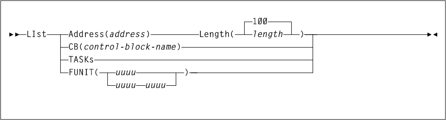

The SMC LIst command displays storage accessible from the SMC started task address space.
This command is intended to be used primarily as directed by Oracle StorageTek Software Support. Output is intended for debugging and support purposes.
As shown in Figure 2-20, the LIst command includes the following parameters:
optionally, specifies the address at which to begin listing SMC memory contents.
address indicates the address. The value entered must be a valid hexadecimal address.
optionally, specifies the length of SMC memory (bytes) to be listed. Length is required if Address is specified.
length indicates the value entered must be a valid hexadecimal value between 1 and FFFF. Memory is listed beginning at the location specified in the Address parameter. The default value is 100 (decimal 256).
optionally, specifies the internal SMC control block to be listed.
control-block-name indicates the control block name.
SMC control blocks are listed for diagnostic purposes. Specify control-block-name only as directed by Oracle StorageTek Software Support.
optionally, lists the tasks in the SMC subsystem address space.
optionally, lists SMC control blocks associated with the specified unit address(es).
uuuu or uuuu-uuuu indicates a unit address or range of unit addresses.

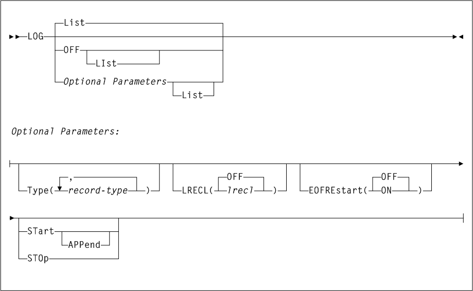

The SMC LOG command logs data communications from either or all of the following:
SMC Library Interface Component
SMC Client Configuration Component
SMC HTTP Server Component
SMC Operator Command Component
These communication transactions are logged to the SMC log file.
As shown in Figure 2-21, the LOG command includes the following parameters:
optionally, displays HTTP Server status information and interval statistics.
LIst is the default when no parameters are specified on the LOG command.
optionally, resets all LOG settings to original SMC default settings. OFF closes the LOG, turns off all record TYPEs, and sets LRECL to 0. If a subsequent LOG START command is issued after the OFF command, no records are logged until specific LOG TYPEs are specified.
Optionally, specifies what record types are to be logged.
record-type indicates one of the following record types:
For local LIBTRANS XML transactions sent from the SMC Library Interface Component
For local LIBTRANS XML responses received by the SMC Library Interface Component
For remote LIBTRANS XML transactions sent from the SMC Client Communication Component
For remote LIBTRANS XML responses received by the SMC Client Communication Component
For remote UUI transactions sent from the SMC Client Communication Component
For remote UUI responses received by the SMC Client Communication Component
For all errors detected by the SMC Client Communications Component
For all data sent outbound by the SMC HTTP Server Component
For all data received inbound by the SMC HTTP Server Component
For all errors detected by the SMC HTTP Server Component
For all operator commands received by the SMC Operator-Command Component
Sets all types ON.
Sets all types OFF.
optionally, specifies the line length written to the LOG file.
a value from 80 to 32767, used to limit the logical line length.
If the data sent or received exceeds the specified LRECL, then multiple lines are written. If LRECL is specified, then the log date and time stamp are written as separate LOG records. If this value exceeds the DCB LRECL, then the DCB LRECL is used.
The maximum line length is controlled by the DCB LRECL. The LOG record is appended to the log date and time stamp. This is the default.
optionally, specifies the response when the LOG file reaches End of File (EOF).
Logging stops at EOF.
The LOG file closes and re-opens at EOF, and logging continues.
optionally, starts logging.
optionally, specifies that data is appended to the current LOG file when logging is started. If not specified, then data is added to the LOG file from the beginning of the log file, and any data currently in the log file is lost. APPend can only be specified when STArt is also specified.
optionally, stops logging. Current LOG settings are preserved.

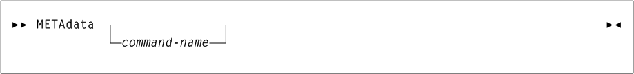

The SMC METAdata command displays XML tags associated with a function that produces XML output.
No text output is produced by theMETAdata command. If neither XML nor CSV output is requested, the command will not produce any output.As shown in Figure 2-22, the METAdata command includes the following parameters:
The command for which metadata is to be produced.
When the command contains "two parts" such as Display Volume, both portions should be entered. The METAdata command uses the same abbreviations for the command-name as the command itself, for example:
METAdata D V
The METAdata command itself does not support metadata.

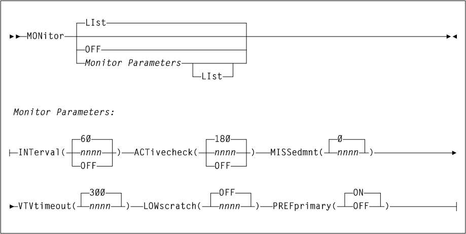

The SMC MONitor command defines parameters associated with SMC monitoring.
SMC cannot detect pending mounts when either of the following conditions are present:The job entry subsystem is JES3,
The mount is outstanding on a JES3 LOCAL processor,
ALLOCDEF DEFER(OFF) has been specified.
The mount was requested before SMC had initialized and the mount request did not request the DEFER option.
As shown in Figure 2-23, the MONitor command includes the following parameters:
Optionally, lists the current MONitor command settings.
Optionally, resets all MONitor parameters to their default values.
Optionally, specifies the base SMC monitor scan interval in seconds. The default value is 60.
At each monitor interval, SMC performs the following actions:
SMC attempts to find an active communication path for any inactive TapePlex or Storage Manager.
If PREFprimary(ON) is set, SMC attempts to change the communication path from a non-primary path to the primary server.
SMC checks to ensure that the SMC IEFJFRQ exit is active, so that SMC is influencing tape allocation.
SMC clears orphaned task tokens.
SMC attempts to redrive pending mounts.
It is strongly recommended that you do not set theMONitor INTerval to 0 or OFF. With these values set, SMC is not able to re-drive pending mounts, honor the PREFprimary setting automatically, or verify that the IEFJFRQ exit is active.Optionally, specifies the interval in seconds after which SMC should verify that communication is still accessible on an active communication path that has had no activity since the prior active check.
nnn indicates the interval in seconds. The default value is 180, or 3 times the INTerval value.
If ACTivecheck is set to 0 or OFF, SMC does not monitor active communication paths. If the ACTivecheck interval is not a multiple of the base INTerval, it is rounded up to a number of seconds that is a multiple of the INTerval value.
Optionally, specifies the interval in seconds after which SMC should issue a message indicating that an outstanding mount is pending. The message is repeated after each interval as long as the mount remains unsatisfied.
nnnn indicates the interval in seconds. The default value is 0, meaning that the message does not appear.
If the MISSedmnt interval is not a multiple of the base INTerval, it is rounded up to a number of seconds that is a multiple of the INTerval value. It is recommended that you set this interval to at least 600 (10 minutes) to allow the SMC mount monitor processing to attempt to redrive missing mounts before producing the periodic missed mount message.
Optionally, specifies the time in seconds (nnnn) after which SMC will issue the SMC0231 message and attempt to re-drive a mount request for a VTV.
nnnn indicates the time in seconds. The default value is 300 seconds (5 minutes).
If the VTVtimeout value is not a multiple of the base INTerval, it is rounded up a number of seconds that is a multiple of the interval value.
The minimum value of VTVtimeout is 300 seconds; the maximum is 1800 seconds.
Optionally, specifies the interval in seconds after which SMC should report on server scratch subpools that are below their threshold value.
nnnn indicates the interval in seconds. The default value is OFF.
LOWSCRatch does not report on scratch shortages that are not associated with a subpool name, except for scratch subpool zero.
If LOWSCRatch is set to 0 or OFF, SMC does not perform scratch threshold checking.
If the LOWSCRatch interval value is not a multiple of the base INTerval, it is rounded up to a number of seconds that is a multiple of the INTerval value.
Optionally, indicates whether SMC attempts to establish communication on a higher priority server path when communication is currently active on a server that is not the first defined server for a TapePlex. The default value of ON indicates that at each MONitor INTerval, SMC attempts to communicate on the first defined server path if that is not the current active path.
If PREFprimary is set to OFF, then SMC continues to communicate on an active path even if one defined earlier becomes available.
The PREFprimary setting also controls the behavior of the RESYNChronize command. When PREFprimary(ON) is set, a RESYNChronize attempts to communicate to the first defined server. When PREFprimary(OFF) is set, a RESYNChronize does not change the current active communication path, if one exists.

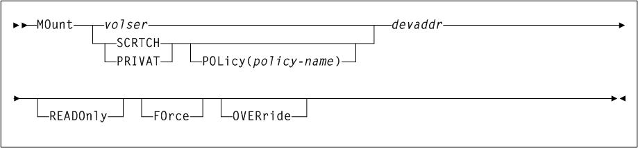

The SMC MOunt command requests a mount of a specific or scratch volume on a tape device.
As shown in Figure 2-24, the MOunt command includes the following parameters:
the volume serial number of the volume to be mounted.
indicates a scratch mount.
optionally, when the volume is specified as SCRTCH (or PRIVAT), specifies the name of an SMC policy that defines the subpool name and management class name (if applicable) to be applied for the scratch mount.
policy-name indicates the policy name.
the MVS device address for which the volume is to be mounted. The device must be defined by a TapePlex known to SMC. This is a required value.
optionally, indicates that the volume is to be mounted with write protect enabled.
optionally, indicates that if a loaded volume is found on the drive, it should be rewound and unloaded prior to attempting the requested mount. FOrce is not supported for virtual drives.
optionally, indicates that if SMC detects a pending mount for the drive, indicates that the volume specified in the MOunt command should override the volume indicated in the pending mount.

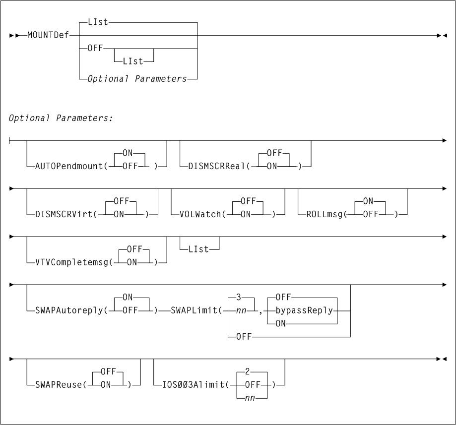

As shown in Figure 2-25, the MOUNTDef command includes the following parameters:
optionally, lists current SMC MOUNTDef settings.
LIst is the default when no parameters are specified on the MOUNTDef command.
optionally, resets all MOUNTDef settings to original SMC default settings. Specify LIst with this parameter to list these settings.
optionally, specifies whether the pending mounts are automated for library or virtual drives found when SMC is first initialized and the owning TapePlex is first activated.
Pending mounts are automated. This is the default.
Pending mounts are not automated.
IfAUTOPendmount is OFF, you must issue an HSC MOUNT command to complete any pending mounts found when a TapePlex is first activated.optionally, specifies how the SMC interprets the delete disposition on a dismount message for real (nonvirtual) volumes.
TheDISMSCRReal and DISMSCRVirt parameters replace the DELDISP= parameter of the HSC LIBGEN SLILIBRY macro.The real cartridge is retained as nonscratch when MVS indicates delete disposition in the dismount message. This is the default, and is recommended for CA-1 or CA-TLMS users to leave volumes in a consistent nonscratch status during the CA-1 and CA-TLMS grace period.
The real cartridge is scratched when MVS indicates delete disposition in the dismount message.
optionally, specifies how the SMC interprets the delete disposition on a dismount message for VTVs.
TheDISMSCRReal and DISMSCRVirt parameters replace the DELDISP= parameter of the HSC LIBGEN SLILIBRY macro.The VTV is retained as nonscratch when MVS indicates delete disposition in the dismount message. This is the default.
The VTV is scratched when MVS indicates delete disposition in the dismount message.
optionally, specifies whether an SMC message is issued when a library volume is to be mounted on a nonlibrary drive.
No message is issued when a library volume is to be mounted on a nonlibrary drive.
A console message is issued when a library volume is to be mounted on a nonlibrary drive.
optionally, specifies whether mount messages handled by the SMC are allowed to roll off the operator console before mount requests are satisfied.
Mount messages are allowed to roll off the console screen before mounts are satisfied. This is the default.
You can limit the rolling of specific mount messages (for example, TMS007) by presetting the messages xxxxRCDC (Request to Change Descriptor Codes) flag word xxxxRBFB1. The SAMPLIB includes a sample MPF USEREXIT to preset the xxxxRCDC flag.
Mount messages remain on the console screen until mount requests are satisfied.
optionally, specifies whether VTV mount and dismount messages are issued.
VTV mount (SLS5075I) and VTV dismount (SLS5076I) messages are not issued on the host where the server is running. This is the default.
The VTV mount (SLS5075I) and VTV dismount (SLS5076I) messages are issued on the host where the server is running.
optionally, specifies whether the SMC enhanced swap process automatically responds NO to the IBM IGF500D - REPLY 'YES' DEVICE OR 'NO' message when no compatible swap-to device is found.
SMC automatically replies NO to the IBM IGF500D - REPLY 'YES' DEVICE OR 'NO' message after the SMC fails to find compatible devices and issues its own SMC0108 No compatible drive found for SWAP processing message. This is the default.
SMC does not automatically reply to the IBM IGF500D - REPLY 'YES' DEVICE OR 'NO' message after the SMC fails to find compatible devices.
optionally, specifies the maximum number of system initiated swaps that SMC influences for the same job step and volume serial.
a swap value of 0-99, or OFF.
If the value specified is 0 or OFF, then the SMC continues to attempt to influence the swap indefinitely.
If the value is not specified, the default value is 3.
For any SWAPLimit value other than 0 or OFF, SMC stops attempting to influence the swap after nn attempts for the same job step and volume serial.
Any operator-initiatedSWAP commands are not applied to the SWAPLimit value.Substitute one of the following values for bypassReply:
ON optionally, indicates that SMC should not reply to the system message IGF509D if another swap attempt is detected after the SWAPLIMIT count is exhausted.
OFF optionally, SMC generates a response of NO to an IGF509D message after nn swap attempts. This is the default.
optionally, specifies whether previously used swap-to devices are to be excluded as possible swap-to devices for the current job step and volume serial.
Previously used swap-to devices are excluded as possible swap-to devices for the current job step and volume serial. If no eligible device is found then SMC issues message SMC0108 and if the MOUNTDef SWAPAutoreply is set to ON then the IGF500D or IGF509D message is replied to with NO. This is the default.
Previously used swap-to devices are eligible to be used for the current job step and volume serial.
optionally, specifies the maximum number of attempts to re-drive a mount request that has failed with an IOS003A message.
perform an unlimited number of attempts to re-drive the mount request for a given drive following an IOS003A message for a given drive.
the maximum number of attempts to re-drive the mount request. Valid values are 0-99. The default is 2. A value of 0 is equivalent to IOS003Alimit(OFF).

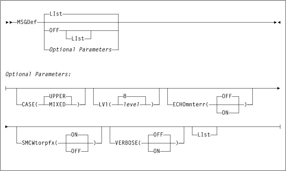

The SMC MSGDef command defines the appearance of SMC system messages, and controls which messages are displayed and suppressed.
As shown in Figure 2-26, the MSGDef command includes the following parameters:
optionally, lists current default SMC message settings.
LIst is the default when no parameters are specified on the MSGDef command.
optionally, resets all MSGDef values to original SMC default settings. Specify LIst with this parameter to list these settings. MSGDef cannot be specified with any other parameter.
optionally, specifies the message case. Valid values are UPPER or MIXED.
specifies upper case. This is the default.
specifies mixed case.
optionally, specifies the default level used to control which SMC messages are displayed and suppressed.
the default level. Valid values include the following:
0 - Display error messages only.
4 - Display error and warning messages from the SMC subsystem.
8 - Display all SMC subsystem messages and allocation job log warning messages. This is the default if the MSGDef parameter is not specified.
Levels higher than 8 are used for diagnostic purposes and should only be specified as directed by Oracle StorageTek Software Support.optionally, specifies whether mount errors generated by the HSC are echoed directly to the console for the SMC client.
Mount errors generated by the HSC are echoed to the console for the SMC client. This parameter is valid for both local and remote servers.
Mount errors generated by the HSC are not to the console for the SMC client. This is the default.
optionally, specifies whether the SMC0137 prefix is displayed for HSC WTOR messages generated by WTORDEST(CLIENT) on the TAPEPlex command.
The SMC0137 prefix is displayed. This is the default.
The SMC0137 prefix is not displayed.
optionally, specifies whether SMC0190 and SMC0191 messages are displayed whenever any SMC settings are altered.
SMC0190 and SMC0191 messages are displayed.
SMC0190 and SMC0191 messages are not displayed.

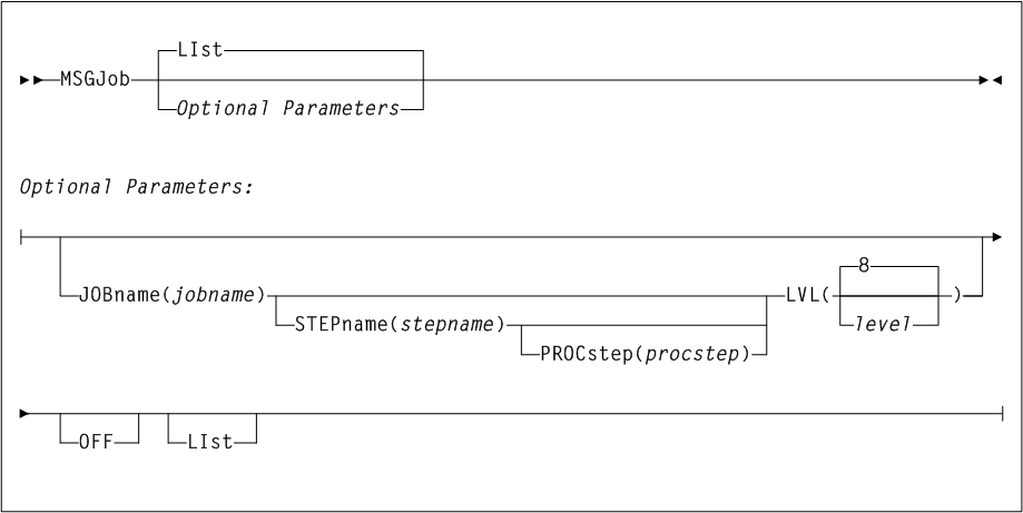

The SMC MSGJob command enables you to override of the default message level by job name, step name, and PROC step.
As shown in Figure 2-27, the MSGJob command includes the following parameters:
optionally, lists current default SMC message settings and job name, step name, and PROC step exceptions (in the order of evaluation).
LIst is the default when no parameters are specified on the MSGJob command.
jobname indicates the job name. The value entered must be one to eight characters in length. An asterisk (*) can be used as a wildcard when included as the last character. In this case, the message level is set for all jobs whose job names match the characters preceding the asterisk.
optionally, specifies a step name. It is only valid when JOBname is also specified (may be JOB=*).
stepname indicates the step name. The value entered must be one to eight characters in length. This parameter is only valid if JOBname is also specified.
optionally, specifies a PROC step. It is only valid when JOBname and STEPname are also specified.
procstep indicates the PROC step. The value entered must be one to eight characters in length. This parameter is only valid if JOBname and STEPname are also specified.
optionally, specifies the default level used to control which SMC messages are displayed. This parameter is required when JOBname is specified.
level indicates the default level. Valid values include the following:
Levels higher than 8 are used for diagnostic purposes and should only be specified as directed by Oracle StorageTek Software Support.optionally, removes MSGJob overrides.
If no other parameters are specified, MSGJob overrides are removed for all jobs.
If only JOBname is specified, MSGJob overrides are removed for all MSGJob entries for that job name.
If JOBname, STEPname and PROCstep are specified, MSGJob overrides are removed only for the specified entry.
The global MSGJob is not affected by this parameter.

The SMC POLicy command specifies all tape policy specifications in a single named policy object. It can be used with SMC TAPEREQ statements or SMC DFSMS routines to associate a named policy with an allocation or mount event. Additionally, the POLicy VALidate option can be used to validate policy objects.
Refer to Oracle's ELS publication Configuring and Managing SMC for more information about the use of SMC policies.Policies defined using the SMC POLicy command create SMC policy objects that can be referenced by name from either SMC TAPEREQ control statements using the TAPEREQ POLicy parameter. A policy name may be associated with two policy objects: a scratch policy with the specified name, and a specific policy with the specified name. Policies referenced from SMC TAPEREQ control statements must be defined prior to executing the TREQDEF command that processes the TAPEREQ control statements.
By default, and SMC POLICY command applies ONLY to SCRATCH volumes. If you want to set a policy for specify volumes, you must specify VOLTYPE(SPECIFIC). If you want to specify a policy to apply to both SCRATCH and SPECIFIC volumes, you must specify two separate POLICY commands with the same POLICY name.
When a policy to be added to the SMC contains a policy specification error, for example, specifying a scratch subpool name with VOLTYPE(SPECIFIC), the SMC still creates the policy object to find it. When a policy is marked as in error, the policy is empty, indicating that the default tape policy attributes will be applied to an event that specifies this policy name.
To update an SMC policy, enter a new SMC POLicy command for the given policy NAme and VOLType. Be aware that the new POLicy command replaces the existing scratch or specific policy object. Therefore, when updating a policy, you must enter all values you wish to preserve.
For example, if the original scratch policy object is defined as:
POLICY NAME(POL1) VOLTYPE(SCRATCH) MEDIA(VIRTUAL) MGMTCLAS(MGMT1)
and you wish to add a subpool to the policy, you must enter:
POLICY NAME(POL1) VOLTYPE(SCRATCH) MEDIA(VIRTUAL) MGMTCLAS(MGMT1) SUBPOOL(SUBP1)
This behavior enables you to modify one or more POLicy commands in a file and reload all policies using the SMC READ command. Note that when using the SMC READ command to reload the SMC POLICY file, it is recommended that you specify the option REPlacepolicy to receive notifications about POLICY commands present in the original definitions but missing in the new definitions.
When an SMC policy object to be updated contains a policy specification error, for example, specifying a scratch subpool name with VOLType(SPecific), the SMC will not update any part of the existing policy object. The policy object is not marked in error, and the complete update is discarded.
DEVTPREF is not supported on this command. However, you can use an esoteric list to specify preferencing for different device types.
As shown in Figure 2-28, the POLicy command includes the following parameters:
optionally, displays all policy information. Additional parameters allow you to limit which policies are listed, and how much detail is displayed.
If name is also specified, only policies that match the specified name or generic name are listed. If name is not specified, then all policies are listed.
Matching policies are listed in alphabetic order, regardless of the order in which they were defined to the SMC. When specified with other parameters, theLIst is performed after the other parameters have been processed.optionally, specifies the name of a policy that matches the name specified in a TAPEREQ or DFSMS ACS routine management class. If the keyword NAme is omitted, the policy name is assumed to be the first parameter following the POLicy command (if that parameter is not a valid keyword).
optionally, displays audit detail information about the policy, including last update date, time, and source. DETail and TERse are mutually exclusive.
optionally, lists only policy names and whether each policy name applies to scratch, specific, or all allocations. TERse and DETail are mutually exclusive.
optionally, displays each policy in error status.
When a policy to be added to the SMC contains a policy specification error, for example, specifying a scratch subpool name with VOLTYPE(SPECIFIC), the SMC still creates the policy object. However, the SMC marks the policy object in error, allowing any reference to the named policy object to find it. However, the returned policy will be empty, indicating that the default tape policy attributes will be applied to the event. ERRor lists only those policies that contain an error.
optionally, specifies whether the list applies to scratch or specific policy types.
List only scratch (nonspecific) policies. This is the default.
List only specific policies.
optionally, validates and lists policy information against the current TapePlex environment. Additional parameters allow you to limit which policies are validated, and whether all results or just warnings and errors are displayed.
optionally, specifies the name of a policy to be validated.
If the last character is an asterisk (*), all policies that begin with the prefix are displayed. For example, POL VAL NA V* validates all policies that begin with ”V”. If the NAme parameter is omitted, a non-keyword parameter following the POLicy command is interpreted as the NAME.
optionally, specifies whether only warnings and errors are listed, or all tested policies are listed. If not specified, then only a single line for each policy that generates a warning or error message is listed.
optionally, specifies the name of a policy. name may be specified with or without the keyword NAme. If the keyword NAme is not specified, the name, if specified, must be the first parameter.
The policy name must match the name specified in a TAPEREQ or DFSMS ACS routine management class name.
When a policy is not being added or updated, the policy name can be a generic name, for example POLICY V* lists information for all policies that begin with V.
optionally, specifies whether the policy applies to scratch or specific allocation.
The policy applies only to scratch (nonspecific) allocations. This is the default.
The policy applies only to specific allocations.
See individual parameters for restrictions on the VOLType that is permitted or not allowed.
If you want to specify a policy that applies to both scratch and specific volumes, you must use two separatePOLicy commands with the same POLicy NAME, one with VOLType(SCratch)(or not specified) and one with VOLType(SPecific).When a new policy is added, the default VOLType is SCratch (or Nonspec). You can add the same policy name for both SCratch and SPecific VOLTypes.
The following parameters require a name or NAme(name) parameter:
optionally, removes all policy parameters associated with the named policy. Specifying NOne for a policy implies that the default behavior is applied, for example, any media or rectech, subpool 0, etc.
optionally, specifies the desired media type for a data set being created. You can enter a list of media types, separated by commas. A list specifies a generic pool from which a selection is made. There is no implied priority.
media-type indicates the media type. See Appendix A, "MEDia, RECtech, and MODel Values" for a list of valid media-type values.
If this parameter is not specified, a default is chosen based on the value of the RECtech parameter. See Appendix A, "MEDia, RECtech, and MODel Values" for default values used if the MEDia parameter is omitted.
MEDia and VOLType(SPecific) are mutually exclusive unless the NOTAPEPlex parameter is specified. If both media type and recording technique are omitted, all available device types are eligible for allocation.
optionally, specifies the method used to record data tracks on the tape surface for the desired data set. You can enter a list of recording techniques, but they must be separated by commas. A list specifies a generic pool from which a selection is made. There is no implied priority.
recording-technique indicates the recording technique. See Appendix A, "MEDia, RECtech, and MODel Values" for a list of valid recording-technique values.
If this parameter is not specified, a default is chosen based on the value of the MEDia parameter. See Appendix A, "MEDia, RECtech, and MODel Values" for default values used if the MEDia parameter is omitted. If both media type and recording technique are omitted, all available device types are eligible for allocation.
RECtech and MODel are mutually exclusive.
optionally, specifies the model number of a transport. You can enter a list of models, separated by commas. A list specifies a generic pool from which a selection is made. There is no implied priority.
MODel provides the same type of information as RECtech, but a user may find it more convenient to specify a transport model rather than a recording technique. MODel and RECtech are mutually exclusive.
model-type indicates the model type. See Appendix A, "MEDia, RECtech, and MODel Values" for a list of valid model-type values.
optionally, specifies the subpool used to satisfy a scratch request. SUBPool and VOLType(SPecific) are mutually exclusive.
subpool-name indicates the subpool name.
optionally, specifies the name of a device esoteric group, or list of device groups defining the list of eligible transports to be used to satisfy a tape request.
esoteric-group-name or esoteric-list indicates the esoteric group name. The name specified can consist of one to eight alphanumeric or national (#, @, $) characters. A slash (/) or hyphen (-) is also valid.
If the esoteric list contains devices not currently in the Eligible Device List, SMC allocation cannot add devices to the list, but can exclude devices not in the specified esoteric. During drive exclusion, devices in any of the listed esoterics are included. During drive prioritization, devices are ordered according to their position in the esoteric list.
optionally, specifies the relative value of the esoteric list and additional preferencing information. PREFer is only valid when a list of esoterics is specified.
Drives are preferred based on LSM location of a specific volume. This is the default for specific volumes. Location is only valid for VOLType (SPecific).
Drives are preferred based on the order specified in the esoteric list. This is the default for scratch allocations.
Drives are preferred based on scratch counts in the LSM. Count is mutually exclusive with VOLTYPE(SPecific).
optionally, specifies a Management Class defined on the VTCS MGMTclas control statement. See "MGMTclas Control Statement" for more information.
name indicates the Management Class name.
optionally, specifies the name of a TapePlex defined to SMC. SMC uses the specified TapePlex name to determine the owner of an allocation request. Only the specified TapePlex name is queried to determine specific volume information or scratch availability.
name indicates the TapePlex name. This must be a TapePlex name specified on a TAPEPlex command. The following rules apply:
The named TapePlex must be defined using a TAPEPlex command before the POLicy command is processed. TAPEPlex and NOTAPEPlex are mutually exclusive.
optionally, specifies that SMC will not perform a TapePlex lookup to obtain volume information. NOTAPEPlex and TAPEPlex are mutually exclusive.
optionally, specifies the esoteric name to be substituted during IDAX (MVS Interpreter/Dynamic Allocation Exit) processing.
esoteric-name indicates a valid esoteric name to be used for the allocation.
Specification of IDAXESOTeric is similar to changing the JCL unit name, and completely replaces the original esoteric.
Unlike the ESOTeric parameter, the IDAXESOT eric esoteric-name does not need to include any devices in the original JCL esoteric.
optionally, specifies the expiration date to be applied to the allocation during IDAX.
yyyyddd indicates the desired expiration date (4-digit year and Julian day).
IDAXEXPDT and IDAXRETPD are mutually exclusive. IDAXEXPDT and VOLType(SPecific) are mutually exclusive.optionally, specifies the retention period to be applied to the allocation during IDAX.
nnnn indicates the retention period in number of days.
IDAXRETPD and IDAXEXPDT are mutually exclusive. IDAXRETPD and VOLType(SPecific) are mutually exclusive.optionally, specifies the maximum number of volumes to be applied to the allocation during IDAX. This value overrides the volume count parameter specified in the JCL.
volume-count indicates the maximum volume count. Valid values are 1-255.
optionally, specifies that SMC direct an allocation job to another subsystem or program.
For example, SMC can direct any FDR or DFDSS job to Oracle's StorageTek ExHPDM backup and restore software. The IDAXSUBsys policy directs the output tape data set allocation to ExHPDM, effectively placing the DD SUBSYS JCL specification in the job.
subsystem-name indicates the subsystem name.
IDAXSUBsys and VOLType(SPecific) are mutually exclusive.optionally, alters the program name in the allocation job.
For example, this parameter can alter the program name for DFDSS (ADRDSSU) to the ExHPDM User Interface Module (SOVDSSU), and in conjunction with the IDAXSUBsys parameter, direct the backup DFDSS job to ExHPDM.
program-name indicates the program name.
Refer to the ExHPDM Operator and System Programmer's Guide for more information about the ExHPDM backup and restore software.optionally, specifies the name of a device esoteric group, or list of device groups defining the list of eligible transports to be used to satisfy a tape request when the specific volume is found to be outside of the library. EXTVOLesot can only be specified if VOLTYPE=SPECIFIC is also specified.
esoteric-list indicates the esoteric-list. Each esoteric group name in the list can consist of one to eight alphanumeric or national (#, @, $) characters. A slash (/) or hyphen (-) is also valid.
optionally, specifies whether VOL=REF chains are to be broken. SPLITvolref and VOLType(SPecific) are mutually exclusive.
VOL=REF chains are not broken. This is the default.
VOL=REF chains are broken and the LABEL data set sequence number is set to 1.
optionally, specifies that a job step matching the policy should be failed during SMC allocation. When this parameter is specified, any job step that matches the policy has all its devices marked ineligible by the SMC allocation process, which causes the job to fail. ALLOCFail is mutually exclusive with all other parameters except for NAme, LIst, VALidate, and VOLType.

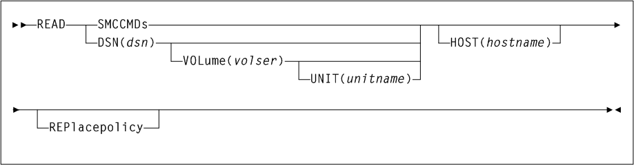

The SMC READ command enables you to enter a series of commands using an input data set instead of console commands.
As shown in Figure 2-29, the READ command includes the following parameters:
optionally, re-processes commands contained in the data set specified in the SMCCMDS DD statement of the SMC START procedure.
optionally, processes commands contained in the specified data set.
dsn indicates the data set name.
If theDSN parameter specifies a member name, the full data set must be enclosed in single quotes.optionally, specifies the volume serial number of the DASD volume on which the data set resides. Specify this parameter if the data set is not catalogued.
volser indicates the volume serial number on which the data set resides.
optionally, specifies the unit name of the specified VOLume for uncataloged data sets. Requires that VOLume also be specified.
unitname indicates the unit name. If not specified, then a unit name of SYSALLDA is the default.
optionally, specifies a host name for which this READ command is valid. If this parameter is specified, the READ command is only processed when the specified hostname matches the MVS host. If this parameter is not specified, the READ command is processed regardless of the MVS host.
hostname indicates the host name.
HOST is not valid when the READ command is entered from an MVS console.
Specification of the HOST parameter enables you to share a single SMC parameter file set across multiple MVS hosts as shown in the following example:
your.parmlib(COMMCMDS)
MSGDEF CASE(MIXED) ...other common SMC parameter settings... READ DSN(’your.parmlib(MVS1CMDS)') HOST(MVS1) READ DSN(’your.parmlib(MVS2CMDS)') HOST(MVS2)
DRIVEMAP CL(AB0-AB7) SE(BB0-BB7)
DRIVEMAP CL(CB0-CB7) SE(BB0-BB7)
The file COMMCMDS contains SMC parameter settings applicable to all hosts, and the READ commands with HOST specifications for your MVS hosts. The file MVS1CMDS contains SMC specifications applicable only to MVS host MVS1, while the file MVS2CMDS contains SMC specifications applicable only to MVS host MVS2.
optionally, specifies that all SMC POLICY objects are to be replaced by any POLICY statements found in the specified data set (or in any data set subsequently read by the specified READ data set).
If REPlacepolicy is not specified, individual POLICY statements within a READ command update or add only the referenced POLICY statements and do not affect unreferenced POLICY statements.
After the READ REPlacepolicy command is executed, any TAPEREQ POLICY references are re-validated. If any TAPEREQ POLICY references are subsequently found to be in error, the invalid TAPEREQ statements are left active, but reference a "null" POLICY (that is, the equivalent of specifying POLICY NAME(name) NONE).
It is recommended that any TAPEREQ statement(s) be reloaded by inclusion of the TREQDEF command whenever a READ REPlacepolicy command is executed, in order to re-validate all SMC tape policies at the same time.

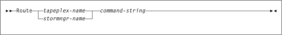

The SMC Route command routes command transactions from SMC to a defined TapePlex or VLE. Only the following are supported:
VTCS commands
HSC commands with UUI support, with the exception of VOLRPT.
The HSC MOUNT, DISMOUNT, ENTER and MOVE commands can now be issued from SMC via the ROUTE command.
Currently, the only command that will be accepted and processed by a VLE is the QUERY SERVER command.
You can also use the Route command to issue various commands from a VM Client to an ACSLS XAPI server. Refer to Oracle's ELS publication XAPI Client Interface to ACSLS Server Reference for more information.
As shown in Figure 2-31, the Route command includes the following parameters:
specifies a TapePlex name as defined on an SMC TAPEPlex command. SMC routes the request to the specified TapePlex using the currently active TapePlex path. Commands may be sent to either a local or remote HSC TapePlex. This command is not supported for MVS/CSC TapePlexes.
specifies a VLE name as defined on an SMC STORMNGR command. SMC routes the request to the specified VLE using the currently active VLE path. Commands may be sent to either a local or remote HSC TapePlex or VLE. This command is not supported for MVS/CSC TapePlexes.
specifies the command string to be routed to the requested TapePlex. VTCS commands should not be prefixed with VT; the HSC UUI interface routes VTCS commands to the correct functional processor without the VT prefix. The command string must be a command supported by the HSC UUI or any VTCS command (except DISPLAY MSG and DISPLAY CMD). This is a required value.

The SMC SERVer command defines a named path to a remote library server; an HSC subsystem executing on another host. The SERVer command describes the communication path to the HTTP server.
Before a SERVer is defined, the TapePlex that it references must be defined using a TAPEPlex command. The TapePlex name associated with a SERVer cannot be changed. See "TAPEPlex" for more information.
Similarly, before a SERVer is defined, the VLE that it references must be defined using a STORMNGR command. The VLE name associated with a SERVer cannot be changed. See "STORMNGR" for more information.
You cannot define a server if the corresponding TAPEPlex defines a LOCSUBsys for an MVS/CSC subsystem. For example, the following is not valid (assuming the subsystem CSC1 is an MVS/CSC system).
TAPEPLEX NAME(LIB1) LOCSUBSYS(CSC1) SERVER NAME(REM1) TAPEPLEX(LIB1)
As shown in Figure 2-32, the SERVer command includes the following parameters:
optionally, specifies the server name to be defined, modified, or listed.
Any character between the first and last must be either an alpha character, digit or hyphen.
If you are using the SMC HTTP server component, there can be multipleNAMEd server paths for a single TapePlex configuration. Refer to Oracle's ELS publication Configuring and Managing SMC for more information.optionally, displays status information for TapePlex server paths.
If name is also specified, only the named TapePlex server path is listed. If name is not specified, then all TapePlex server paths are listed.
LIst is the default when no parameters are specified on the SERVer command. In this case, all library server paths are listed.
LIst may be specified with other parameters. When specified with parameters other than NAme, the LIst is generated after the other parameters are processed.
optionally, enables the specified server path to be selected for allocation or mount requests.
optionally, disables the specified server path. If this is the only path to the TapePlex, the TapePlex is unavailable for allocation or mount requests.
optionally, specifies the TapePlex name associated with an actual ACS hardware configuration as defined on an SMC TAPEPlex command. The TAPEPlex parameter must be specified when a new server is first defined.
name indicates the TapePlex name. This name is reported in any TapePlex error message. The following rules apply:
optionally, specifies a VLE name as defined on an SMC STORMNGR command. The STORMNGR parameter must be specified when a new server is first defined. TAPEPlex and STORMNGR are mutually exclusive.
name indicates a VLE name as defined on an SMC STORMNGR command. This name is reported in any VLE error message.
optionally, specifies the name of the HSC subsystem that represents the Tapeplex associated with the server. This parameter is required only when there is more than one HSC subsystem executing on the server host (HSC running in MULT mode).
ssss indicates the HSC subsystem name.
optionally, specifies the IP resolver host name on which the remote HSC subsystem resides. HOst and IPaddress are mutually exclusive.
hostname indicates the name of the remote host. The following rules apply:
optionally, specifies the subsystem IP address for the remote HSC subsystem. IPaddress and HOst are mutually exclusive.
address indicates the IP address. The following rules apply:
optionally, specifies the server port. nnnn indicates the server port. The default is 8080.
optionally, specifies the maximum wait time for any single request made over the network before the SMC assumes that a communication or server problem exists.
nnnn indicates the wait time in seconds. The default is 60.
The default for a mount or dismount request is 10 minutes (600 seconds) or more if the specified WAIT time is greater than 600 seconds.
If your HSC CDS backup job runs longer than the specified wait time, set your WAIT time to match the normal execution time of your CDS backup job.
optionally, specifies the number of retry attempts for any single request before the task is allowed to resume, and a failure recorded.
nnnn indicates the number of retries. The default is 3.

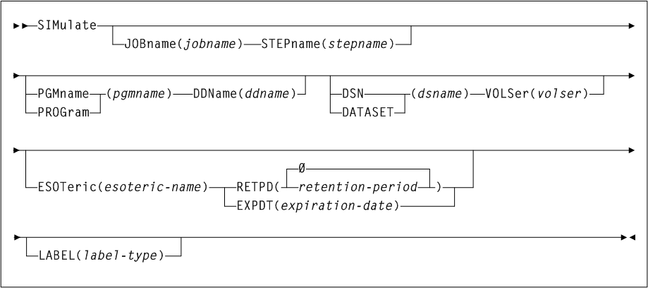

The SMC SIMulate command simulates how SMC would process a single DD job step with a given set of jobstep characteristics. The SIMulate command simulates the allocation influence (SSI24) portion of SMC processing, but not mount processing.
You provide the keyword jobstep parameters to simulate, and the command invokes SMC allocation, policy lookup, and volume lookup. The SIMulate output displays the simulation results.
While SIMulate does not simulate certain jobstep characteristics (such as multiple units, affinity separation, or volref attributes), it does provide a powerful tool to test how changes in SMC policies, including TAPEREQ and POLICY commands, user exits, and TAPEREQ and SERVER changes will affect your production jobs.
You can issue SIMulate command to an active SMC subsystem or via the SMCUSIM utility. The SMCUSIM utility, working with the SIMulate command, produces XML output that can be manipulated as CSV to produce before and after reports to compare how jobs would be processed. See "SMC UUI Simulation Utility (SMCUSIM)" for more information about the SMCUSIM utility.
As shown in Figure 2-33, the SIMulate command includes the following parameters:
optionally, specifies the job name of the simulated job step to test. The format must conform to MVS standards. If not specified, "(any)" is used, which prevents a match to non-generic job names specified in SMS ACS routines or TAPEREQ control statements.
optionally, specifies the step name of the simulated job step to test. The format must conform to MVS standards. If not specified, "(any)" is used, which prevents a match to non-generic step names specified in SMS ACS routines or TAPEREQ control statements.
optionally, specifies the program name of the simulated job step to test. The format must conform to MVS standards. If not specified, "(any)" is used, which prevents a match to non-generic program names specified in TAPEREQ control statements.
pgmname indicates the program name.
optionally, specifies the DD name of the simulated data set to test. The format must conform to MVS standards. If not specified, "(any)" is used, which prevents a match to non-generic DD names specified in TAPEREQ control statements.
ddname indicates the DD name.
optionally, specifies the data set name of the simulated data set to test. The format must conform to non-PDS member MVS standards. If not specified, "(any)" is used, which prevents a match to non-generic program names specified in TAPEREQ control statements.
dsname indicates the data set name.
optionally, specifies the volume serial number of the simulated data set to test. The format must conform to MVS standards. If not specified, "SCRTCH" is used, which simulates a scratch mount.
volser indicates the volume serial number.
optionally, specifies the name of a device esoteric group defining the list of eligible transports used to satisfy the tape request. The specified esoteric must be a defined MVS esoteric. If not specified, the SIMulate command simulates an original esoteric consisting of all known library, non-library, and virtual devices for all TapePlex(es). If the default esoteric is used, it may not correspond to a defined MVS esoteric.
esoteric-name indicates the esoteric name.
optionally, specifies the retention period of the simulated data set to test. The format must conform to MVS standards. If not specified, 0 is used.
retention-period indicates the retention period.
optionally, specifies the expiration date of the simulated data set to test. The format must conform to MVS standards. If not specified, the current date is used.
expiration-period indicates the expiration date.
optionally, specifies the label type to be used to select the policy.
label-type indicates the label type. Specify one of the following:
SL indicates standardlabeled tape. This is the default if the parameter is omitted.
AL indicates ANSIlabeled tape.
NL indicates nonlabeled tape.
NSL indicates nonstandard labeled tape.
SMC SIMulate command output displays the simulated job characteristics and policy sections displaying the SMS, TAPEREQ and SMC policy applied.

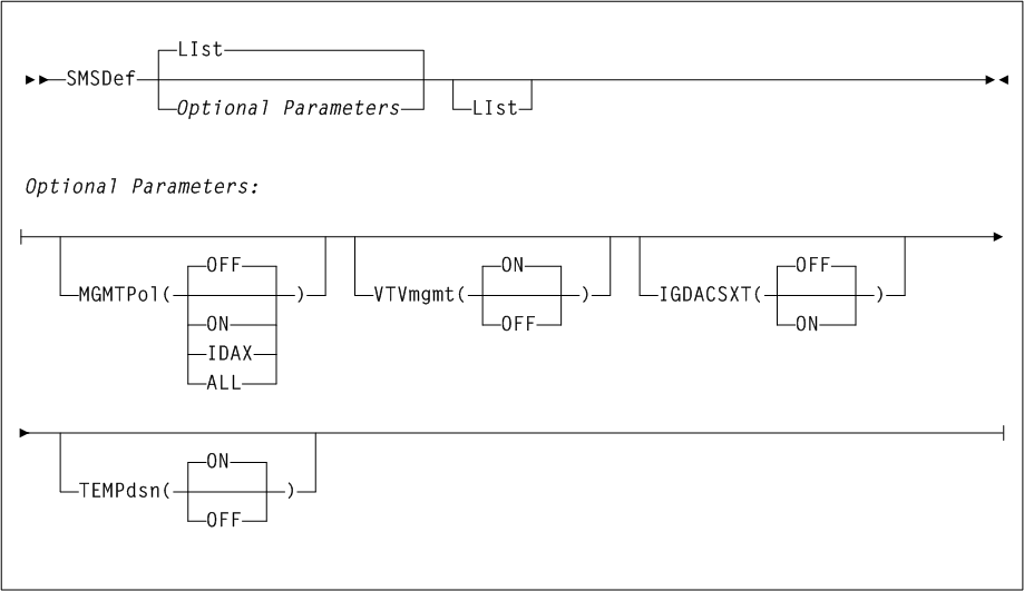

The SMC SMSDef command defines default SMC DFSMS support. This command takes effect when SMC DFSMS support is activated by setting the ALLOCDef SMS parameter value to ON.
During an allocation resulting in a tape mount, the SMC makes up to four calls to the DFSMS ACS routines. The SMSDef command allows you to bypass certain routine calls.

As shown in Figure 2-16, the SMSDef command includes the following parameters:
This command includes additional parameters that apply to the previous DFSMS interface format, which has been superseded by the SMCPOLicy command. Refer to the ELS Legacy Interfaces Reference for information about these legacy parameters.optionally, lists the current DFSMS settings.
LIst is the default when no parameters are specified on the SMSDef command.
optionally, specifies whether the management class returned from a DFSMS ACS routine may represent an SMC policy.
A management class name returned from a DFSMS ACS routine is either ignored (if VTVmgmt if OFF), or is interpreted as a VTCS management class name (if VTVmgmt is ON). This is the default value.
A management class name returned from an SMC DFSMS ACS routine is interpreted as an SMC policy name during allocation and mount message processing, but not during IDAX processing. If a matching SMC policy name is found, all policy information applies to the request. If the policy name is not found, other SMC DFSMS processing is applied as specified.
A management class name returned from an SMC DFSMS ACS routine is interpreted as an SMC policy name during IDAX processing, but not during allocation or mount processing. If the policy name is not found, other SMC DFSMS processing is applied as specified. For example, if ESOT(ON) is specified, the returned storage group is used as a substitution esoteric.
A management class name returned from an SMC DFSMS ACS routine is always interpreted as a policy name. This is the recommended setting.
If the policy name is not found, other SMC DFSMS processing is applied as specified. For example, if VTVMGMT is ON, the DFSMS management class name is interpreted as a VTV management class.
IfMGMTPol is ON, and the matching policy name contains an esoteric, the esoteric name in the policy is used during common allocation to exclude devices not contained in the specified esoteric. It is not used as a ”true” esoteric substitution parameter.optionally, specifies whether the SMC invokes the storage class and management class DFSMS ACS routines during virtual volume allocation and virtual volume mount message processing.
If MGMTPol is OFF, or if MGMTPol is ON but no matching SMC policy name is found, the management class name is provided to VTCS during volume lookup and volume mount processing.
If MGMTPol is ON, the management class name returned by the DFSMS ACS routine is used to look up policy values from the named SMC policy. If no matching SMC policy name is found, no policy is applied to the request.
If MGMTPol is OFF, SMC does not invoke the DFSMS ACS storage class or management class routines during allocation or mount processing.
optionally, specifies whether the SMC invokes the Pre-ACS Installation Exit, IGDACSXT, before invoking the DFSMS ACS routines during SMC DFSMS processing. Refer to the IBM publication DFSMS Installation Exits for more information about this exit.
The IGDACSXT exit is invoked before the SMC calls the DFSMS ACS routines. The exit receives the ACERO control block that contains the read only variable settings. The exit has the opportunity to change these settings before SMC invokes the DFSMS ACS routines.
The IGDACSXT exit is not invoked before the SMC calls the DFSMS ACS routines.
optionally, specifies whether temporary data sets are presented to the DFSMS ACS routines as permanent data sets so that a MGMTCLAS may be returned.
The &DSTYPE read only variable is set to 2 (indicating a permanent data set) if the original data set is a temporary data set.
The &LIBNAME read only variable will contain the character 3 if the &DSTYPE read only variable is changed.
ON is the default setting.

The SMC STORMNGR command defines a VLE to SMC.
STORMNGR and SERVer commands are required to access a VLE. The STORMNGR command can also list VLEs that the SMC tries to communicate with and report their status.As shown in Figure 2-35, the STORMNGR command includes the following parameters:
Specifies VLE to be defined, modified or listed. This name is also defined to VTCS, and is initially defined by the VLE GUI. If name is not specified, then all VLEs are listed.
enables the specified VLE. This is the default when new VLE is added.
disables the specified VLE.
optionally, lists VLE information.
If name is also specified, only the named VLE is listed. If name is not specified, then all VLEs are listed.
optionally, lists defined VLEs, their attributes and associated servers.
optionally, lists current status of all VLEs or a single named VLE.

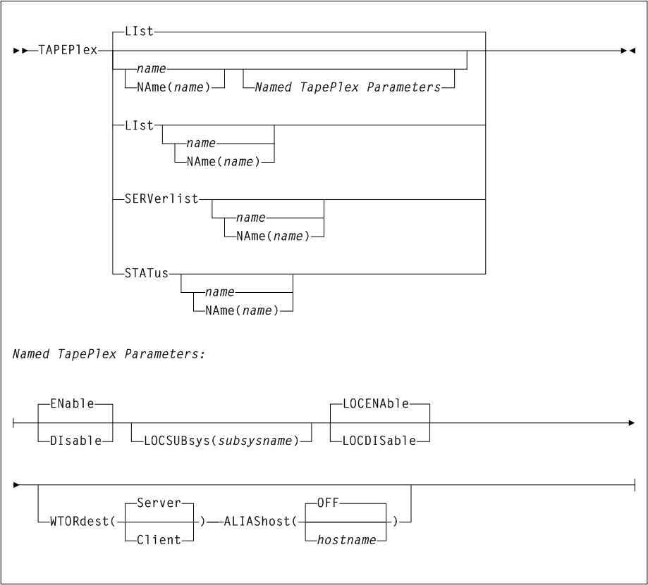

The SMC TAPEPlex command defines a TapePlex; a specific Oracle StorageTek tape hardware configuration normally represented by a single CDS. The TAPEPlex command can also list TapePlexes that the SMC tries to communicate with, and report their status.
TAPEPlex and SERVer commands are required to access remote HSC TapePlexes.
At least one TapePlex must be defined to allow SMC to initialize.
As shown in Figure 2-36, the TAPEPlex command includes the following parameters:
specifies the TapePlex name to be added, modified, or listed.
optionally, lists TapePlex information.
If name is also specified, only the named TapePlex is listed. If name is not specified, then all TapePlexes are listed.
LIst is the default when no parameters are specified on the TAPEPlex command. In this case, all TapePlexes are listed. LIst may be specified with other parameters. In this case, the named TapePlex is listed after the other parameters are processed.
optionally, lists defined TapePlexes, their attributes and associated servers.
If name is also specified, then only the named TapePlex servers are listed. If name is not specified, then all servers are listed.
optionally, lists current status of all TapePlexes, or a single named TapePlex. The TapePlex status indicates whether a TapePlex is active, inactive, or disabled. For an active TapePlex, the status lists the name of the current server or local subsystem.
If name is also specified, then only the named TapePlex status is listed. If name is not specified, then the status of all TapePlexes is listed.
optionally, enables the specified TapePlex to be selected for allocation or mount requests.
optionally, disables the specified TapePlex. The TapePlex is not used for any allocation or mount requests.
optionally, specifies a local HSC and/or MVS/CSC subsystem.
subsysname indicates the subsystem name.
optionally, enables the specified HSC or MVS/CSC subsystem to be used as a local path to the TapePlex.
optionally, disables the specified HSC or MVS/CSC subsystem. LOCDISable can be used to force the SMC to ignore the local subsystem and access the TapePlex via a remote server.
optionally, specifies the console to which HSC WTOR messages are directed. Refer to Oracle's ELS publication Configuring and Managing SMC for messages that apply.
The remote HSC returns selected WTORs to the SMC client without issuing the WTOR message. The SMC client then issues the WTOR to the operator of the system that the SMC executes on. The SMC redrives the mount or dismount request to the server supplying the WTOR response.
WTOR messages are issued on the HSC server console. This is the default.
optionally, specifies a host alias to be used in communications with the HSC TapePlex.
a 1-8 character host name.
The native SMF host name is used in communications with the HSC library. This is the default.

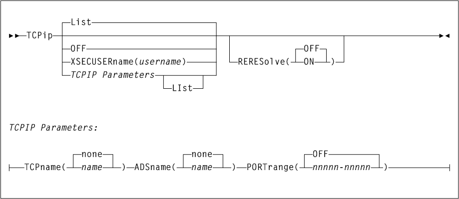

The SMC TCPip command enables you to alter and/or lists current TCPNAME and ADSNAME defaults for your TCP/IP communications environment. You can use this command to direct TCP/IP requests to a specific TCP/IP stack on an MVS host.
As shown in Figure 2-37, the TCPip command includes the following parameters:
optionally, lists current TCPNAME and ADSNAME settings.
LIst is the default when no parameters are specified on the TCPip command.
optionally, specifies that system defaults are used for client TCP/IP communication.
optionally, specifies whether SMC attempts to re-resolve the SERVER HOST name after a communication failure.
SMC does not attempt to re-resolve the server host name. This is the default.
SMC attempts to re-resolve the server host name.
SMC first attempts a retry as specified by the SERVER RETRY parameter. If the error indicates that the IP address may be unavailable, and the RERESolve parameter is ON, SMC then attempts to resolve the HOST name again, and if a new IP address is generated, retries the transaction.
optionally, specifies the XAPI user name associated with all transactions originating from this client. This user name will only be used when a login challenge is issued by the targeted server.
username indicates the XAPI user name.
The sameUSER must be defined on both the client and server using the XUDB command. See "XUDB" for more information.These parameters are mutually exclusive with OFF or RERESolve.
optionally, specifies the TCPNAME value for a specific TCP/IP stack on an MVS host. TCPNAME is the name of the MVS TCP/IP stack. Refer to the IBM publication TCP/IP for MVS Application Programming Interface Reference for more information about TCPNAME. The default is none.
name indicates the TCPNAME value. The default is none.
If a subsystem name is specified, it must consist of one to four alphanumeric or national (#,@,$) characters, the first character being alphabetic or national.
If an address name is specified, it must consist of one to eight alphanumeric or national characters.
optionally, specifies the ADSNAME value for a specific TCP/IP stack on an MVS host. ADSNAME is the jobname of the TCP/IP startup job. Refer to the IBM publication TCP/IP for MVS Application Programming Interface Reference for more information about ADSNAME.
name indicates the ADSNAME value.
optionally, specifies a range of ports to be used by the SMC to bind() sockets on the client when communicating on remote server paths.
When PORTrange is defined, the SMC binds() client sockets to one of the ports within the specified PORTrange and will not use client ports outside the PORTrange. This allows the SMC to operate behind a firewall that restricts communication to known ports. A unique port is required for each concurrent subtask requiring communication services for a volume lookup, mount, etc. If a PORTrange is not defined, then any ephemeral port is used by the SMC.
Only one PORTrange can be active at a time, but you can dynamically re-define the PORTrange even if the new PORTrange overlaps with the old PORTrange.
the port number range. Each port number can have a value of 1-65535. However:
The minimum port number range that can be specified is 10 (for example, 6400-6410).
The maximum port number range that can be specified is 1000 (for example, 6400-6500).
PORTrange logic is disabled. As a result, any ephemeral port is used.
It is recommended that you specify a PORTrange that does not conflict with TCP/IP well-known ports.
It is recommended that you specify a PORTrange greater than the anticipated number of concurrent subtasks requesting remote communication services. For most installations, a PORTrange of 40 ports is sufficient. However, if SMC0128 messages are produced with a return code indicating no free port then a larger PORTrange is required.
When an SMC mount request to the HSC server results in an outstanding WTOR on the HSC, the used port number is unavailable until a reply is supplied for the outstanding WTOR. WTOR messages for mount requests are produced on the HSC when TAPEPlex WTORdest(SERVER) is specified, or when TAPEPlex WTORdest(CLIENT) is specified and the HSC mount message is not one returned to the SMC for processing. Refer to the publication Configuring and Managing SMC for messages that apply.
The TCPip LIST command may be used to display the high-water port number, indicating the largest number of concurrent communication subtasks executing at one time.

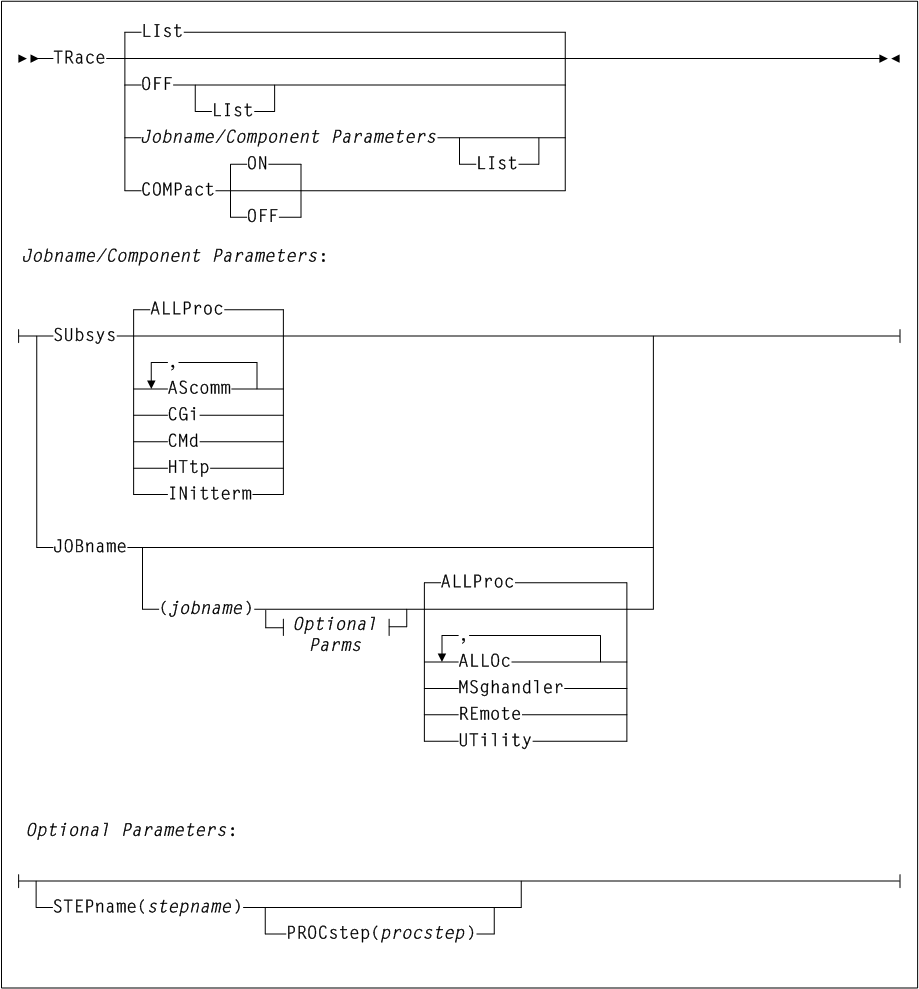

The SMC TRace command enables SMC tracing using the GTF trace facility and optionally provides a snap dump of the address space before and after control block modification.
SMC TRace processing may impact system performance and should be used only as directed by Oracle StorageTek Software Support.
TRace JOBname(jobname) causes SMC traces to be produced for UUI commands issued by the HSC or VTCS subsystem address space when jobname matches the HSC subsystem name. UUI tracing is extremely CPU intensive and should only be used as directed by Oracle StorageTek Software Support.
As shown in Figure 2-38, the TRace command includes the following parameters:
optionally, lists current SMC trace settings for both the SMC subsystems and SMC components by job name, step name, and PROC step.
LIst is the default when no parameters are specified on the TRace command.
If no JOBname is specified, all jobs with SMC components being traced are listed.
If JOBname is specified, only those jobs with SMC components being traced whose job name matches the specified job JOBname are listed.
optionally, disables SMC tracing.
If no other parameters are specified, tracing is disabled for all jobs.
If only JOBname is specified, tracing is disabled for all entries for that job name.
If JOBname, STEPname and PROCstep are specified, tracing is disabled only for the specified entry.
Optionally, indicates whether SMC trace output should be produced in "compact" format.
When GTF trace output is produced in this format, you can use the SMC utility program SMCUGTF to reformat the trace to the original SMC trace format. See "Trace Format Utility (SMCUGTF)".
SMC trace output is produced in a format that conserves GTF data set space. This is the default.
SMC trace output is produced in human readable format.
optionally, enables or disables SMC tracing for one or more SMC subsystem components or subtasks.
optionally, enables tracing for all SMC subsystem components and tasks. This is the default if no parameters are specified.
optionally, enables tracing for all SMC subsystem ASCOMM Component tasks.
optionally, enables tracing for all SMC subsystem CGI module processing for all connected client requests. To trace CGI module execution for individual client requests, issue a TRace JOBname REMOTE command on the appropriate SMC client.
optionally, enables tracing for all SMC subsystem Operator Command Component tasks.
Optionally, enables tracing for all SMC subsystem HTTP Server Component tasks.
Optionally, enables tracing for all SMC subsystem Initiation/Termination Component tasks.
optionally, enables or disables SMC tracing for one or more initiator components in initiators that match the specified jobname, stepname, and procstep name specified. If not specified, tracing information for all jobs is displayed.
jobname is a specific job name. The value entered must be one to eight characters in length. An asterisk (*) can be used as a wildcard when included as the last character. In this case, all jobs whose job names match the characters preceding the asterisk are traced or listed. To trace all jobs, specify TRACE JOB(*).
optionally, enables tracing for all SMC initiator components executing in initiators that match the specified jobname, stepname, and procstep name specified. This is the default if no parameters are specified.
optionally, enables tracing for all SMC Allocation tasks executing in initiators that match the specified jobname, stepname, and procstep name specified.
optionally, enables tracing for all SMC Message Handler Component tasks executing in initiators that match the specified jobname, stepname, and procstep name specified.
optionally, enables tracing in the remote SMC HTTP Server for requests originating from the jobname, stepname, and procstep name specified.
Remote tracing does not rely on the GTF trace being active on the SMC client, but GTF tracing must be active on the corresponding SMC HTTP Server.
optionally, enables tracing for all SMC Utility Component tasks executing in initiators that match the specified jobname, stepname, and procstep name specified.

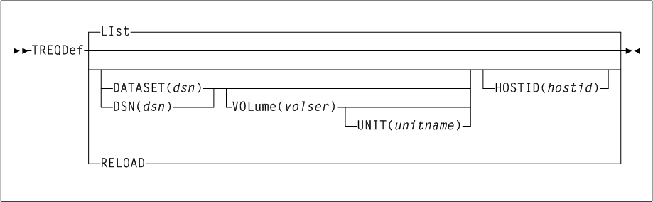

The SMC TREQDef command specifies and loads the definition data set containing your tape request (TAPEREQ) parameter statements.
Existing HSCTREQDEF control statements are not disabled, but are only processed for remote SMC 6.0 client systems.As shown in Figure 2-39, the TREQDef command includes the following parameters:
lists information about the definition data set containing TAPEREQ control statements that are currently loaded. Information includes:
Data set name
Member name
Identifying string (if the data set contains an OPTION TITLE statement)
Date and time parameters were loaded
LIst is the default when no parameters are specified on the TREQDef command.
optionally, specifies the name of the data set containing the TAPEREQ control statements to be processed and, optionally, an OPTION TITLE control statement.
dsn indicates the data set name. This data set can be a fixed length 80-byte sequential data set, or a fixed length 80-byte member of a PDS. If the data set name includes a member name, you must enclose the data set name in quotes. For example:
DATASET(’YOUR.PDS.DSN(MEMBER)')
optionally, specifies the hostid from which to execute this control statement. This parameter is valid only for use in PARMLIB, to allow multiple systems to share a parmlib member containing multiple TAPEREQ control statement members.
hostid indicates the host name(s) from which to execute this control statement. Multiple host names must be separated by commas.
optionally, reloads the currently loaded TAPEREQ control statements from the same data set. This parameter can be used after a TREQDEF DSN(dsn) command is issued, and changes may then be made to the contents of that data set.

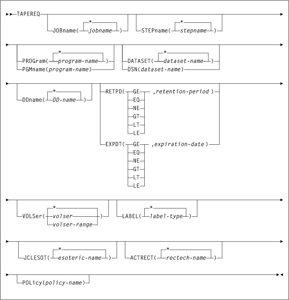

The SMC TAPEREQ control statement specifies a named POLicy to be applied to a particular job name, step name, program name, data set or group of data sets.
TAPEREQ statements are placed in the definition data set (DDname) specified by the SMC TREQDEF command. SMC allocation calls on these TAPEREQ statements to help ensure that the correct media type is used to satisfy a request, and that the cartridge is mounted on the appropriate device. TAPEREQ statements must be placed in the definition data set; they cannot be issued as operator commands.
The SMC POLicy command enables you to specify all tape policy specifications in a single named object. It is used with TAPEREQ statements or SMS to associate a named policy with an allocation or mount event.
The TAPEREQ POLicy parameter directs the SMC to reference an associated SMC policy defined by an SMC POLicy command. Refer to Oracle's ELS publication Configuring and Managing SMC for more information.
If any of the following conditions exist, then the MEDia and RECtech or MODel parameters are set to undefined, which matches all requests. Any available device is eligible for allocation.
There is no TAPEREQ control statement specified in the definition data set to match a request.
There is no matching Policy command specifying the MEDia, RECtech, or MODel parameters.
There is no definition data loaded.
In previous software releases, TAPEREQ parameters were used to define tape attributes. Refer to Oracle's ELS publication ELS Legacy Interfaces Reference for information about these legacy parameters.
See "TREQDef" for information about the TREQDEF command.
As shown in Figure 2-40, the TAPEREQ control statement includes the following parameters:
TheJOBname, STEPname, PROGram, and DATASET parameter values can include the following wild card characters:
% or ? indicates any single nonblank character.
* indicates any character string (length zero to 8) not to exceed one qualification level. For example, A.B.* matches A.B and A.B.C, but does not match A.B.C.D.
** used only in DATASET, indicates any number of qualifiers (zero or more). Cannot be used with any other characters within a qualifier. For example, A.B.** matches A.B, A.B.C, A.B.C.D, A.B.C.D.E, and so forth.
optionally, identifies the job name. If JOBname is not specified, the default value is *.
jobname indicates the name of the job for which the TAPEREQ control statement is processed.
The TAPEREQ control statement is used only when the specified jobname matches the job name in the request.
If you are coding aTAPEREQ statement for DFHSM, you must specify JOBname as a selection criteria. Using DATASET (DSN) can cause unpredictable results.optionally, specifies the step name. If the STEPname parameter is not specified, the default value is *.
stepname indicates the name of the step for which the TAPEREQ control statement is processed. The TAPEREQ control statement is used only when the specified stepname matches the step name in the request.
optionally, specifies the program name.
The program name used is the job step program name. The default value is *.
program-name indicates the program name for which the TAPEREQ control statement is processed.
The TAPEREQ control statement is used only when the specified program-name matches the program name in the request.
This parameter is not supported in JES3 environments.optionally, specifies the data set name. The default value is **.
dataset-name indicates the data set name for which the TAPEREQ control statement is processed.
The TAPEREQ control statement is used only when the specified dataset.name matches the data set name in the request. Rules for RACF and SMS enhanced generic naming apply.
If you are coding a TAPEREQ statement for DFHSM, you must specify JOBname as a selection criterion. Using DATASET (DSN) can cause unpredictable results.
The name you specify on this parameter might be different from the value coded in the DSN parameter on a DD statement. For example,
DSN=&&ABC
may be coded on a DD statement if a data set is temporary. However, the actual data set name is not &&ABC. Similarly, if the DSN parameter refers back to a previous DD statement, the data set name is resolved to the referred-to data set. Thus, the data set name referred to must be coded on the DATASET parameter in order for the TAPEREQ control statement to be processed.
optionally, specifies the DD name of the data set.
DD-name indicates the DD name.
optionally, specifies the retention period and the relationship that must exist. If you do not specify either RETPD or EXPDT, the default value is RETPD(GE,0) (any expiration date will match this criterion).
EQ - Equal to.
NE - Not equal to.
GT - Greater than.
GE - Greater than or equal to.
LT - Less than.
LE - Less than or equal to.
retention-period indicates the retention period in days for the data set. Specify the number of days as a 1- to 4-digit decimal number. This parameter is not supported in JES3 environments.
This parameter is not supported in JES3 environments.optionally, specifies the expiration date and the relationship that must exist.
EQ - Equal to.
NE - Not equal to.
GT - Greater than.
LT - Less than.
expiration-date indicates the expiration date of the data set in YYDDD or YYYY/DDD format.
This parameter is not supported in JES3 environments.optionally, identifies a specific volume id or range of volsers. If VOLSer is omitted, the default value is * (any volume).
Using a combination of TAPEREQ statements and POLicy commands, SMC enables you to specify allocation policy based on specific volume serial numbers. Refer to Oracle's ELS publication Configuring and Managing SMC for more information.
volser or volser-range indicates the volume id or a range of volumes.
VOLSer requires that the POLicy parameter is also specified.
LABEL is valid only if POLicy is also specified.
optionally, specifies the name of a device esoteric group to be matched with the esoteric supplied in the JCL (or via IDAXESOT).
esoteric-name indicates the esoteric group name.
This can consist of one to eight alphanumeric or national (#, @, $) characters. A slash (/) or hyphen (-) is also valid.
JCLESOT is valid only if POLicy is also specified. JCLESOT only matches at SSI55 (IDAX) or SSI24 (allocation) time, such that a POLICY containing SUBPOOL and MGMTCLAS will not be selected by this parameter.
The following example illustrates the use of the JCLESOT and ACTRECT parameters:
TAPEREQ DSN(V047970.JCLESOT.*) JCLESOT(HVTSS11) POLICY(POL1) TAPEREQ DSN(V047970.JCLESOT.*) ACTRECT(V) POLICY(POL1) TAPEREQ DSN(**) POLICY(POL2) POLICY NAME(POL1) MED(V) REC(V) MGMT(HSCX400) SUBP(SUBP1) POLICY NAME(POL2) MED(ECART)
In this example, jobs that specify UNIT=HVTSS11 (with the matching DSN) will be assigned a VIRTUAL media and rectech at SSI55/SSI24 time. All other data sets will be assigned a media of ECART. At mount message time, if the recording technique of the allocated drive is virtual for the matching DSN, then the management class and subpool from POL1 are assigned. Otherwise, no subpool or management class is assigned.
optionally, specifies the recording technique to be used to determine the policy at mount time if the drive where the mount is requested conflicts with the previously selected policy, or if there is no previously selected policy.
For example, if the JCL esoteric prevents selection of a policy recording technique or esoteric substitution, the selected policy might have a scratch subpool inconsistent with the drive where the mount is requested.
Also, if criteria that are not available at mount time, such as JCLESOT, are used for policy selection, SMC mount processing may not have a policy available to assign mount parameters such as SUBPOOL and MGMTCLAS. Specifying ACTRECT allows a default override.
rectech-name indicates the recording technique name.
ACTRect is valid only if POLicy is also specified.
optionally, specifies the name of a policy (defined by an SMC POLicy command) to be associated with the allocation or mount request.
The SMC uses this policy name to determine all policy information associated with an allocation or mount request.
The named policy must be defined using a POLicy command before the TREQDEF command is processed.
See "POLicy" for more information about the SMC POLicy command. Refer to Oracle's ELS publication Configuring and Managing SMC for information about creating new POLicy definitions based on existing TAPEREQ statements.
Use the following procedure to disable a TAPEREQ definition:
Edit the definition data set containing the current TAPEREQ control statements.
Delete the parameters of the TAPEREQ control statement you want to disable, or delete the TAPEREQ control statement.
Issue the TREQDEF operator command to reload the definition data set.
To disable all TAPEREQ definitions, load a definition data set that contains only one TAPEREQ control statement with no parameters.
If any individualTAPEREQ control statement is in error, the entire set is discarded.Interfaces:

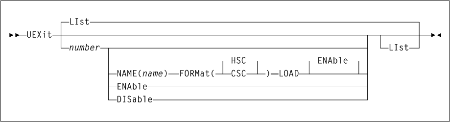

The SMC UEXit command defines the load module invoked for a specific user exit, and specifies whether the user exit is enabled or disabled.
User exits 1, 2, 4, 8, 9, 10, 11, 12, and 13 are invoked and managed by the SMC.
The SMC UEXit command defines which load module is invoked for a specific user exit, and whether the user exit is enabled or disabled.
User exits 1, 2, 4, 8, 9, 10, 11, 12, and 13 are invoked and managed by the SMC. Both HSC and MVS/CSC user exit formats are supported. Use the UEXit command to specify the user exit format.
Use this command to load each user exit you wish to use. If a user exit is not loaded, it will not be called.
All user exits are executed on the host where the SMC resides, regardless of where the library server resides.
Only one format of a given user exit can be invoked, regardless of the number of TapePlexes the SMC interacts with. The desired format (HSC or MVS/CSC) is specified using the FORMat parameter.
HSC User exit 7 (SLSUX07) is no longer supported.
These user exits must reside in a library accessible to the subsystem.
User exit information is not honored when an SMC POLicy applies to an allocation, or a mount.
Refer to Oracle's ELS publication ELS Legacy Interfaces Reference for information about each user exit.
As shown in Figure 2-41, the UEXit command includes the following parameters:
optionally, displays status information for all user exits.
LIst is the default when no parameters are specified on the UEXit command.
optionally, specifies the user exit number. Valid values are 1, 2, 4, 8, 9, 10, 11, 12, and 13.
optionally, specifies the user exit's load module name.
name indicates the load module name (for example, SLSUX01).
optionally, specifies the format of user exit to be enabled or disabled.
the HSC user exit format.
the MVS/CSC user exit format.
optionally, loads the specified user exit, making it available for use.
If a user exit is not loaded, it will not be called. A subsequent load of a module for the same user exit causes the currently active copy of the load module to be deleted when its use count reaches zero.
optionally, enables a user exit that was previously disabled due to a problem.
optionally, disables a user exit to allow for problem resolution.

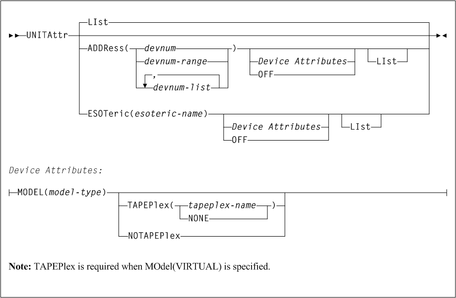

The SMC acquires drive type information from both the z/OS operating system and the ELS library control systems (TapePlexes). For the ELS library control systems, HSC data returned from configuration queries is used to augment information returned from the operating system for library-controlled devices.
The SMC UNITAttr command enables you to specify device addresses and attributes to augment operating system information for nonlibrary controlled devices, and effectively ignore configuration information from TapePlexes for specified devices when multiple TapePlexes define the same device address. The SMC UNITAttr command enables you to do the following:
Set MODEL=IGNORE for device addresses not available for this host.
Specify model types for nonlibrary devices on this host.
Specify NOTAPEPlex for a nonlibrary device address or range that is defined to multiple TapePlexes, but for this host the attached devices belong to the specified TapePlex.
Specify TapePlex ownership and model for devices that may be referenced by a mount after the SMC is started but before the TapePlex is initialized.
Refer to Oracle's ELS publication Configuring and Managing SMC for information about configurations that may require or benefit from the use of UNITAttr commands.
Existing HSC UNITATTR control statements are not disabled. However, UNITATTR statements for nonlibrary and MODEL(IGNORE) devices are only processed for remote SMC 6.0 client systems. HSC UNITATTR statements for library and virtual drives are not used in any HSC processing after release 6.0.
SMC does not support a UNITDEF command. Each UNITATTR command is parsed and processed independently.
HSC nonlibrary and MODEL=IGNORE UNITATTR statements are no longer returned to SMC on a configuration query. Therefore, if you use UNITAttrs to bypass devices for allocation or to define the device type of nonlibrary drives, you must define these UNITATTR commands to the SMC subsystem.
As shown in Figure 2-42, the UNITAttr command includes the following parameters:
optionally, specifies device numbers for which UNITAttr device attributes are assigned.
optionally, specifies an esoteric for which UNITAttr device attributes are assigned. When device characteristics are modified, all of the devices in the specified esoteric are modified.
esoteric-name indicates the MVS esoteric name. This name must be defined to MVS, and must contain only tape devices known to SMC.
optionally, specifies that the model type for the device numbers specified by the ADDRess parameter or ESOTeric parameter should be determined from the device UCB, or, for a device which was previously set to MODEL=IGNORE, that the MODEL information from the library server should be restored.
lists the UNITAttr model information for the device numbers specified by the ADDRess or ESOTeric parameter.
optionally, specifies the model type of the transport to be assigned the device numbers specified by the ADDRess parameter.
optionally, specifies the name of a TapePlex to be associated with the drive before communication is established.
TAPEPlex is required when MOdel(VIRTUAL) is specified. MOdel(VIRTUAL) drives cannot exist as "non-library" devices.
the TapePlex name.
If specified, this name must match a TapePlex name defined in a TAPEPlex command.
optionally, removes the TapePlex association from the specified device addresses.
optionally, specifies that the specified address or address range are nonlibrary devices, even when configuration queries from ELS library control systems indicate that the device is library controlled. Use this parameter when a local nonlibrary device address overlaps a TapePlex owned device that is not accessible from his host.
When a MOdel is specified with TAPEPlex, the configuration query model information returned from the TapePlex is assumed to be the ”real” or ”correct” model, and it overrides any MOdel specified in the UNITAttr command.
If TAPEPlex is specified for an address, but that address is not returned from the configuration query for that TapePlex, an error message is issued, but the erroneous TapePlex ownership remains with the specified device address. As a result, any mounts destined for the specified device address are not automated and are rejected by the specified TapePlex.

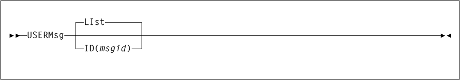

The SMC USERMsg command enables you to specify additional message identifiers for messages to be intercepted and passed to the library subsystem's user exit 01. You can also use this command to list the message identifiers for messages that have been defined using the USERMsg command.
As shown in Figure 2-43, the USERMsg command includes the following parameters:
optionally, lists the message identifiers in the customer-defined message table. This is the default if no parameters are specified.
optionally, specifies a message to be added to the customer-defined message table. This message is passed to user exit 01.
msgid indicates the message identifier for the message to be added.
This parameter may only be specified in theSMCPARMS data set.Interfaces:

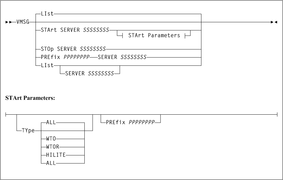

The SMC VMSG command enables you to start or stop the Virtual Storage Manager console (VSMc) message processor client. The VMSG message processor client enables the local SMC subsystem to receive and reply to messages issued by the remote VSM console server.
As shown in Figure 2-44, the SMC VMSG command includes the following parameters:
optionally, displays VMSG task status information.
optionally, lists only the VMSG processor for the named server.
SSSSSSSS indicates the server name. If specified, then the named server must have been previously defined by an SMC SERVer command.
LIst is the default when the STArt, STOp, or PREfix keywords are not specified.
optionally, starts a VMSG message processor client.
specifies the server name for the VMSG processor.
SSSSSSSS indicates the server name. The server name is required and must have been previously defined by an SMC SERVer command.
optionally, defines a type-list containing one or more type(s) of messages that are received by the VMSG client.
Specify one or more of the following in the type-list, using a comma to separate values:
Receive all messages. This is the default. If ALL is specified, it cannot be specified with any other message types. This is the default.
Receive highlighted WTO messages.
Receive non-highlighted WT0 messages.
Receive messages that require a reply.
optionally, specifies the message prefix identifier that will identify messages from this VSM console server in the SMC subsystem log. If not specified, then the specified server name is used as the message prefix.
PPPPPPPP is the message prefix identifier. The prefix can be a maximum of 8 characters in length and can contain any combination of the following:
A-Z
0-9
optionally, stops a VMSG message processor client.
PPPPPPPP indicates the message prefix identifier. The prefix can be a maximum of 8 characters in length and can contain any combination of the following:
A-Z
0-9

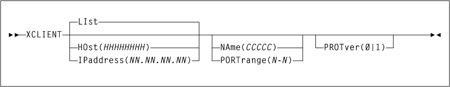

The SMC XCLIENT command enables you to define XAPI clients that use a different protocol version than the default server XAPI security protocol.
The XCLIENT command is only necessary to define clients that use the older "unsecure" protocol. If an XAPI request originates from a client that is not defined with a XCLIENT command, it will be challenged to produce XAPI login credentials.
If you have back-level ELS or non ELS clients communicating with your ELS 7.3 SMC HTTP server, then they must be defined as protocol version 0 clients with the XCLIENT command.
The entire XCLIENT command is not echoed in the SMC0000 message.
XCLIENT (suppressed) is echoed for all XCLIENT commands.
The entire XCLIENT command is not logged when the SMC LOG command is active.
XCLIENT (suppressed) is logged for all XCLIENT commands.
XCLIENT commands must be specified before any HTTP or SERVer commands.
As shown in Figure 2-45, the XCLIENT command includes the following parameters:
optionally, displays all XCLIENT settings. LIst is the default when no parameters are specified on the XCLIENT command.
optionally, specifies the IP resolver host name on which the client resides.
HHHHHHHH indicates the name of the client. The HOst name must be a resolvable name in the TCP_IP name table. The following rules apply:
The first character must be an alpha character or a digit.
The last character must be an alpha character or a digit.
Any character between the first and last must be either an alpha character, digit, hyphen, or dot.
optionally, specifies the IP address for the client.
NN.NN.NN.NN indicates The TCP/IP address.
IPaddress and HOst are mutually exclusive.optionally, specifies the name of the client. If the client is SMC/MVS, the NAme specified should be the name returned as client_subsystem_name. Otherwise, the NAme specified should be the name returned in the client_name. If NAme is specified as "*", then any request from the specified HOst or IPaddress will be defined as using the specified protocol version.
CCCC indicates the name of the client.
optionally, specifies the range of client ports from which the XAPI request originates on the specified HOst or IP address that are allowed to use the specified protocol version.
NNNNN-NNNNN indicates the port range. Valid ports are 1 to 65535. The range may contain 10 to 1000 ports.
UsePORTrange if the SMC/MVS TCPIP PORTRANGE command has been specified to restrict SMC/MVS client ports to the specified range. NAme and PORTrange are mutually exclusive.optionally, specifies the protocol version. The default is 0.
0 indicates the older "unsecure" protocol version.
1 indicates the XAPI security protocol version.

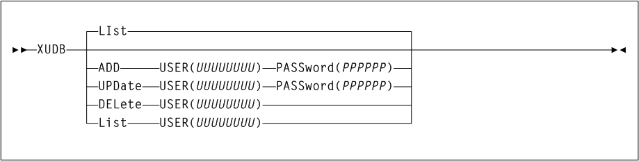

The SMC XUDB command enables you to add, update, delete, and list XAPI Security users.
The XAPI security user list is maintained by both the client and server. In cases where the client and server reside on the same host (that is, SMC/MVS), the XUDB user list is shared.
The same USER must be defined on both the client and server.
A USER is unique by SERVER. If the same SMC HTTP server is servicing multiple TAPEPLEXes, any defined users will have access to all TAPEPLEXes.
The entire XUDB command is not echoed in the SMC0000 message.
XUDB (suppressed) is echoed for all XUDB commands.
The entire XUDB command is not logged when the SMC LOG command is active.
XUDB (suppressed) is logged for all XUDB commands.
The XUDB commands must be specified before any HTTP, SERVer or TCPip commands.
As shown in Figure 2-46, the XUDB command includes the following parameters:
displays the specified user on the XAPI security list. LIst is the default when no parameters are specified on the XUDB command. In this case, all users are listed.
specifies the user name to be listed. UUUUUUUU indicates the user name.
specifies that the specified user name or password is to be added to the XAPI Security list.
specifies the user name to be added. UUUUUUUU indicates the user name.
specifies the user password. PPPPPP indicates the password.
specifies that the specified user name or password is to be updated in the XAPI Security list.
specifies that the specified user/password is to be deleted from the XAPI Security list.
Oracle recommends that you maintain the XAPI Security user list in a sequential data set, to include XUDB ADD entries for the XAPI Security user list.
In your SMC startup parameters, include an SMC READ command for your XAPI security data set.
The XUDB ADD/UPDATE/DELETE command can be used to modify the XAPI Security user list on the operational SMC/MVS. Any changes must also be reflected in the XAPI SECURITY data set.
The XAPI Security data set will be secured by SAF(RACF) permissions.
