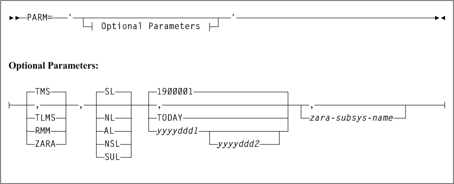

  • Tape Management Extract utility (SMCUDBX)
    This utility supports scratch synchronization between the SMC client host and the HSC CDS.

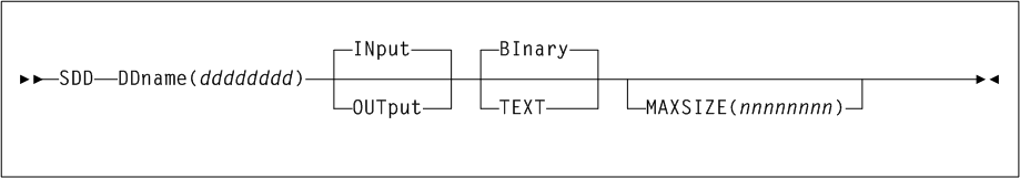

SDD Command
The SDD command defines an input or output data set to be associated with a ”real” HSC or VTCS command that immediately follows it.
In the following example, the SDD command is associated with the IMPORT command, but not the subsequent VTVRPT command:
SDD DDNAME(MAININ) INPUT BINARY
IMPORT MANIFEST(MANIIN)

The SDD command can be used in either the SLUADMIN or SMCUUUI utility. However, only the SMCUUUI utility supports remote UUI command execution.
Syntax
The following figure shows the syntax for the SDD command:
Figure 4-1 SDD command syntax
Surrounding text describes Figure 4-1 .
Parameters
DDname(dddddddd)
the name of the JCL DD that either contains the additional non-command line input, or will contain the output data set upon command completion.
INput|OUTput
optionally, specifies whether the data set specified by the DDname parameter is an input or output data set.
INput specifies that the data set is read to supply additional non-command line input to the command. This is the default if neither INput or OUTput are specified.
OUTput specifies that the data set is written to contain the non-XML, non-text, non-CSV output produced by the command.
BInary|TEXT
optionally, specifies whether the data read or produced contains Binary (that is, non display) characters, or is in SLSIN TEXT command format.
If you specify TEXT along with the INput parameter, this specifies that the input data is in SLSIN format. Only the first 72 characters are read and continuation characters may be present. Comment statements are not passed to the HSC or VTCS command that follows.
BInary is the default if neither BInary or TEXT is specified.
You must specify TEXT when the SDD control statement is to be associated with the VTCS CONFIG command.
MAXSIZE(nnnnnnnn)
optionally, specifies the maximum size (in K units) of the input or output file. If MAXsize is not specified, there is no limit to the maximum size.
CONFIg Command Example

Syntax
SMCUDBX uses program parameters to determine the Tape Management System interface (SLUDR*) routine to invoke and method of operation. See Appendix C, "Tape Management System Interface (SLUDR*) Routines" for more information about these routines.
You can specify the following values for the PARM parameter on the JCL EXEC statement when running the SMCUDBX utility:
You must enter parameters in the specified order and include commas for omitted parameters.
The following figure shows syntax for the SMCUDBX utility:
Figure 4-3 SMCUDBX PARM parameter syntax
Surrounding text describes Figure 4-3 .
Parameters
PARM=
specifies the parameters that follow can be accessed by the program indicated in the PGM parameter in the JCL.
TMS
optionally, specifies the CA-1 tape management system (TMS). This is the default.
TLMS
optionally, specifies the TLMS: CA-DYNAM/TLMS tape management system.
RMM
optionally, specifies the DFSMSrmm tape management system.
ZARA
optionally, specifies the ZARA tape management system.
SL
optionally, specifies standard label type for the scratch volume selection. This is the default.
NL
optionally, specifies nonlabeled type for the scratch volume selection.
AL
optionally, specifies ANSI label type for the scratch volume selection.
NSL
optionally, specifies nonstandard label type for the scratch volume selection.
SUL
optionally, specifies standard user label type for the scratch volume selection.
The following date-related parameters specify the date or date range when a volume became scratch in the TMC.
Date Related Parameters
1900001
optionally, specifies January 1, 1900 as the date. This is the default.
TODAY
optionally, indicates the current system date. Only volumes placed in scratch status on this date are processed.
yyyyddd1
optionally, the "from" date. The "to" date defaults to the current system date. All specified dates are in Julian notation.
All volumes placed in scratch status starting on day yyyyddd1 through today's date are processed.
yyyyddd1-yyyyddd2
optionally, the date range in which the volumes became scratch. Neither of these dates can be greater than the current system date.
All volumes placed in scratch status starting on day yyyyddd1 through day yyyyddd2 are processed.
zara-subsys-name
Specifies the subsystem name for the Zara tape management system, where zara-subsys-name is the four-character name. The default subsystem name is ZARA.
