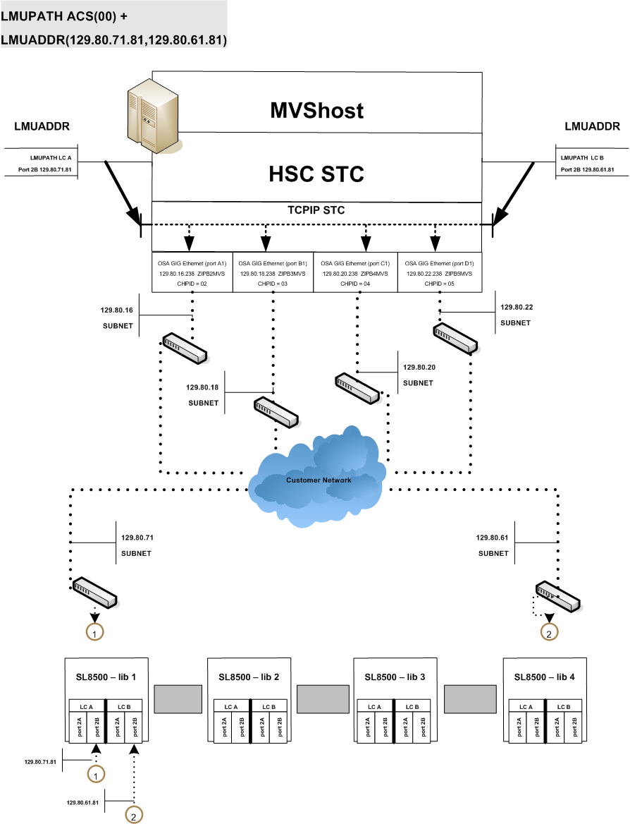

Dual Library Controller Configuration
For this implementation, a dual LC configuration is one pair of LCs installed and network connected to one library in a string. This is the only valid configuration. Figure 3-1 shows an example of this configuration.
Figure 3-1 Dual LC Configuration
Description of Figure 3-1 follows
Description of ''Figure 3-1 Dual LC Configuration''
The following rules apply to a dual LC configuration. Both LCs
  • Should be connected to all hosts
  • Can be powered on at all times
  • Must be connected to both LAN 0 and LAN 1.
In the event of a failure from the active LC, an automated switch occurs and the standby assumes the active LC role. The HSC is informed and notifies the operator of the switch. Most outstanding requests are re-driven and all future library requests are sent to the newly activated LC. Once the failed LC is repaired and powered on, it assumes the standby role.
An operator SWitch command is provided for those occasions when it becomes desirable to dynamically activate a standby LC. The operator issues the Switch command, and the standby LC assumes the active LC role after instructing the former active LC to initiate a reboot. If the former active LC reboots successfully, it assumes the standby LC role.
Warnings and precautions apply to operating in a dual LC environment. See "Redundant LC Operational Overview" and become familiar with these requirements.
Network connections must be specified for both the active and standby LCs when the HSC is installed.

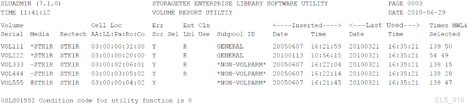

Unmatched VOLPARM and External Label Status
Sample VOLRPT control card:
VOLRPT INCLUDE(NONMEDEQ)
This request produces a report of all volumes for which the media label on the cartridge does not match the VOLPARM media type.
The character preceding the Media indicates the type of mismatch detected. The character '*' means that the label did not match the VOLPARM media code. The character '-' means that there was no VOLPARM matching the volume. Note that these volumes also have a scratch subpool of '*NON-VOLPARM*'. The '@' character means that the volume had no physical media label.
Sample output of this command is shown in Figure 3-2.
Figure 3-2 Volume Report (Unmatched VOLPARM and External Label)
Description of Figure 3-2 follows
Description of ''Figure 3-2 Volume Report (Unmatched VOLPARM and External Label)''

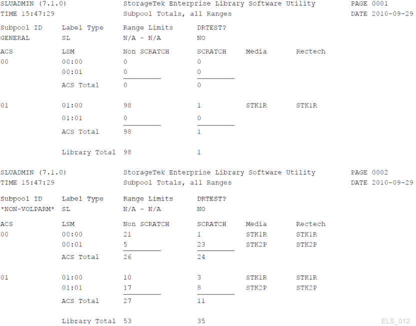

Managing Scratch Subpools
You can obtain a report showing subpool totals by subpool, library location, and media type without listing individual volumes by running the command:
VOLRPT SUMM(SUBPOOL) NOVOL
Sample output of this command is shown in Figure 3-3.
Figure 3-3 Volume Report (Scratch Subpools)
Description of Figure 3-3 follows
Description of ''Figure 3-3 Volume Report (Scratch Subpools)''

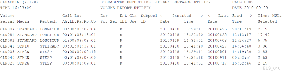

Using a VOLRPT to Track Cleaning Cartridge Usage
You can produce a report containing only cleaning cartridges, sorted by use count, using the following:
VOLRPT VOL(CLN%%%) SORT(USE) DESCEND
Sample output is shown in Figure 3-4.
Figure 3-4 Volume Report (Cleaning Cartridges)
Description of Figure 3-4 follows
Description of ''Figure 3-4 Volume Report (Cleaning Cartridges)''
The clean use count is actually the field labeled "Times Selected" at the far right. The field labeled "Cln Use" in the middle of the report indicates Y when a cleaner is overuse.
