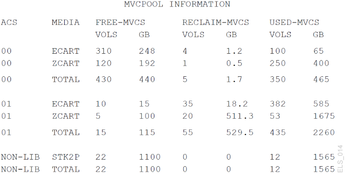

Next, see how your MVCs are doing with a Display MVCPool command.
Figure 4-1 shows an example of Display MVCPool output with no MVC pool name specified, so you see information for all your system's MVCs.
Figure 4-1 Example output from Display MVCPool (no pool name specified)
Figure 4-1 shows that your MVC collection is in good condition. There appear to be plenty of Free MVCs (100% usable space, no migrated VTVs) and plenty of free space across multiple ACSs and MVC media types. Numbers for MVCs eligible for reclaim are relatively low, meaning that automatic space reclamation probably does not get in the way of migrate/recall activity.
Used MVCs look all right in proportion to Free MVCs, except maybe in ACS 01, ECART and ZCART media. For these MVCs, you might want to do some investigation. Find out which Storage Classes represent these MVCs, which Management Classes correspond to these Storage Classes, maybe scratch some VTVs by Management Class.

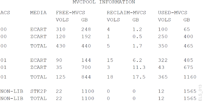

What if Display MVCPool showed you something like Figure 4-2?
Figure 4-2 Example output from Display MVCPool - Problem in ACS01
As you can see, things have gotten worse in ACS 01. What do you do now? Consider the following, probably in this order:
Do demand reclamation to free space; for more information, see "Doing Demand MVC Space Reclamations."
Add MVCs as described in "Changing RTD Device Types."
As a follow-up, review your current policies and adjust as needed. You may be able to create free MVCs or free space on MVCs by changing these policies.

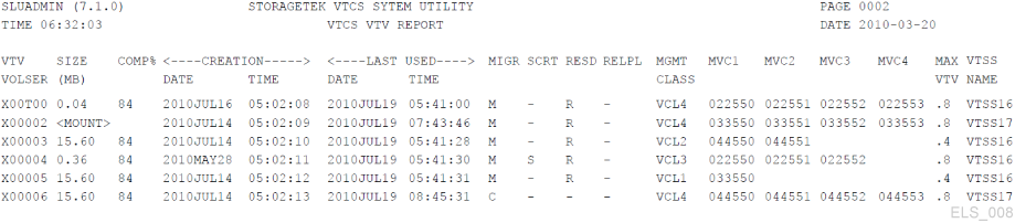

The VTV report is run using one of the following commands:VTVRPT BASIC, which shows all VTV copies migrated to MVCs using the EXPORT command
VTVRPT COPIES, which shows all VTV copies migrated to MVCs using the EXPORT command, and, additionally, all VTV copies migrated with the EEXPORT command
Start with a VTV Report, which looks like Figure 4-3.
At first glance, the VTV Report looks overwhelming and non-intuitive, a lot lines of data each describing everything you ever wanted to know about each and every VTV in your system.
What are some ways you can make a VTV Report more useful to your situation? To start with, you can run the VTVRPT utility against a list of volsers, a volser range, or even an individual volser. If you have specific VTVs in mind that you want to examine, use one of these selection options.

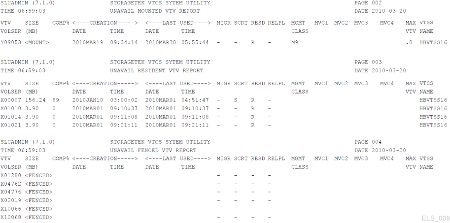

Second, the VTVRPT utility also provides the OPTION(UNAVAIL) parameter, which produces a report on unavailable VTVs that looks like Figure 4-4.
Figure 4-4 Example output from VTVRPT (UNAVAIL option)
Obviously, OPTION(UNAVAIL) is the best option if you have had any reports of jobs (or VTCS) that are unable to access VTVs you thought were resident.

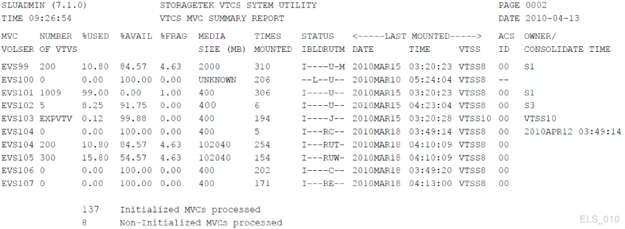

Finally, look at an MVC Summary Report, which looks like Figure 4-5.
The MVC Summary Report is a lot like the stock VTV Report; nice, if you know what you are looking for, but perhaps too much information otherwise.

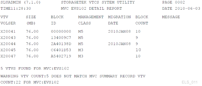

The additional fields you get from an MVC Detailed Report may be more useful for a better picture. See Figure 4-6.
Figure 4-6 Example MVC detailed report (additional fields)
Here is some detailed information about the VTVs on an MVC that you can do some diagnostic work with, if necessary.
Just as is now available with the VTV Report, you can also do either of the following with the MVC Report:
Generate output in either Structured XML or Comma Separated Variables (CSV) XML as described in ELS Programming Reference.
Use the corresponding LCM reports, as described in "LCM Control Statements."
