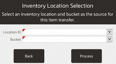

Select the location from which the item will be transferred:
Figure 45-3 Inventory Location Selection - From Location
Description of Figure 45-3 follows
Description of ''Figure 45-3 Inventory Location Selection - From Location''
  1. Select the source location for the item.
  2. Select the source bucket for the item.
  3. Select Process.

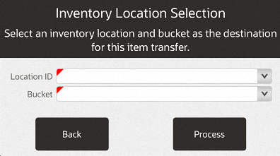

    Select the location to which the item will be transferred:
    Figure 45-4 Inventory Location Selection - To Location
    Description of Figure 45-4 follows
    Description of ''Figure 45-4 Inventory Location Selection - To Location''
  4. Select the destination location for the item.
  5. Select the destination bucket for the item.
  6. Select Process.

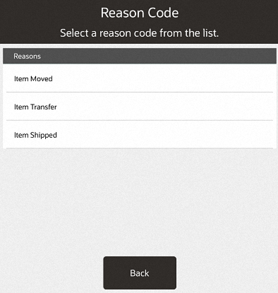

    Figure 45-5 List of Reason Codes
    Description of Figure 45-5 follows
    Description of ''Figure 45-5 List of Reason Codes''
  7. Select the reason for the transfer.

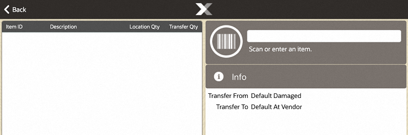

  8. Scan an item or enter an item ID.

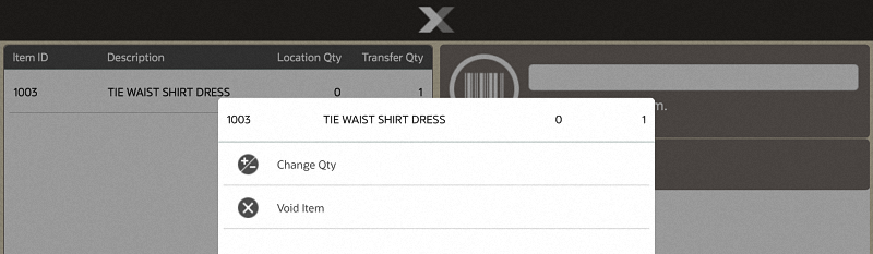

This section describes how to adjust an item. Select an item to open the Options menu.
Figure 45-8 Item Transfer Options Menu
Two options are available:

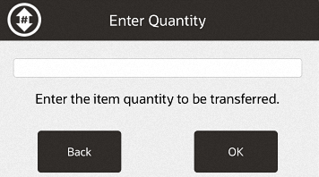

Change Item Quantity
To change the quantity of an item:
  1. Select the item.
  2. Select Change Qty from the Options menu.
  3. Enter the quantity.
  4. Select OK.
    The quantity is updated.
    Return to the transfer item list screen.
Void Item
To remove an item from an item transfer:
  1. Select the item.
  2. Select Void Item from the Options menu.
    The quantity is set to zero.
    Note that the item is still listed, only the quantity is changed to zero.

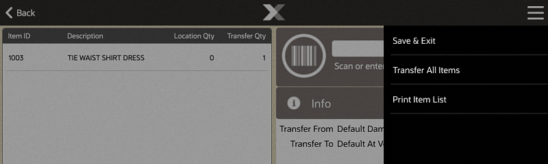

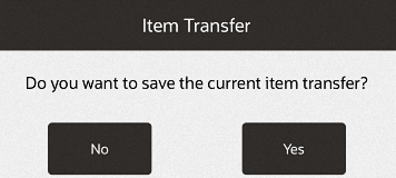

Save & Exit
To save the transfer and return to the inventory screen:
  1. Select the Context Menu button.
  2. Select Save & Exit.
    Figure 45-10 Confirm Save Transfer
    Description of Figure 45-10 follows
    Description of ''Figure 45-10 Confirm Save Transfer''
  3. Select Yes.
    The item transfer completes. Return to the inventory menu.
Transfer All Items
To include all the items in the list, setting each item to the maximum quantity:
  2. Select Transfer All.

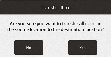

    Figure 45-11 Confirm Transfer All Items
    Description of Figure 45-11 follows
    Description of ''Figure 45-11 Confirm Transfer All Items''
  3. Select Yes.
    The quantity of every item in the list is set to its maximum value.
    Return to the item transfer list screen.
Print Item List
To print a list of items in the transfer:
  2. Select Print Item List.
    Follow the print procedure for your system.
    The list of items prints.
