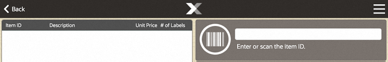

When prompted scan the barcode or manually enter the item ID.
Note: If you are using ZPL II communication with a label printer, the Retrieve Batch option is available if you previously defined and saved a named print batch. SeeTo Retrieve a Batch - ZPL II Only. |
When prompted for the number of labels you want to print for this item, type the quantity and press OK.

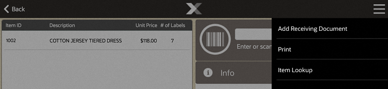

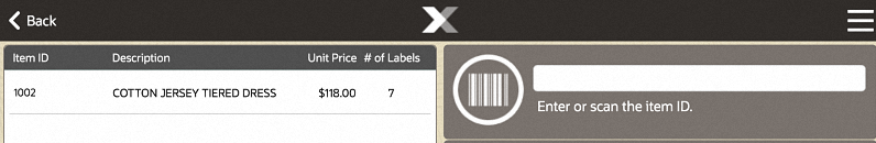

Xstore Mobile adds each Item ID and number of labels to the View Port area of the screen. The item description and unit price are also shown.
Figure 47-5 View Port Displays Items Added for Labels

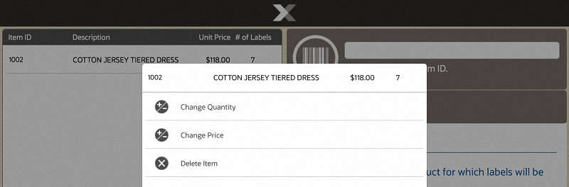

Select a row to bring up options available To Change an Item.
Change Quantity - to change the label quantity
Change Price - to change the item label price
Delete Item - to remove an item from the list
Select the Context Menu to:
Add Receiving Document - To add items from a receiving document, see To Add a Receiving Document.
Item Lookup - To search for an item to add to the list, see To Look Up an Item.
When you have entered and/or edited all the items and label quantities, select the Print option to continue with label setup.

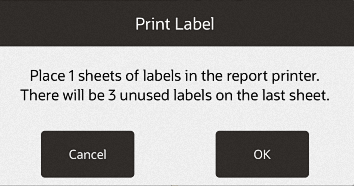

Xstore Mobile shows the number of label sheets you need. When prompted, press OK to acknowledge the message informing you of the number of label sheets required.
Xstore Mobile confirms the request and prints the labels.

Select the item to edit it. The following options are available from the Change Item menu before you print labels for the items.

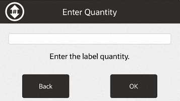

Select Change Quantity to change the number of labels to be printed.
Select the item.
At the Enter Quantity prompt (see Figure 47-4), enter the number of labels you want to print for the item.
Xstore Mobile updates the label quantity on the View Port for the item.

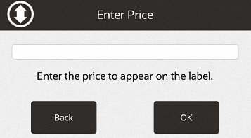

Select Change Price to change the price that is printed on the label.
Select the item.
At the Enter Price prompt, enter the price of the item to be printed on the label.
Xstore Mobile updates the label unit price on the View Port for the item.

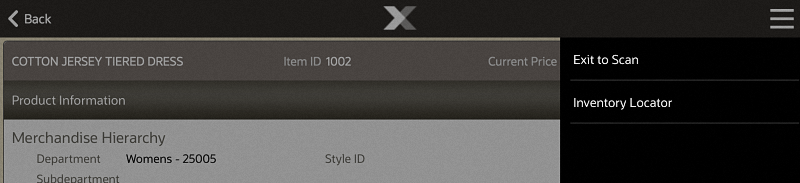

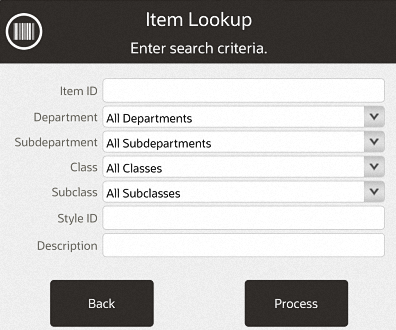

Select Item Lookup from the Context Menu to find an item using the item lookup search criteria form. The item can be added to the list of item labels to be printed.
At the Item Lookup form, enter the search criteria and select Process.
If more than one item matched the search criteria you entered, select the item from the list and OK. Xstore Mobile displays the item information.
Select the Add Item option from the Context Menu to include the item on the list of item labels to be printed. If configured, select Exit to Scan to scan the item to add it.
Figure 47-14 Item Lookup Results - Exit to Scan Option
Enter the number of labels to be printed for the item and press OK to add the item to the list of item labels to be printed. By default, the on hand quantity for the item is shown in the Label Quantity focus bar prompt.

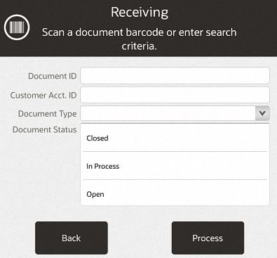

Select Add Receiving Document from the Context Menu to print labels for all of the items on a receiving document.
At the Document Search form, scan the barcode for the Receiving Document or enter search criteria to locate the Receiving Document.

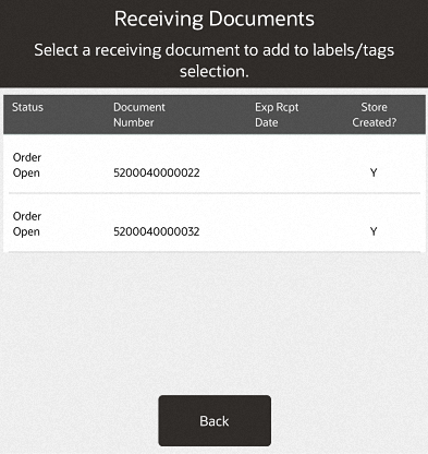

Xstore Mobile displays a list of receiving documents that match the criteria you entered. You may need to scroll through the list if multiple documents are displayed.
Figure 47-16 List of Receiving Documents
Select the receiving document that has the items that need labels. Xstore Mobile adds all of the items on the Receiving Document to the list of item labels to be printed, and displays them in the View Port area of the screen.
