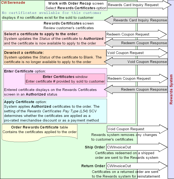

• Applying Rewards Certificates to an Order
• Rewards Certificates as Payment
• Rewards Certificates as Pro-Rated Merchandise Discount
• Redeeming and Refunding Rewards Certificates
• Rewards Certificates Screen
• Enter Certificate Number Window

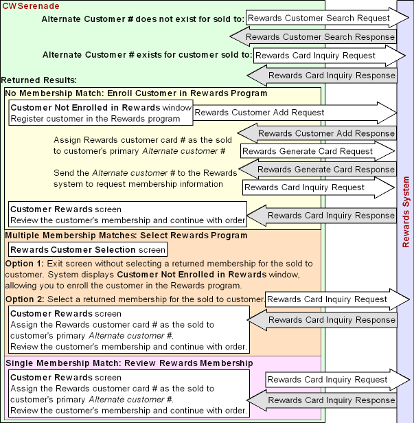

Rewards Membership Processing
If the Use Rewards Integration (K86) system control value is selected, the system performs Rewards membership processing during interactive order entry.
When you select OK on the Work with Order Screen to advance to the Work with Order Lines screen, the system sends customer information to the Rewards system if the customer’s class is not excluded from participating in the Rewards program.
The information sent is based on whether a Rewards membership card number (defined in the Alternate customer number field) is defined for the sold to customer on the order. See:
• If a Rewards Membership Card Number is Not Defined for the Sold To Customer
• If a Rewards Membership Card Number is Defined for the Sold To Customer
Address standardization: If you use the QAS Address Interface to validate and update the sold to customer address against national postal authorities, the system performs Rewards membership processing after the address has been cleansed. See Using the QAS Address Interface for more information.
Display Duplicate Sold To window: The system displays this window if the sold to customer’s name and address matches another customer on the system. If a duplicate exists, the system displays this window before performing Rewards membership processing. See the Display Duplicate Sold To Window for more information.
Communication failure: If communication between CWSerenade and the Rewards system fails, the system displays an error message: Unable to connect to Rewards System. In this situation, you will not be able to enroll customers in the Rewards program, review existing Rewards memberships, or apply Rewards certificates to an order.
Rewards membership processing for web orders: If a customer enrolls in the Rewards membership program over the web storefront, you can send the customer’s Rewards membership card number in the alternate_sold_to_id attribute in the Inbound Order XML Message (CWORDERIN). The system updates the CST Interface cust code field in the Customer Sold To table with the Rewards membership card number. You can review the Rewards membership card number in the Alternate customer number field on the second Change Customer Sold To screen in Work with Customers (WCST). See Rewards Membership Processing on Web Orders for more information.
Rewards Membership Processing during Interactive Order Entry:
If a Rewards membership card number (in the Alternate customer number field) is not defined for the sold to customer on the order, the system sends a Rewards Customer Search Request to the Rewards system.
The Rewards system uses the customer information in the Rewards Customer Search Request to determine if a membership account already exists for the sold to customer.
Once the customer search completes, the Rewards system returns a Rewards Customer Search Response to CWSerenade, indicating if a customer match was found.
• No match to sold to customer: If the Rewards system did not find a match to the sold to customer information, the system allows you to enroll the customer in the Rewards program; see Enrolling a Sold To Customer in the Rewards Membership Program.
• Multiple matches to sold to customer: If the Rewards system finds more than one match to the sold to customer information, the system allows you to select which membership program represents the sold to customer; see Selecting a Rewards Membership Program.
• Single match to sold to customer: If the Rewards system finds a single match to the sold to customer information, the system allows you to review the customer’s membership information; see Reviewing a Customer’s Rewards Membership.
If a Rewards membership card number (in the Alternate customer number field) is defined for the sold to customer, the system sends a Rewards Card Inquiry Request to the Rewards system to request the details of the Rewards membership.
The Rewards system uses the Rewards membership card number in the Rewards Card Inquiry Request to retrieve the membership account and returns the Rewards Card Inquiry Response to CWSerenade.
• No match to sold to customer: If the Rewards system did not find a match to the Rewards membership card number, the system allows you to enroll the customer in the Rewards program; see Enrolling a Sold To Customer in the Rewards Membership Program.
• Multiple matches to sold to customer: If the Rewards system finds more than one match to the Rewards membership card number, the system allows you to select which membership program represents the sold to customer; see Selecting a Rewards Membership Program.
• Single match to sold to customer: If the Rewards system finds a single match to the Rewards membership card number, the system allows you to review the customer’s membership information; see Reviewing a Customer’s Rewards Membership.
If the Rewards system did not find a match to the sold to customer, the system displays the Customer Not Enrolled in Rewards Window, allowing you to enroll the customer into the Rewards program.
To enroll the sold to customer in the Rewards program, select the Register for Rewards option on the Customer Not Enrolled in Rewards window and select OK.
When you select OK on this window, the system:
• Sends the Rewards Customer Add Request to the Rewards system. The Rewards system uses the customer information in the Customer Add Request to enroll the customer in the membership program and returns a Rewards Customer Add Response to CWSerenade, containing the customer’s membership ID number.
• Once CWSerenade receives the Rewards Customer Add Response, the system immediately sends the Rewards Generate Card Request to the Rewards system. The Rewards system uses the membership ID number in this message to create a membership card for the new membership ID and returns the Rewards Generate Card Response to CWSerenade, containing the customer’s membership card number.
• CWSerenade updates the Sold To Customer’s Alternate Customer Number with the Rewards membership card number and displays the Customer Rewards Screen, containing the customer’s Rewards membership information.
Charging for a Rewards membership: If you wish to charge a customer to join, renew, or upgrade to a Rewards membership program, create a Rewards Membership Item that represents the membership fee. Make sure that you create the item as a non-inventory item. CWSerenade sends this item to the Rewards system in the Invoice Download XML Message (CWInvoiceOut) so that the Rewards system will know that the customer has been charged for the membership and to update the customer’s membership information.
If the Rewards system found more than one match to the sold to customer, the system displays the Rewards Customer Selection Screen, allowing you to review the Rewards customer memberships that match the sold to customer information.
• If you select a customer membership on this screen, the system:
• Sends a Rewards Card Inquiry Request to the Rewards system to request the details of the Rewards membership. The Rewards system retrieves the membership information and returns the Rewards Card Inquiry Response to CWSerenade.
• CWSerenade updates the Sold To Customer’s Alternate Customer Number with the Rewards membership card number returned and displays the Customer Rewards Screen, containing the customer’s Rewards membership information.
• If you exit this screen without selecting a customer membership, the system displays the Customer Not Enrolled in Rewards Window, allowing you to enroll the customer into the Rewards program. See Enrolling a Sold To Customer in the Rewards Membership Program.

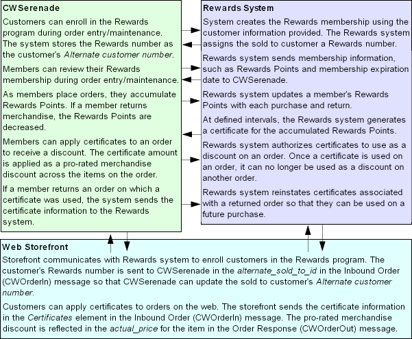

If a customer enrolls in the Rewards customer membership program over the web storefront, you can send the customer’s Rewards membership card number in the alternate_sold_to_id attribute in the Inbound Order XML Message (CWORDERIN). The system updates the CST Interface cust code field in the Customer Sold To table with the Rewards membership card number. You can review the Rewards membership card number in the Alternate customer number field on the second Change Customer Sold To screen in Work with Customers (WCST).
Note: If you send the Rewards membership card number in the alternate_sold_to_id attribute in the Inbound Order XML Message (CWORDERIN) and do not also define a valid customer_number in the message, the system uses the alternate_sold_to_id to select a sold to customer for the order; see Customer Creation, Matching and Update Logic in the Order API.
Generic customer API: You can also assign a Rewards membership card number to a sold to customer using the cst_interface_cust_nbr attribute in the Inbound Customer Message (CWCustomerIn). See Generic Customer API for an overview and required setup.
Charging for a Rewards membership: If you wish to charge a customer to join, renew, or upgrade to a Rewards membership program, create an item that represents the membership fee. Make sure that you create the item as a non-inventory item. You can include this item in the Inbound Order XML Message (CWORDERIN) in order to charge the customer for the membership. CWSerenade sends this item to the Rewards system in the Invoice Download XML Message (CWInvoiceOut) so that the Rewards system will know that the customer has been charged for the membership and to update the customer’s membership information.

Use this information to determine which membership to apply to the sold to customer.
Last name: Alphanumeric, 25 positions; display-only.
First name: Alphanumeric, 15 positions; display-only.
Middle initial: Alphanumeric, 1 position; display-only.
Address
Rewards customer address
The Rewards customer address, including:
• Street address
• City
• Postal Code
• State
Street address: Alphanumeric, 32 positions; display-only.
City: Alphanumeric, 25 positions; display-only.
Zip: Alphanumeric, 10 positions; display-only.
State: Alphanumeric, 2 positions; display-only.
Screen Option
Procedure
Select a Rewards membership for the sold to customer
Select the Rewards number field for the Rewards membership you wish to apply to the sold to customer. See Selecting a Rewards Membership Program for more information on the processing that takes place.
Exit the screen without selecting a Rewards membership for the sold to customer
Select Exit. The system advances you to the Customer Not Enrolled in Rewards Window where you can select to enroll the sold to customer in the Rewards membership program. See Enrolling a Sold To Customer in the Rewards Membership Program.
Purpose: Use this screen to review a customer’s Rewards membership information, such as the Rewards membership card number, reward points accumulated, the type of membership, and the membership expiration date.
How to display this screen: The system automatically displays this screen when you send sold to customer information to the Rewards system and the system finds a single Rewards customer membership for the sold to customer. See Rewards Membership Processing.
Field
Description
Customer #
The sold to customer number assigned to the customer.
The last name, first name, and middle initial of the sold to customer displays to the right of the customer number.
Sold to number: Numeric, 9 positions; display-only.
Rewards #
The Rewards membership card number assigned to the customer.
The system updates the CST Interface cust code field in the Customer Sold To table with the rewards membership card number. You can review the rewards membership card number in the Alternate customer number field on the second Change Customer Sold To screen in Work with Customers (WCST).
Points
The number of points accumulated by the customer.
Customers accrue reward points for each purchase they make. Once a customer has accumulated a certain amount of points, a rewards certificate is generated for the customer that can be applied to a future order in order to receive a discount.
Type
The type of Rewards membership in which the customer is enrolled. The type of membership determines the types of discounts the customer receives.
Expiration Date
The date the Rewards membership expires. Once this date is reached, the customer will need to re-enroll in the membership program. The customer also has the option to renew a membership.
Number of Days to Expiration
The number of days remaining before the customer’s Rewards membership expires.
Rewards certificates are coupons that a customer that is enrolled in the Rewards membership program can apply to an order as a pro-rated merchandise discount.
Apply certificates to an order as a discount or pay type? The setting of the Rewards Certificates Pay Type (L54) system control value defines how the system applies Rewards Certificates to an order.
• If this system control value contains a valid credit card pay type, the system applies rewards certificates to an order as a payment method; see Rewards Certificates as Payment.
• If this system control value is blank, the system applies selected Rewards Certificates to the order as a pro-rated merchandise discount during order repricing; see Rewards Certificates as Pro-Rated Merchandise Discount.

Reviewing a customer’s certificates: You can review the Rewards certificates associated with a customer by selecting the Rewards Certificate option on the Work with Order/Recap Screen or Enter Payment Method Screen.
When you select this option:
• The system sends a Rewards Card Inquiry Request to the Rewards system.
• The Rewards system returns the Rewards Card Inquiry Response to CWSerenade, containing the certificates for the sold to customer.
CWSerenade displays the Rewards Certificates Screen containing the certificates for the sold to customer.

Reviewing a customer’s certificates: You can review the Rewards certificates associated with a customer by selecting the Rewards Certificate option on the Work with Order/Recap Screen.
Redeeming Rewards Certificates
The system includes the certificates that have been redeemed against an order in the Invoice Download XML Message (CWInvoiceOut). When the Rewards system receives the CWInvoiceOut message, the system updates the status of the certificate to Redeemed so that the customer cannot reuse the certificate against another purchase.
For shipments, the system includes certificates that are in an A (Authorized) status in the Order Rewards Certificate table. Once the shipment has been billed, the system updates the certificate’s status to S (Shipped).
Note: CWSerenade includes the redeemed certificate information in the CWInvoiceOut message generated for the first shipment for the order. The system does not send redeemed certificate information in subsequent shipments for the order.
Relate Rewards integration: Redeeming certificates is not currently implemented with the Relate Rewards integration.
When you fully return an order, the system includes the certificates that have been applied against the order in the Invoice Download XML Message (CWInvoiceOut) that is generated for the credit invoice.
For returns, the system includes certificates that are in an S (Shipped) status in the Order Rewards Certificate table. Once the credit has been billed, the system updates the certificate’s status to R (Returned).
Note: If you apply Rewards Certificates to an order as a payment, regardless of whether you define an alternate pay type for the Rewards Certificates Pay Type (L54), the system includes the Rewards Certificate pay type in the Invoice Download message. To exclude the Rewards Certificate pay type from the message, you can manually deactivate the pay type on the order before generating the refund.
Determining when an order is fully returned: The system uses the following calculation to determine when an order is fully returned in order to include the certificate information in the Invoice Download XML Message (CWInvoiceOut):
If Total discountable units ordered - Total discountable units returned, cancelled, and soldout = 0, then include the certificate information for the order that is in a shipped status in the CWInvoiceOut message.
The Rewards system uses this information to refund the certificate or apply the appropriate reward points to the customer’s membership account.
Note: If the order is partially returned, the system does not include the certificate information in the CWInvoiceOut message for the credit invoice.
Purpose: Use this screen to review the Rewards certificates associated with the sold to customer on the order.
The sold to customer has the option of selecting a Rewards certificate to apply to the order as a pro-rated merchandise discount. In addition, if a certificate that the customer owns is not listed on this screen, you can add the certificate to the screen.
How to display this screen: Select Rewards Certificates at the:
• Work with Order/Recap Screen. This option is available only if the Use Rewards Integration (K86) system control value is selected and the customer’s class is not excluded from participating in the Rewards program.
• Enter Payment Method Screen. This option is available only if the Rewards Certificates Pay Type (L54) system control value contains a valid pay type and the customer’s class is not excluded from participating in the Rewards program.
When you select the Rewards Certificates option, the system includes the sold to customer’s information, including the customer’s primary alternate customer number, in the Rewards Card Inquiry Request sent to the Rewards system. The Rewards system uses this information to retrieve the customer’s membership account and send the certificates for that account back to CWSerenade in the Rewards Card Inquiry Response.
Which certificates display? The Rewards Certificate screen displays certificates that are available to apply to the order as a discount. The status of the certificate indicates which certificates will apply to the order as a pro-rated merchandise discount.
• Blank = The certificate will not apply to the order. You must select a certificate in order to send a Rewards Redeem Coupon Request to the Rewards system to approve the certificate before you can apply it to the order.
• Authorized = The certificate has been authorized by the Rewards system and is eligible to apply to the order. The system updates the status of the certificate to Authorized when it receives an approval in the Rewards Redeem Coupon Response from the Rewards system.
• Declined = The certificate has been declined by the Rewards system and is not eligible to apply to the order. The system updates the status of the certificate to Declined when it receives a decline in the Rewards Redeem Coupon Response from the Rewards system. Note: The next time you advance to this screen, the status of the certificate updates to Blank, allowing you to select the certificate again to resend to the Rewards system for approval.
• If you deselect a certificate so that it will no longer apply to the order, the system sends a Rewards Void Coupon Request to the Rewards system in order to update the status of the certificate to unauthorized.
• Certificates that are fully redeemed do not display on this screen since there is no value remaining on the certificate to apply to the order as a discount.
• If you Apply a certificate to the order, exit the screen to review the order, and then return to this screen, the system continues to display the applied certificates on the screen. The status of the certificate is Authorized and its value displays in the Select Total field.
• If you use the Enter Certificate Number Window to add a certificate to the screen, but do not Apply it to the order before exiting the screen, the system does not retain the entered certificate when you return to the screen. You will need to use the Enter Certificate Number window again to add the certificate to the screen.
For more information: See Applying Rewards Certificates to an Order for an overview.
If no certificates exist for the customer: The message No certificates available for this customer displays if a Rewards certificate does not exist for the sold to customer in the Rewards membership program or if the sold to customer is not enrolled in the Rewards membership program.
Communication failure: The message Unable to connect to Rewards system displays if the system could not connect to the Rewards system to retrieve certificate information for the sold to customer.
Certificates display on this screen in ascending value, expiration date sequence.

Select
Defines whether the certificate is selected to apply to the order.
Valid values:
• Selected = When you select Apply Certificates, the system sends a Rewards Redeem Coupon Request to the Rewards system.The Rewards system returns the Rewards Redeem Coupon Response indicating whether the certificate was authorized. If the certificate was authorized, the system updates the Status of the certificate to Authorized on the Rewards Certificates screen. You can apply this certificate to the order as a pro-rated merchandise discount.If the certificate was not authorized, the system does not update the status of the certificate and it is not available to apply to the order as a discount.
• Unselected = The dollar value of the certificate will not be applied to this order and will remain available for future purchases.
Certificate #
The certificate number available to use by the customer as a pro-rated merchandise discount on the order.
Numeric, 40 positions; display-only.
Value
The dollar value of the certificate.
Numeric, 7 positions with a 2-place decimal; display-only.
Status
Indicates if the certificate has been authorized by the Rewards system to apply as a pro-rated merchandise discount to the order.
Valid values:
• Authorized = The certificate has been authorized by the Rewards system and is eligible to apply to the order as a pro-rated merchandise discount.
• Declined = The certificate has been declined by the Rewards system and is not eligible to apply to the order as a pro-rated merchandise discount.
Expiration Date
The date the certificate expires.
Numeric, 8 positions (MM/DD/YYYY format); display-only.
Screen Option
Procedure
Select a Rewards certificate to apply to the order
Select the Select checkbox for a certificate and select Select.
When you select a certificate, the system sends a Rewards Redeem Coupon Request to the Rewards system.
If the certificate was authorized, the system updates the Status of the certificate to Authorized on the Rewards Certificates screen. You can apply this certificate to the order.
If the certificate was not authorized, the system does not update the status of the certificate and it is not available to apply to the order.
If you reject an order with an applied certificate: If you reject an order that has an applied certificate discount, the system sends a Rewards Void Coupon Request to the Rewards system indicating the certificate has not been redeemed by the customer.
Unselect a Rewards certificate that has been authorized for use
Select the Select checkbox for a certificate whose Status is Authorized and select Deselect.
The system sends a Rewards Void Coupon Request to the Rewards system and updates the Status of the certificate to blank. The system also removes the associated record from the Order Rewards Certificate table.
An error message displays if you select Deselect for a certificate that is not in an Authorized status: Certificate not yet authorized.
Relate Rewards integration: Voiding certificates is not currently implemented with the Relate Rewards integration.
Add a new certificate to the Rewards Certificates screen, provided by the sold to customer
Select Enter Certificate to advance to the Enter Certificate Number Window.
Apply the Authorized certificates to the order
Select Apply Certificates.
The system applies the certificates (the dollar value in the Select Total field) to the order. The setting of the Rewards Certificates Pay Type (L54) system control value defines whether the system applies the certificates to the order as a credit card pay type or as a prorated merchandise discount. CWSerenade stores the applied certificate number and Authorized TransactionID from the Rewards system in the Order Rewards Certificate table. If a valid pay type is defined in the Rewards Certificates Pay Type (L54) system control value, the system also creates a record in the Order Payment Method table for each certificate applied to the order as a credit card pay type. See Applying Rewards Certificates to an Order for processing details.
Note: If you apply a certificate whose amount is greater than the order total, the Rewards system does not keep the remaining balance of the certificate available to use on another purchase; once you use a certificate as a discount on an order, the entire amount is reduced to zero.

Rewards Messages
CWSerenade uses the following messages to communicate with the Rewards system.
• Rewards Customer Search Request
• Rewards Customer Search Response
• Rewards Customer Add Request
• Rewards Customer Add Response
• Rewards Generate Card Request
• Rewards Generate Card Response
• Rewards Card Inquiry Request
• Rewards Card Inquiry Response
• Rewards Redeem Coupon Request
• Rewards Redeem Coupon Response
• Rewards Void Coupon Request
• Rewards Void Coupon Response
Reviewing messages for the Rewards integration: You can review the messages passed between CWSerenade and the Rewards system in the CWSerenade Trace Log if its Logging Level is set to DEBUG or ALL. Use this log to help troubleshoot the Rewards integration.
Relate message formats: CWSerenade uses the version 7.8 Relate messages to pass customer membership information between CWSerenade and the Rewards system. For a complete description and message layout of the messages used to communicate with the Rewards system, see the Relate Web Services Guide.
This message is used to send sold to customer information from CWSerenade to the Rewards system. The Rewards system uses this information to determine if the customer is already a member of the Rewards membership program.
Generated when? CWSerenade generates this message when:
• A sold to customer places an order and an Alternate customer number does not exist for the sold to customer.
• You select the Rewards Points option on the Display More Options Screen and an Alternate customer number does not exist for the sold to customer.
Information included:
• Action: Search defaults.
• Name: The sold to customer’s first name, middle initial, and last name. The Rewards system performs a "starts with" search on this information to determine if the customer is already a Rewards member. From the First name, Middle initial, and Last name fields in the Customer Sold To table.
• Address SequenceNumber: 1 defaults.
• Address ValidFlag = true defaults.
• Address TypeCode = HOME defaults.
This message is used to send the status of the membership account and the customer’s Rewards customer account number back to CWSerenade.
Generated when? The Rewards system generates this message as a response to a Rewards Customer Add Request.
• DateTime: The date and time the transaction was processed in YYYY-MM-DDTHH:MM:SS format.
• Response code:
• OK indicates the Rewards system created the membership account successfully.
• General Error indicates a communication failure occurred.
• CustomerID: The Rewards customer account number assigned to the sold to customer. Note: CWSerenade does not store the customer account number; when the Rewards system returns the Rewards Generate Card Response to CWSerenade, the system stores the Rewards membership card number in the CST Interface cust code field in the Customer Sold To table; this is the primary alternate customer number for the sold to customer.
Sample Customer Add Response:
<Customers xmlns="http://www.nrf-arts.org/IXRetail/namespace">
<DateTime>2010-04-09T11:05:12</DateTime>
<Customer ResponseCode="OK">
<CustomerID>2130</CustomerID>
</Customer>
</Customers>
This message is used to generate a Rewards membership card number for the newly created membership created for the sold to customer.
Generated when? CWSerenade generates this message when it receives the Rewards Customer Add Response from the Rewards system.
• Action: GenerateCard defaults.
• CardPrefix: 20001 defaults.
• CardSeriesSequence: 03 defaults.
• CustomerID: The newly created Rewards customer account number assigned to the sold to customer.
Sample Generate Card Request:
<CardSeriesMaintenance>
<CardSeries Action="GenerateCard">
<CardPrefix>20001</CardPrefix>
<CardSeriesSequence>03</CardSeriesSequence>
<Customer>
</Customer>
</CardSeries>
</CardSeriesMaintenance>
This message is used to request membership information for a specified Rewards membership card number.
• A sold to customer places an order and an Alternate customer number exists for the sold to customer.
• You select the Rewards Points option on the Display More Options Screen and an Alternate customer number exists for the sold to customer.
• A Rewards Generate Card Response is received from the Rewards system with a Response code of OK.
• You select a Rewards membership on the Rewards Customer Selection Screen.
• A single customer match is returned to CWSerenade in the Rewards Customer Search Response.
• You select Rewards Certificates on the Work with Order/Recap Screen.
• CardRequest Type: Inquiry defaults.
• CurrencyID: The currency code for the offer associated with the source code on the order header. From the Currency code field in the Offer table. Note: If a currency code is not defined for the offer, the system sends the currency code defined in the Local Currency Code (A55) system control value.
• CardNumber: The Rewards membership card number assigned to the sold to customer. From the CST Interface cust code field in the Customer Sold To table.
Sample Card Inquiry Request:
<CardOperation>
<CardRequest Type="Inquiry">
<CurrencyID>USD</CurrencyID>
<Instrument>
<CardNumber>195833886464934</CardNumber>
</Instrument>
</CardRequest>
</CardOperation>
This message is used to authorize a certificate for use as a discount on an order.
Generated when? CWSerenade generates this message when you:
• Select a certificate on the Rewards Certificates Screen.
• Enter a certificate number on the Enter Certificate Number Window.
• AwardRequest Type: RedeemCoupons defaults.
• Coupon ID: The certificate number to authorize for use as a discount on an order.
• Amount: The dollar amount of the certificate.
Sample Redeem Coupon Request:
<Awards>
<AwardRequest Type="RedeemCoupons">
<Instrument>
<CardNumber>998180</CardNumber>
</Instrument>
<AwardAccountID>998180</AwardAccountID>
<Coupons>
<Coupon id="1104008154">
<RequestAmount>
<Amount>10.00</Amount>
</RequestAmount>
</Coupon>
</Coupons>
</AwardRequest>
</Awards>
This message is used to notify CWSerenade whether the certificate has been approved or declined for use as a discount on an order.
Generated when? The Rewards system generates this message as a response to a Rewards Redeem Coupon Response.
• ResponseStatus:
• OK indicates the certificate has been authorized by the Rewards system.
• Rejected indicates the certificate has not been authorized by the Rewards system.
• Award Transaction ID: The certificate number to redeem on the order.
• AwardAccountID: The Rewards customer account number assigned to the sold to customer.
• Card number: The Rewards membership card number assigned to the sold to customer. Corresponds to the CST Interface cust code field in the Customer Sold To table.
• Coupon: The Rewards certificate number that has been authorized.
• Expiration date: The date the certificate expires.
• Error: Indicates the reason why the redeem coupon request was rejected.
• Account Not Found indicates a membership account was not found for the card number passed in the Rewards Redeem Coupon Request.
• Account Expired indicates the membership account has expired.
• Account Inactive indicates the membership account is inactive.
• Card Expired indicates the card number passed in the Rewards Redeem Coupon Request has expired.
• Card Inactive indicates the card number passed in the Rewards Redeem Coupon Request is inactive.
• Card Not Found indicates the card number passed in the Rewards Redeem Coupon Request was not found in the Rewards database.
• Card Number Required indicates a card number was not passed in the Rewards Redeem Coupon Request.
Sample Redeem Coupon Response:
<AwardResponse>
<ResponseStatus status="OK">
<AwardTransactionID>UA0586</AwardTransactionID>
<DateTime>2010-10-15T14:01:37</DateTime>
</ResponseStatus>
<AwardAccount>
<CouponList Type="BalanceAmounts">
<ExpirationDate>2010-11-20</ExpirationDate>
</Coupon>
</CouponList>
<CouponList Type="TransactionAmounts">
</Coupon>
</CouponList>
</AwardAccount>
</AwardResponse>
This message is used to unauthorize a certificate so that it will not be used as a discount on an order.
• You deselect a certificate on the Rewards Certificates Screen.
• You reject an order on which a certificate was applied.
• AwardRequest Type: Void defaults.
• CurrencyID: The currency code for the offer associated with the source code on the order header. From the Currency code field in the Offer table. If a currency code is not defined for the offer, the system sends the currency code defined in the Local Currency Code (A55) system control value.
• AwardTransactionID: The certificate number to unauthorize for use as a discount on an order.
