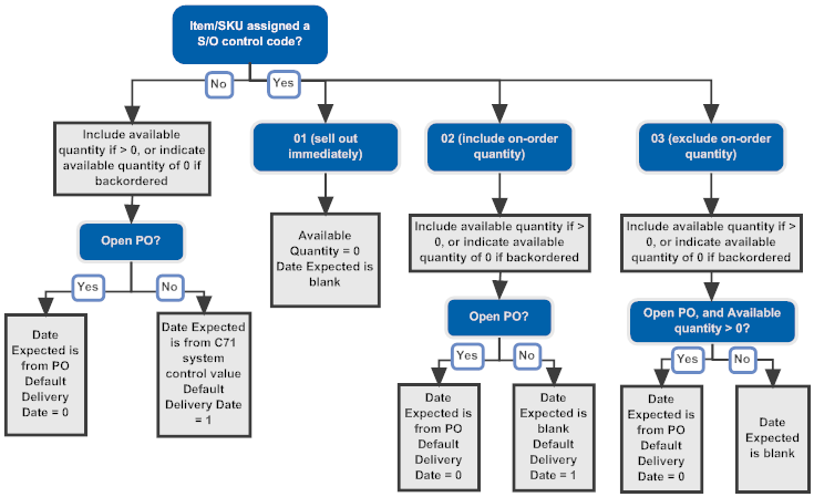

What if the item is sold out? If the item is assigned a soldout control code, the information downloaded varies depending on the soldout control code’s status. The soldout statuses and the resulting availability information included in the download are summarized in the table below:
Soldout control code
Availability download
1 = sell out immediately
Quantity available = 0
Date expected = blank
Regardless of the actual quantity of the item you have available, or whether there are any open purchase orders, you will not be selling any more units. In this case, the setting of the Default delivery date is irrelevant.
2 = include on-order quantity in the soldout calculation
Open purchase order?
• If there is an open purchase order, the information is the same as an item without a soldout control code, as described above.
• If there is not an open purchase order, the Date expected is blank and does not default from the FTC - # Of Days for Items without Expected Ship Date system control value.
3 = exclude on-order quantity in the soldout calculation
Available quantity greater than zero?
• If the current available quantity is greater than zero, that available quantity is indicated in the table, and:
• if there is an open purchase order, the Date expected is from the purchase order, and the Default delivery date is 1
• if there is not an open purchase order, the Date expected is blank, and the Default delivery date is 0
• If the current available quantity is not greater than zero, the available quantity indicated in the table is zero, and the Date expected is blank, regardless of whether there is an open purchase order. In this case, the setting of the Default delivery date is irrelevant.
