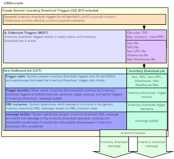

Generating the inventory download message: The Inventory Download job in Working with Integration Layer Processes (IJCT) monitors the IL Outbound Trigger table for inventory download triggers to process, and generates the Inventory Download XML Message (CWInventoryDownload) to send to the remote system(s).
Message generation options:
• Include non-allocatable warehouses? You can specify whether to download availability information for all warehouses where you keep an item/SKU, or whether to exclude warehouses flagged as non-allocatable.
• Trigger rules: You can use trigger rules to set up more specific selection criteria for items, SKU’s, warehouses, item warehouses, or UPC codes. For example, you might choose to select specific companies, or exclude non-inventory, membership, and gift certificate items.
• Threshold quantity: You can specify a threshold quantity that indicates whether to generate inventory messages whenever an item/SKU’s available quantity is below this threshold and there is any activity for the item/SKU. You can set this threshold by item/SKU and item class, and you can also set a default threshold quantity for your company.
• Purchase order activity: You can specify whether to generate a message whenever you create or change a purchase order that includes an item whose available quantity is zero or less.

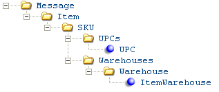

What information does the inventory download message include? The message includes information on the:
• item/SKU
• any UPC codes
• warehouse
• item warehouse (including the available quantity and other inventory levels, such as on-hand quantity)
You can use the XML inclusion rules to exclude one or more elements of the outbound message if, for example, you do not need to send UPC information to the external system(s).

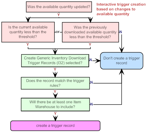

The criteria the system uses to generate triggers based on changes to availability are described below. See Creating Inventory Download Triggers through Purchase Order Creation or Maintenance for more information on when the system generates trigger records due to purchase order activity.
Availability threshold: The system generates an inventory download trigger record whenever inventory or reservation activity affects the item/SKU’s available quantity as follows:
When the available quantity is currently:
The system creates a trigger record if the available quantity:
Example:
at or above the threshold
falls below the threshold

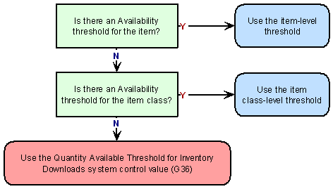

Availability threshold hierarchy: The system determines the correct availability threshold for an item/SKU using the following hierarchy:
• the Availability threshold specified for the item, if any; otherwise,
• the Availability threshold specified for the item’s item class, if any; otherwise,
• the Download Threshold Quantity (G36) system control value

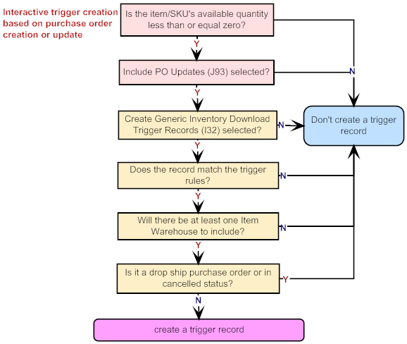

If the Create Generic Inventory Download Triggers (I32) and the Include PO Updates (J93) system control values are selected, the system creates an inventory download trigger record whenever you create or maintain a purchase order if:
• the available quantity of any item/SKU on the purchase order is zero or less, and
• there is at least one Item Warehouse for the item/SKU that is eligible for download, and
• the purchase order is not a drop ship purchase order, and
• the purchase order is not in cancelled status, and
• the item/SKU is not excluded from download based on any trigger rules.
Note: If the above assumptions are true, the system generates a trigger record whenever you maintain a purchase order, regardless of the nature of the change.

Inventory Download Processing
To generate the Inventory Download XML Message (CWInventoryDownload), the INV_DOWNLD process in Working with Integration Layer Processes (IJCT):
1. Reads through the inventory download trigger records
2. Creates a single Inventory Download XML Message (CWInventoryDownload) for each item/SKU, regardless of how many ITW trigger records in R (ready) status exist for the item/SKU

Inventory Download Trigger Rules
The options available for the inventory download at the Select Trigger Rules File Window are:

Inventory Download XML Inclusion
As with other outbound messages generated through Working with Integration Layer Processes (IJCT), you can use the Outbound Interface XML Inclusion Screen to exclude elements and their contents from the Inventory Download XML Message (CWInventoryDownload). The XML inclusion options for the inventory download are:
Item
SKU
UPC
Warehouse
ItemWarehouse
If you choose to exclude an element, all of the subordinate elements and attributes of that element are also excluded. For example, if you choose to exclude the SKU element, the message includes the Item element and attributes only, and does not include the SKU, UPC, Warehouse, or ItemWarehouse elements.
If you exclude the ItemWarehouse element, the message does not include any availability information.

Inventory Download Troubleshooting
The system might not generate the Inventory Download XML Message (CWInventoryDownload) for any of the following reasons:
• Are the trigger rules excluding companies, item/SKUs, warehouses, item warehouses, and so on? See Inventory Download Trigger Rules.
• Are the XML inclusion rules excluding essential information for the message? See Inventory Download XML Inclusion.
• Is the item warehouse flagged as having a reservation freeze? See Item Warehouses Excluded from the Inventory Download.
• Is the availability threshold for the item/SKU lower than the item/SKU’s available quantity? See Creating Inventory Download Triggers Interactively Due to Changes in Availability for more information on the threshold hierarchy.
• Is the Create Generic Inventory Download Triggers (I32) system control value selected? The system does not create any trigger records if this system control value is unselected.
• If you expected a trigger to be generated when you create or maintain a purchase order, is the Include PO Updates (J93) system control value selected and is the available quantity for the item zero or less? See Creating Inventory Download Triggers through Purchase Order Creation or Maintenance for a discussion.
• Is the item flagged with a soldout status code? The system does not create any trigger records for items that are currently sold out.
• Is the INV_DOWNLD process in Working with Integration Layer Processes (IJCT) running?
Indicates whether to generate trigger records when you create or change a purchase order that includes an item whose available quantity is zero or less. If you select this value, the system creates a trigger each time you create or change a purchase order that includes an item/SKU whose available quantity is zero or less (with the exception of drop ship purchase orders). If you unselect this value, the system does not create triggers as a result of purchase order creation or maintenance.

Quantity Available Threshold for Inventory Downloads (G36)
Indicates the default availability threshold quantity to use if there is no threshold quantity specified for the item or the item class. See Creating Inventory Download Triggers Interactively Due to Changes in Availability for more information.

Optionally, set the Available threshold at the item level as an override to the threshold set at the item class or with the Quantity Available Threshold for Inventory Downloads (G36) system control value.
Working with Item Classes (WICL)
Optionally, set the Available threshold at the item class as an override to the Quantity Available Threshold for Inventory Downloads (G36) system control value. The threshold set at the item level, if any, overrides the item class threshold.
• Attributes are included in the response only if they contain a value. Blank attributes are not passed.
• Numeric fields use implied decimals; for example, a value of $12.34 is presented as 1234.
• The XML inclusion rules control whether one or more elements are included in the message.
For more information: See Inventory Download Process for a discussion of when you might use this message.

UPC
This element is included only if the item/SKU has one or more UPC codes assigned. If the item has SKUs, you must assign UPC codes at the SKU level rather than at the item level.
See the Work with UPC Codes Screen for more information.

Warehouse
This element includes information on the warehouse itself, and is provided in the message only if there is an Item Warehouse record for the item/SKU. See Inventory Download Process for more information.
See Creating and Maintaining Warehouses (WWHS), especially the Create Warehouse Screen, for more information on the information provided in the Warehouse element.

Sample Inventory Download XML Message
<Message source="CWDirect" target="CWIntegrate" type="CWInventoryDownload" date="10082006" time="11:07:35" >
<Item company="123" company_description="Sarah`s Kitchen Shop" item_number="MELIOR" item_description="MELIOR-STYLE COFFEE MAKER" item_2nd_lang_desc="CAFETERA DEL TIPO MELIOR" item_long_sku_style="MEL456789" non_inventory="N" membership="N" drop_ship_item="N" item_status="A" item_status_description="ACTIVE" >
<SKU sku_code="LRGE" sku_description="ONE-QUART COFFEE MAKER" short_sku="81" so_control="02" so_control_description="INCLUDE ON ORDER QTY IN SOLD" so_control_status="2">
<UPCs>
<UPC upc="1234567890" upc_type="E8" upc_vendor="10002">
</UPC>
</UPCs>
<Warehouses>
<Warehouse warehouse="10" warehouse_name="MAIN WAREHOUSE" address_line_1="10 SPEEN STREET" city="FRAMINGHAM" state="MA" postal_code="01701" country="USA" drop_point="1" drop_point_description="MASS. DROPPOINT" manager="MS. HANNAH BROWN" allocatable_flag="Y"receive_restock_transfers="N" viewable_in_oe="Y" auto_restock_location="RESTOCK" retail_outlet="N">
<ItemWarehouse allocation_freeze="N" economic_order_qty="100" max_qty="99999" min_qty="10" on_hand_qty="22" reorder_qty="20" on_order_qty="10" available_qty="22" next_po_date="10152006" next_expected_qty="15" original_retail_price="2100" current_retail_price="2600" protect_current_price="N" protect_min_max="N"/>
</Warehouse>
</Warehouses>
</SKU>
</Item>
</Message>
