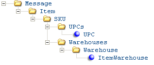

Inventory Inquiry Response XML Message (CWInventoryInquiryResponse)
The INV_INQURY process generates an XML response laid out as follows.
• Attributes are included in the response only if they contain a value. Blank attributes are not passed.
• Numeric fields use implied decimals; for example, a value of $12.34 is presented as 1234.
See Inventory Inquiry Response: Sample XML for a sample message and see Generic Inventory Inquiry API for an overview.

This element includes attributes that apply to both SKU’ed and non-SKU’ed items, so it is always included in the response. |

The UPC element is included only if the item/SKU has one or more UPC codes. See the Work with UPC Codes Screen for more information. |

The warehouse name and address information, if any, are defined in the Warehouse table; see Creating and Maintaining Warehouses (WWHS) for descriptions of this information. The system does not require you to specify address information when you create a warehouse. |
A sample of the Inventory Inquiry Response XML Message (CWInventoryInquiryResponse) is presented below.
<Message source="CWDirect" target="CWIntegrate" type="CWInventoryInquiryResponse" date="05112006" time="15:05:59" >
<Item company="5" company_description="Country Creations (Kristen QA)" item_number="KABSKU1" item_description="TWO-DRAWER FILING CABINET" non_inventory="N" membership="N" drop_ship_item="N" long_sku_department="7654" long_sku_department_desc="7654 LONG SKU DEPARTMENT" long_sku_division="765" long_sku_division_desc="765 LONG SKU DIVISION" long_sku_class="6543" long_sku_class_desc="6543 LONG SKU CLASS" >
<SKU sku_code="BLUE" sku_description="NAVY BLUE FILING CABINET" short_sku="601">
<Warehouses>
<Warehouse warehouse="1" warehouse_name="BOSTON WAREHOUSE" address_line_1="10 WALNUT STREET" city="WESTBOROUGH" state="MA" postal_code="01701" country="USA" drop_point="1" drop_point_description="DROP POINT ONE" manager="TOM DUCEY" telephone_nbr="5085550101" allocatable_flag="Y" receive_restock_transfers="Y" inventory_value_gl_nbr="87777777" viewable_in_oe="Y" retail_outlet="N">
<ItemWarehouse allocation_freeze="N" on_hand_qty="20" available_qty="20"/>
</Warehouse>
<Warehouse warehouse="10" warehouse_name="OUTLET STORE" address_line_1="100 WALNUT AVE" city="WESTBOROUGH" state="MA" country="USA" drop_point="1" drop_point_description="DROP POINT ONE" allocatable_flag="N" receive_restock_transfers="Y" inventory_value_gl_nbr="11500" viewable_in_oe="N" retail_outlet="N">
<ItemWarehouse allocation_freeze="N"/>
</Warehouse>
</Warehouses>
</SKU>
</Item>
</Message>
