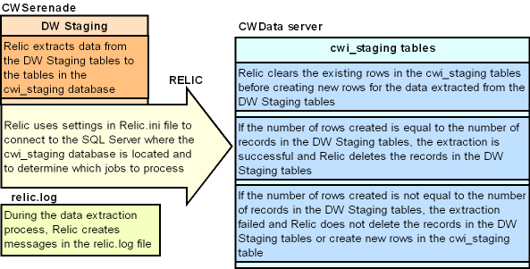

Relic downloads data from the CWSerenade DW Staging tables to the tables in the cwi_staging database on the CWData Server.

Relic performs the following steps to move data from the DW Staging tables in the CWSerenade database to the tables in the cwi_staging database.
1. Establishes a connection to the CWSerenade database.
2. Establishes a connection to the cwi_staging database.
3. Looks at the Relic Job List in the Relic.ini file to extract data from the DW Staging tables in the CWSerenade database to the tables in the cwi_staging database.
Each job in the Relic Job List indicates:
• Source table: the name of the DW Staging table in the CWSerenade database where the data to extract is located.
• Destination table: the name of the table in the cwi_staging database where the extracted data is placed.
4. Relic processes the data table by table, keeping a record count for each of the tables defined in the Relic.ini file. Relic extracts the records from the DW Staging table and inserts the data into the corresponding table in the cwi_staging database. As the data in each table is transferred, Relic clears any data that might exist in the table in the cwi_staging database. Note: Relic clears the existing records in the table in the cwi_staging database only if there are records to transfer from the corresponding DW Staging table in the CWSerenade database.
• If the number of rows created in the cwi_staging table matches the number of records extracted from the DW Staging table, Relic considers the download successful and deletes the data from the DW Staging table in the CWSerenade database, with the exception of the DW Transaction table.
• If the number of rows created in the cwi_staging table does not match the number of records extracted from the DW Staging table, Relic considers the download a failure and does not delete the data from the DW Staging table in the CWSerenade database. A discrepancy between the number of records in DW Staging and the number of new rows created in the cwi_staging table indicates that one or more records contain errors; for example, a bogus record existed in tje DW Staging table in the CWSerenade database. Relic tries to process the table one more time. If the table fails a second time, Relic creates an error message in the Relic Log.
5. Once Relic completes the download of data to the tables in the cwi_staging database, Relic starts the cwi_load stored procedure. This program starts the warehouse build to extract, translate, and load the data from the tables in the cwi_staging database to the tables in the cwi_warehouse database.
For more information: See:
• CWData Staging (cwi_staging) Tables for more information on the contents of each table in the cwi_staging database.
• SQL Server Stored Procedures Processing in the CWData Reference Guide for more information on the process used to extract data from the tables in the cwi_staging database to the tables in the cwi_warehouse database.

Purpose: Relic updates the relic.log file with the events that occurred during the extraction process. The system creates a relic.log file for each transfer of data from the DW Staging tables in the CWSerenade database to the tables in the cwi_staging database. Each log file is prefixed with the date Relic was started, for example, 2011-12-14relic.log.
You can use the relic.log file to determine if any errors occurred during the data extract process.
Location of log file: The relic log is located at: C:\Serenade\CWSerenade\CWData\relic\logs, where C: is the root drive where CWSerenade is installed.
Relic processing messages: The relic.log file contains messages such as the following for each extraction process:
